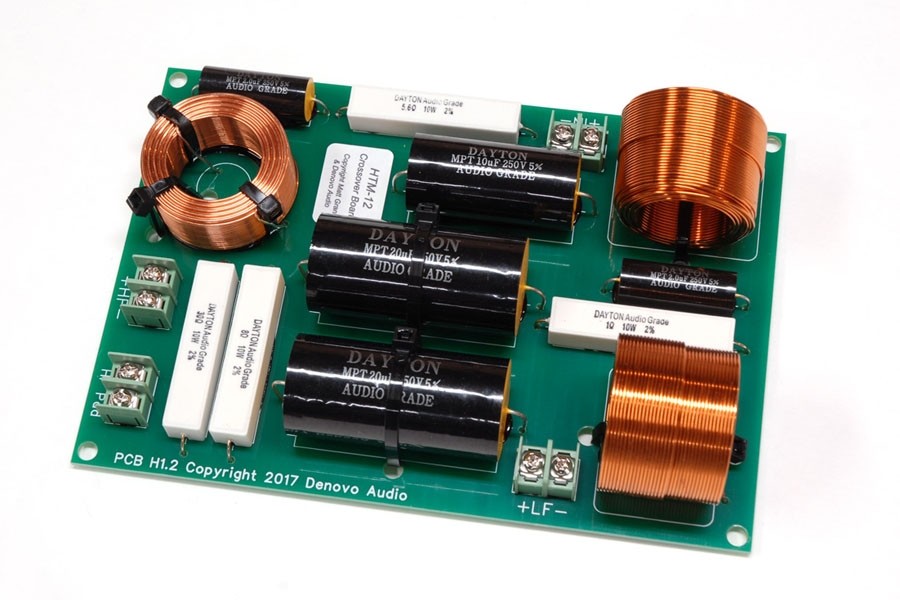

Here's a neatly done crossover from DIYSG;
attachment.php
- Note the quite sparing use of a black glue (?) or sealant (?)

Use the bare spots to glue the caps down when you use them. You will even save glue, as bare metal holds glue better than vinyl.
Inductive propagation occurs mostly at RF frequencies, but if you keep conductors from running parallel to the axis of your inductor you will minimize it.

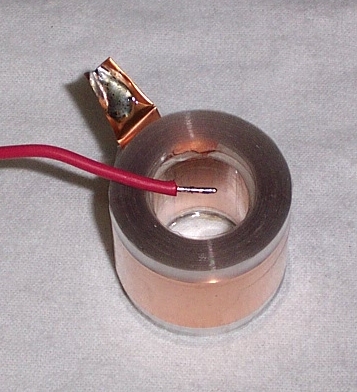

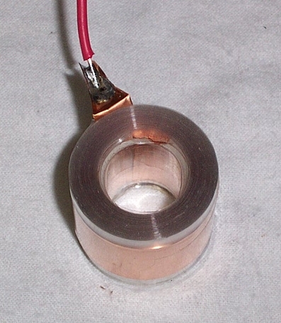

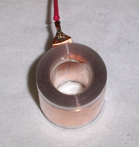

You might also use Google to get advice on how best to neatly solder those foil-type inductors such you have ( which I've never dealt with ) .
- I might be inclined to do something with that flat foil to make it into something like a normal wire ( at each end > for ease of soldering ).
Good idea! I will go to the hardware store to get some more of those connectors (or ask if dad has any spare ones).
I did some googling on how to solder foil inductors but didn't find any pictures. The pictures you posted seem to show a good way of doing it. It would mean stripping away some of that precious foil but I guess it would be so much easier to work with less foil sticking out and having a bit of cable instead. On the old crossover I just folded the foil over a component lead and used lots of solder and heat for an extremely ugly connection.

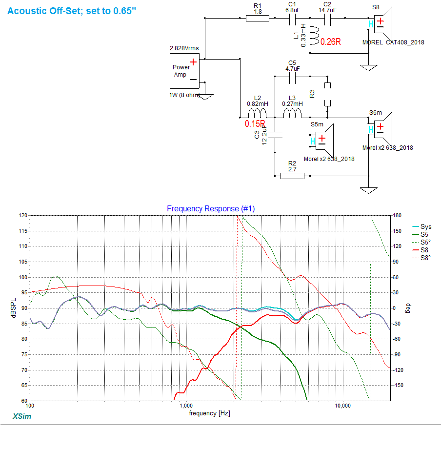

Niklas,

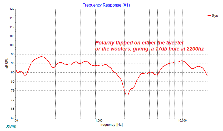

Another possible reason for "soft" HF is you might have incorrectly wired up the HF with the wrong polarity.

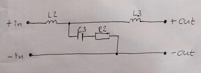

Here's the schematic ( for review ) ;
692055d1531694987-crossover-current-speakers-morel-mtm-16-51mm-png
Note that the LF + HF portions of this network are both wired with positive ( the same ) polarity .

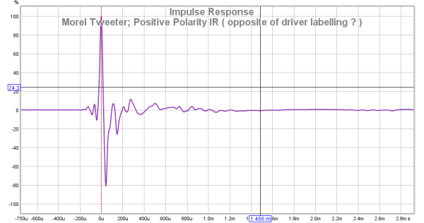

I know ( from past experience this last winter ) that you've been confused about your devices actual polarities ( and their markings ).
The best way to determine each transducers polarity is to run an appropriate bandwidth REW signal through each type and then make note ( within the IR window of REW ) if the leading peak goes positive ( or negative ).
Actually, for the woofers just take a 1.5V battery and attach its +terminal to what you think is the positive tab of the woofer ( wire, negative battery to negative woofer ). If the woofer is labelled correctly the cone will move outwards ( away from the magnet ).
You can't do the battery test with a tweeter, you need to use REW ( as mentioned above ).
Here's a pic that I made a year ago showing your tweeter's IR ( as you can see in my labeling what you indicated was negative did not agree with the electrical test ) .
650703d1513030948-crossover-current-speakers-morel-tweeter-impulse-positive-png
Unless in the past few months you have rectified this labeling confusion (on the drivers), there's a good chance you currently have the new network wired up wrong.
Some REW testing will reveal the truth.
I connected everything according to the labels, so if the tweeters are wired wrong internally or labeled wrong they should be out of phase now. It's 1am here right now so not exactly the time to do any measurements but I'll have a look at it later this week if I have time. If not I could always just switch the wires running out of the tweeter board, that's done in 30 seconds.
