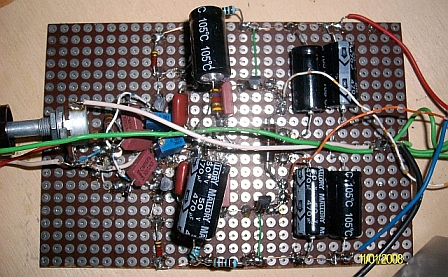

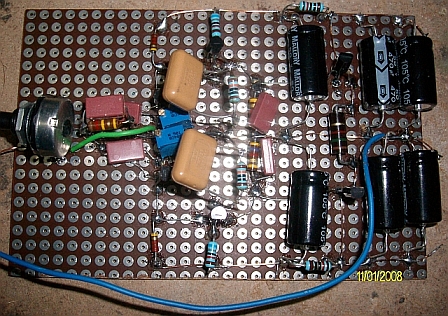

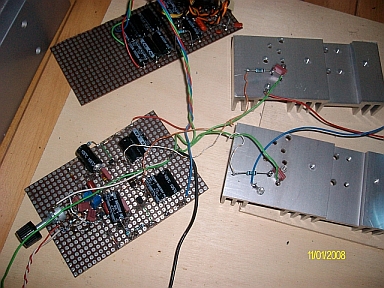

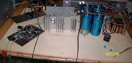

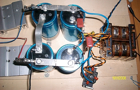

How do they sound? Do you have any pictures showing the amps? I'm curious.
Hi, at this time i have realized only a prototype.
Here the photos. Sorry, Data of photo machine isn't current time.
Francesco.

It is currently only a prototype channel.
In the past, prompt I have made the PCB, but now I devote more time to optimize the schema and components employed, helping with listening sessions, before making the printed circuit boards.
If there is sufficient demand (GB?), I can achieve and provide the amplifers PCB (ver. A, B or C) with all components and also completed with power Vfets. :)
