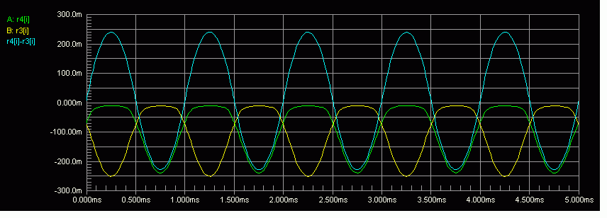

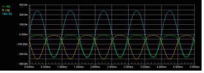

Hi Bonsai,
Please re-read my first post of this thread. This circuit is intended for class A amplifiers, with the possibility to move to class AB in case excessive currents are needed.
As long as you stay within class A limits, not only the voltage has low distrtion, but also the current in both halfs. When you move to class AB, of course the currents will tend to bend towards half wave rectified shapes. But you should subtract both current halves from each other, for that is the output current. Then the distortion will be typically lower than fixed bias class AB. See attached waveforms, showing top and bottom currents and their difference.
Anyway the output is non-switching, which is a good thing.
From my point of view it was neither about class A sound, nor about lowest output stage distortion. Just a class A output stage with the possibility of additional output current by moving to class AB, still non-switching and without bias adjustments and thermal runaway.

Steven, I did read your thread carefully. I understand the class A to class AB transition will result in the half wave rectified shape you show. However, when I simulated, the class A current waveforms were not symmetrical and small changes in Vref (= the bias diode) cuased big changes in this waveform. Per my earlier mail, I could not reconcile the distorted current waveform with the clean voltage waveform.

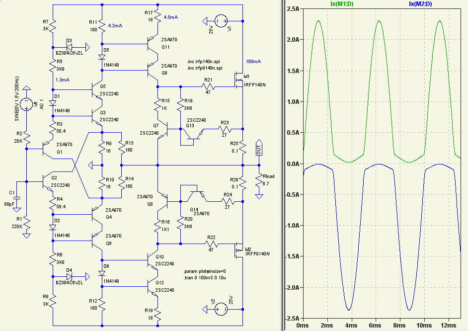

anli said:Have designed new MOSFET biasing. Three use cases (drafts) are below.
First one:

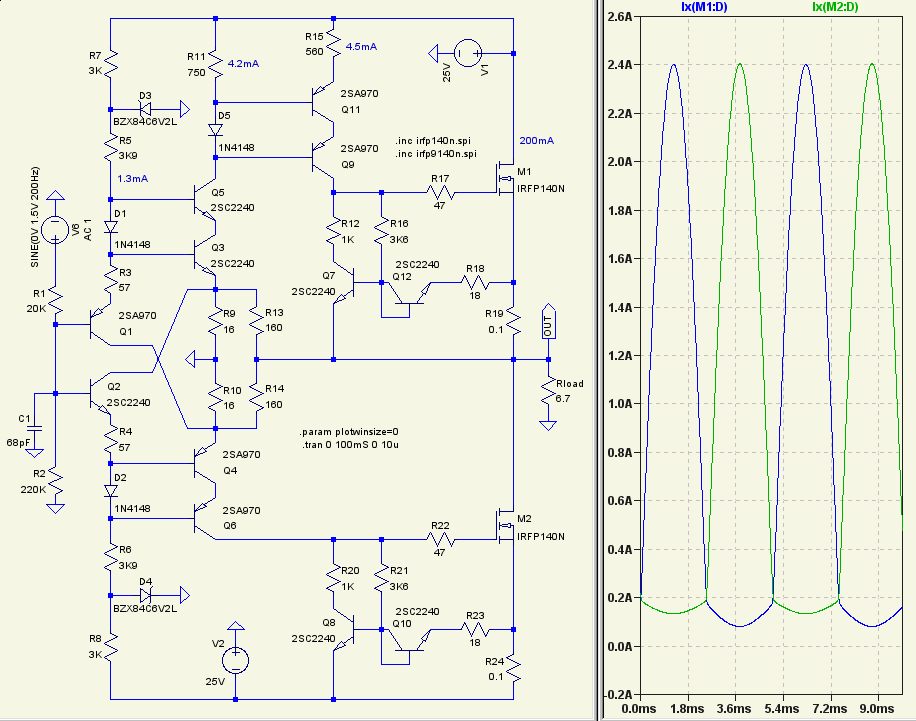

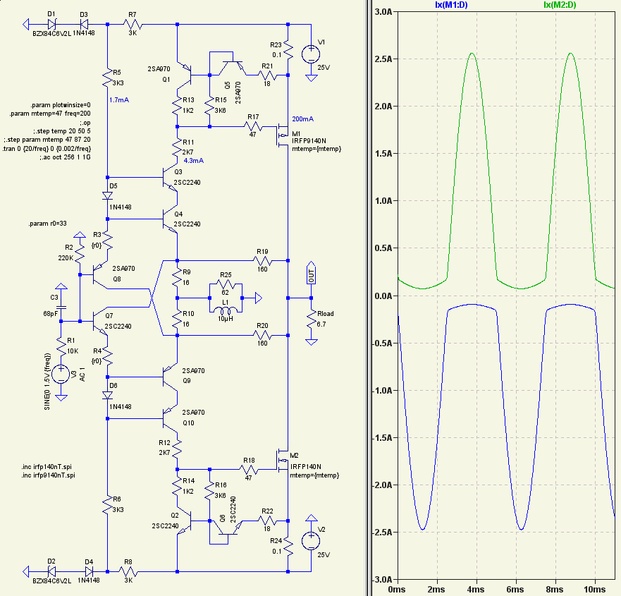

Here it is. Also modified LTspice's lib/cmp files are included.

Anli,
please can you explain how to get the nice pictures from Ltspice
you post here?
All your circuits are transconductance amps with FB so I take the best (the simplest, with THD20=0.23% ) for some improvements.
I add 2 drivers ,now all have a power bandwidth of 1MHz,
the simplest one has a THD20=0.01% which is fairly low for such a simple schematic !
Also I try to add a AD8099 for further FB, and at least the inverting example goes down to 0.000 12% without loosing the bandwidth.
Of course that´s only simulations but I am fairly confident that the behaviour in reality will be similar.
Thanks for your nice idee!
Regards
Heinz!

1. You have not set mosfet current to something about 150-200mA (with simply added follower you have ~2.7A).
2. I'm not sure THD itself does mean too much.
anli said:
Heinz,
OHHH, sorry, you are right how awkward!!
Please don´t look at my simulations!!
Now I changed 4 resistors and test the circuits again with 200mA quiescence current.
And of course bandwidth and distortion gets a bit worse.
When I added the driver I don´t realize, that a adjustment for different Gate-Source voltages would be necessary.
I hope I´ve done no further mistakes.
