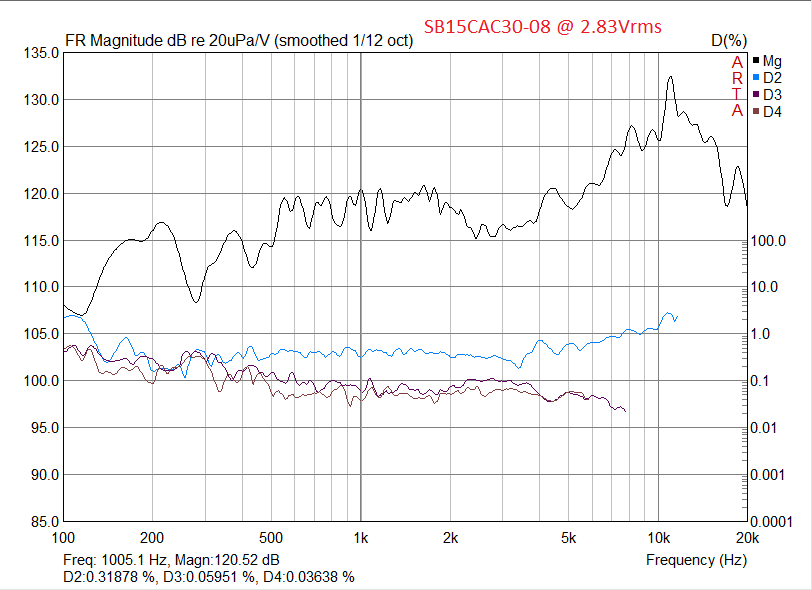

Hi Borys, did that lower mid bump on the manufacturers graph show up when measuring this driver?

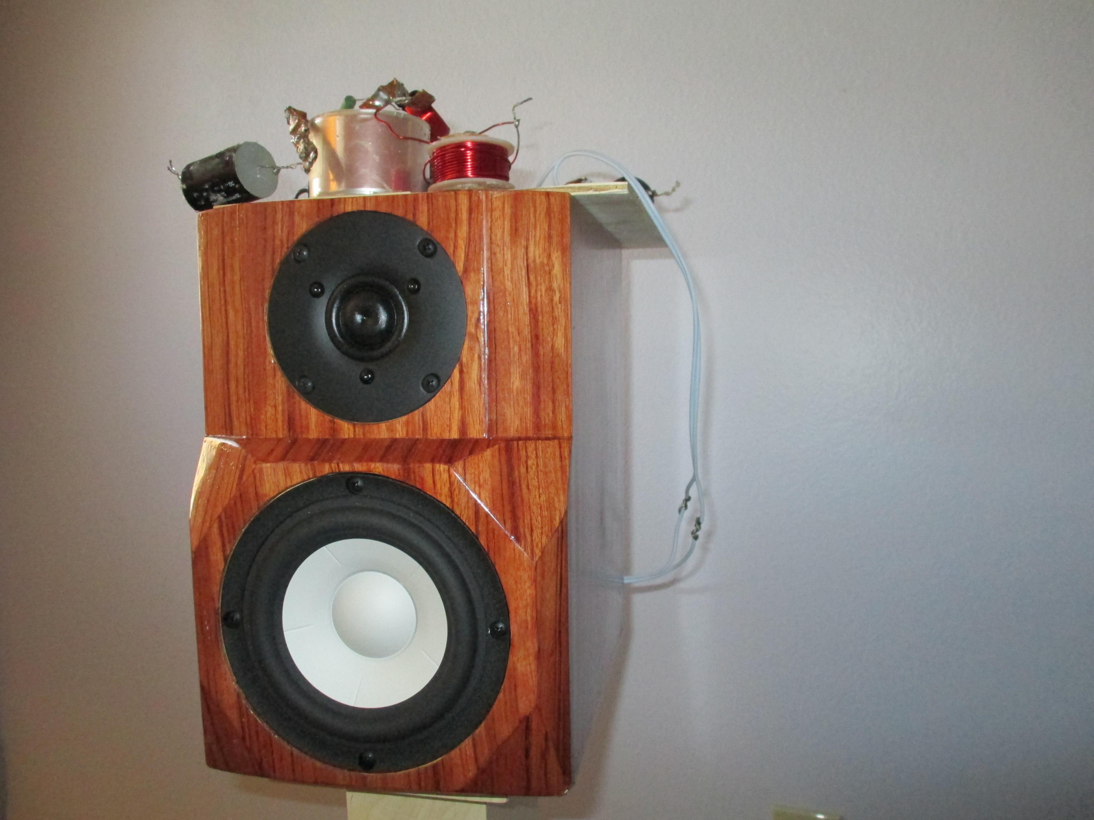

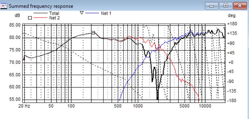

Here is my version of the CAC5.5 and the dimple dome. Baffle is 300mm x 200mm. Volume is about 10liters. I use my own extreme version of 12db roll off. I could do a more conventional 24db but don't like extra inductor on the 3rd electrical. My initial impression awhile back when I first listened is that the midrang sounds a bit "dead". But the xover was not optimized at 3khz since after 2khz, there is really nothing left of this driver. This current version takes the xover to 2khz with a 1.8mh inductor which is probably the biggest of any 2way system on the planet. Whoever designed this driver probably got some big ego.
Anyway, as for the sound, for the most part, it's not bad. Good detail, good composure at high volume, fairly deep soundstage. But and I think there is a big but. I said originally that the midrange was a bit "dead". When you look at the driver, the rubber surrounds is a bit thick and oversize for the size of the driver, I mean this is a midrange woofer, not some 8in woofer. For example if I wrap some rubber on your leg, you probably won't move very fast or in other words your transient speed will be reduced. So my point is rubber on your leg reduces transient speed. Same principle for driver. So get back to my point, the big but is the midrange lacks transient speed and a bit of get up and go energy. When I listen to these, it's the bass that is the constant attention but not enough midrange liveliness. I mean if these were the only pair I listened, I'd probably be a happy man but I've listened to Seas Excel and ScanSpeak stuffs so I can see the difference.
My other point is discussing 1st order vs. 2nd order. I've designed three pairs using 1st order and now this CAC5.5 using 2nd order. My opinions echo others, is that the 2nd is in fact cleaner, but sounding a bit dry vs. 1st order. There is a wetness in the 1st sound that not in the 2nd. And the one BIG difference is in the soundstage. I mean the width of the 1st just extends far beyond the speakers, whereas the 2nd the image more or less crowded within the boundary of the speakers. You may say my xover not good enough, but I've built some from Troels using LR2 and I see the same soundstage effect.
My other observation regarding crossing tweeter low vs. high. This speaker xover is 2khz which is the lowest of any of my speakers. You know I am not sure crossing low is the way to go unless that is your only option. I don't think I want to listen to midrange and upper midrange from the tweeter. There is something dry when the tweeter playing at these low frequency. I think the woofer is more musical at these low freq.

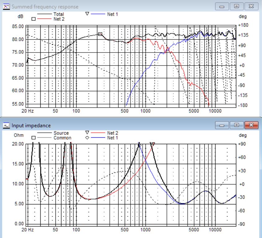

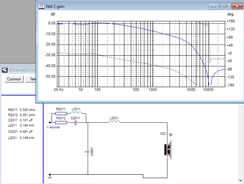

Very nice cabinetry! But I don't really think either of your filter sections are quite done yet. Individually they are both quite wonky, and that is causing you quite a bit of problem through the upper mid/lower treble range.
You succeeded in the exact crossover point, but above and below that is still forced. I strongly suggest you work to smooth out the individual driver responses as much as you can first, and then attempt to get proper level/phase matching through the crossover point.

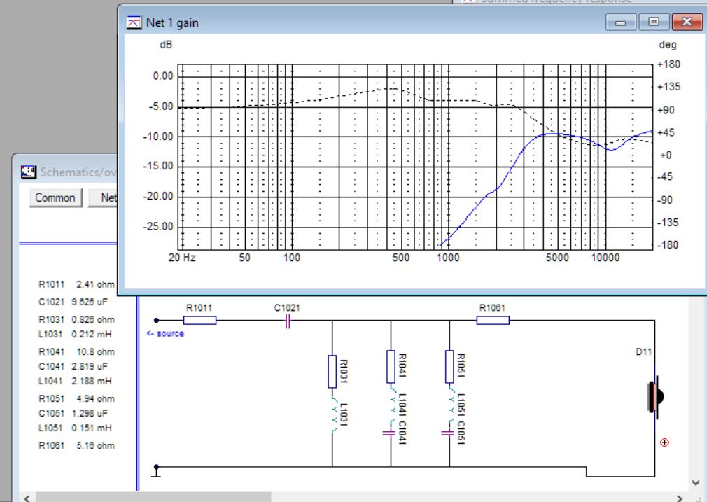

I encourage you to take a look at the filter response graph for the tweeter. Based on my quick simulation, I don't think your high pass filter is doing what you think it is.
Two things. First, it's acting a lot more like a single pole filter than you may have noticed. Secondly, that tweeter is really pretty flat, but your filter is deviating quite a bit from that.
Combined, it leaves me scratching my head. Mind you, feel free to get whatever curve you want to listen to, but this is going to be a little V shaped, AND may not cross over fast enough to protect the tweeter.

When Andy complained about his CAC design a few months ago I mentioned how his filters weren't exactly up to snuff. He took great objection to this and went off in a huff saying I didn't know what I was talking about (and apparently ignored me)
Using his measurements I put my money where my mouth was and redesigned his crossovers. Seems he hasn't tried them and continues to badmouth these drivers, whilst still using his same poor effort. Plus he hasn't added a chamfered block, as I suggested, under the tweeter, with the chamfer overlapping the tweeters faceplate and going up as close to the dome surround as possible, as a way of smoothing out the terrible case of diffraction he gets on the tweeter.

I can totally see how we get very excited over first giving life to a long project like this. But I'm still kind of scratching my head over how many measurements you took, and then stopped relying on best practices.
Just based on the transfer function, I would worry you aren't doing enough to protect the tweeter. So, on a reliability and power handling basis alone I have to question your design.
If your FR measurements are correct, I know I would find the speakers a little bright and discontinuous, on the other hand, the shape lends itself pretty nicely to lower volume listening.
Mind you, this IS how a lot of "high end" speakers are tuned. By emphasizing some ranges, speakers appear more revealing, and boy, do they sell, and if that is the sound you are going for, success!
Still, you can keep the shape of the curve while improving power handling and off-axis response. Personally, I really think you are doing those tweeters a disservice. They sound even better than this.
What you should at least acknowledge is the difference between the tweeter curve in 5th's design and yours. Notice how 5ths retains the ideal FR of the tweeter, but achieves a faster roll off? Compare how your crossover causes bumps and valleys in the tweeter alone. I mean, the reason so many of us are attracted to ring radiators like SB, ScanSpeak and Peerless is exactly because of the extremely smooth and extended output. You are not taking advantage of that so much as you are corrupting it.
