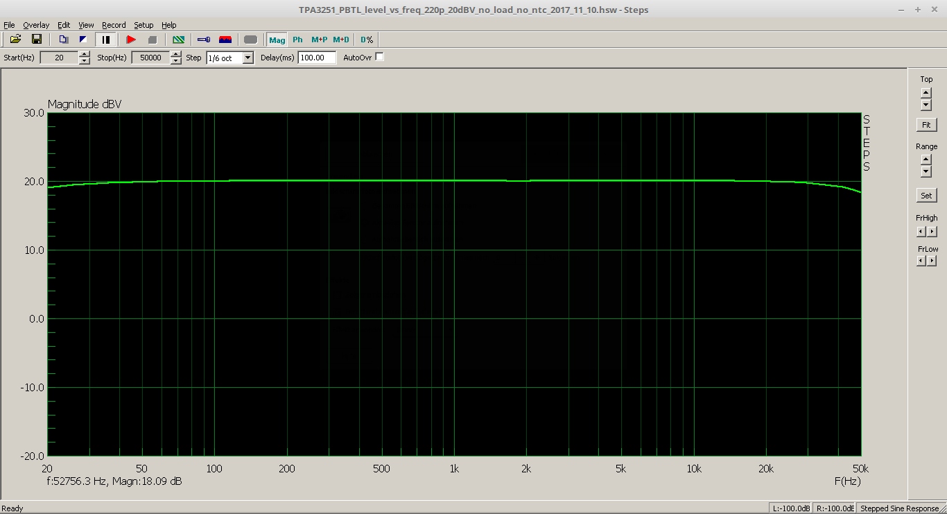

Let me say it that way: The filter recommendation are based on the calculation of the classical critical damped LC filter. In that case
sqrt(L/C) = Z(out).
With a filter of 10uH/1uF this computes to a "best" impedance of about 3 Ohms. The resonant frequency is
F = 1 / 2*pi*(sqrt(L*C)) = ca 50kHz.
This works fine with a 3 Ohm resistor that has no phase shift at 50kHz. Consequently the frequency plots delivered by the manufacturers a taken with low inductance dummies.
Which does not relate to your reality. There are no speaker drivers with such impedance properties and that means the upper frequency response of your class D amp more likely is the one with no load.
From that point of view it does not make much sense to change the filter for higher impedance speakers - let it as it is.
You may apply a fat RC impedance stabilizing network as proposed here.
Or you go for post filter feedback.

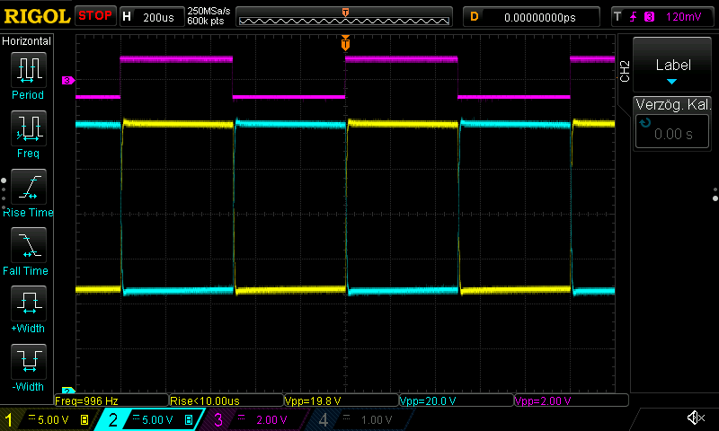

With my TPA3255 RefDesign from 2017 I chosed a special postfilter feedback which yields flat frequency responce no matter the speaker impedance. To illustrate this I append a frequency plot as well as the square wave response without load.

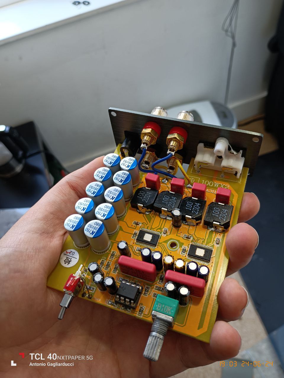

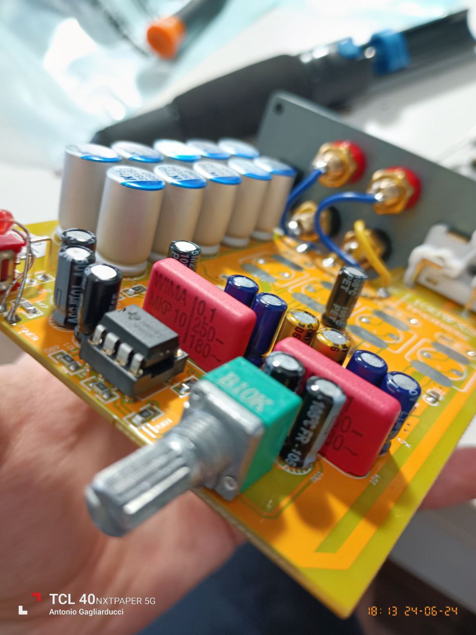

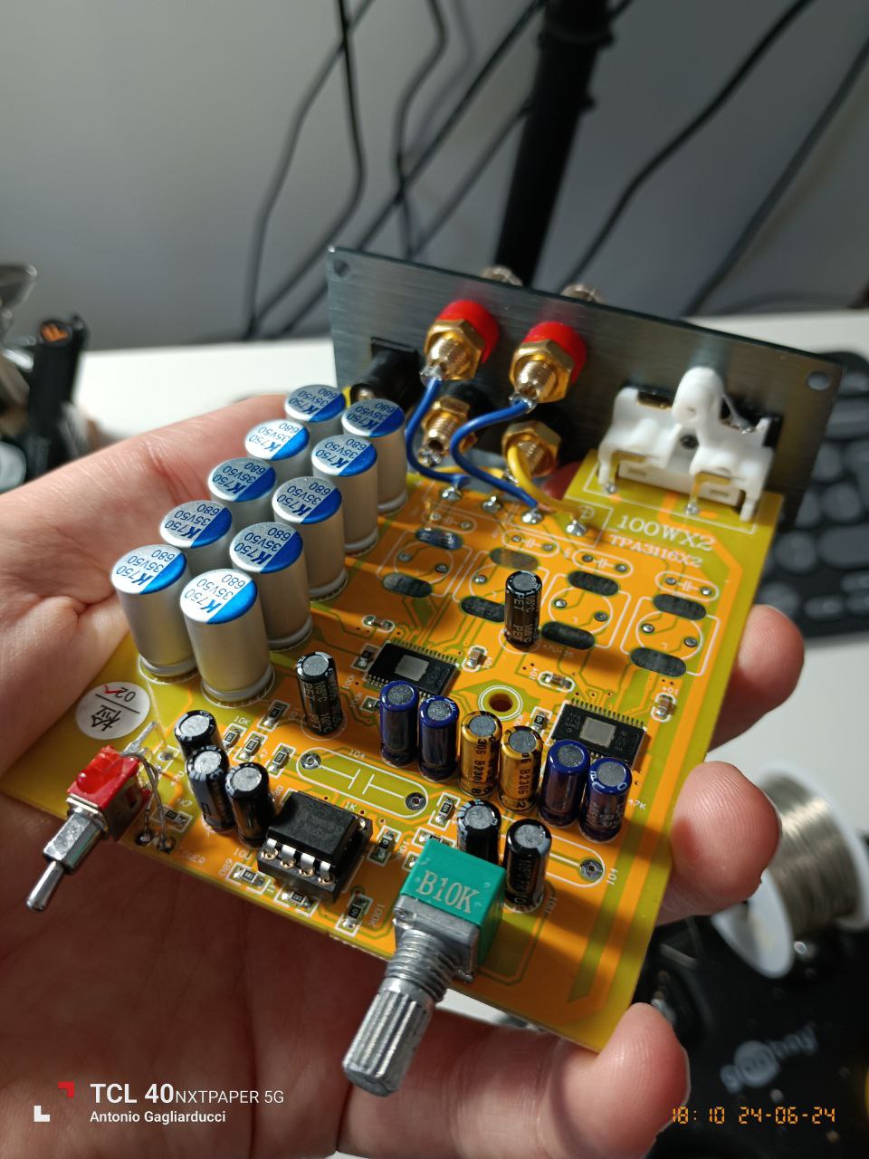

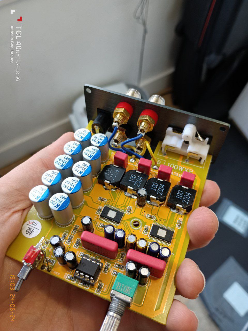

I have several choices here, from samples that were sent by manufacturers several years ago. No 5532, of course.
Didn't have the time to look into all of them, but I picked three that I think might be good there: AD712, OPA2604 and OPA2228.
Which one would you think might work better on the Breeze?
If they fit into the board (Data Sheet), just put them in and try to figure out differences.
Depending on the rest of the chain and listening material, maybe you find your preferred one for this board and the way it implements the OP-amp.
The better the speaker and sound samples are, the more you may hear. The tweeter is IMO the most important component. Got to be very good quality. I find it easier to find a favorite DAC than a "better" Op-amp.
You have to be in a perfect mental "Testing Mode" too, the house has to be silent. Often late at night it is much easier to find any differences, maybe the voltage feed is better with less load. Leave the beer in the fridge, even very little alcohol kills any objective acoustical judgement (see: "Party Mode")
Sometimes "better" it is like another dimension, sometimes it might only be a feeling in the gut. It is up to you to find out! Sorry, giving advice on such parts is not very helpful, it depends on your board and it´s components, what sounds best.
Anyway, better parts might not always lead to better sound, but I do not remember any case where they sounded worse.
If you want to know what is imagination and where reality strikes, You have to buy two DUT´s and modify only one. At the end you know where you stand or might give up tuning cheap stuff.
