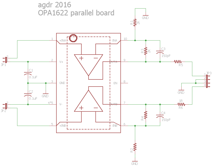

I think that I'm going to parallelize the OPA1622's by stacking boards.
Each board is 25mm x 30mm, just $1.60 each at pcbway.com for 10 (plus ship). I've included a (1R) series resistor on each output. If I use collet socket headers I should be able to stack the boards. Two boards gives two in parallel on each channel. 4 boards would give 4 in parallel on each channel, the minimum for good audio (kidding... ).
Part of the thinking here is the OPA1622's package is something I just absolutely don't want to solder. By making a small board with minimal parts I can get a quote on professional assembly by the board house. Then I can plug the stack into a larger DIY-friendly board that has the jacks, pot, batteries, and all the other good stuff. With 600pF drive capability I'm expecting that the chip won't have oscillation problems with the header/interconnect capacitance.
The amps are set up as non-inverting, of course. The ground return resistor for the parallel non-inverting input would be on the main board, similar to the O2 headamp's output section

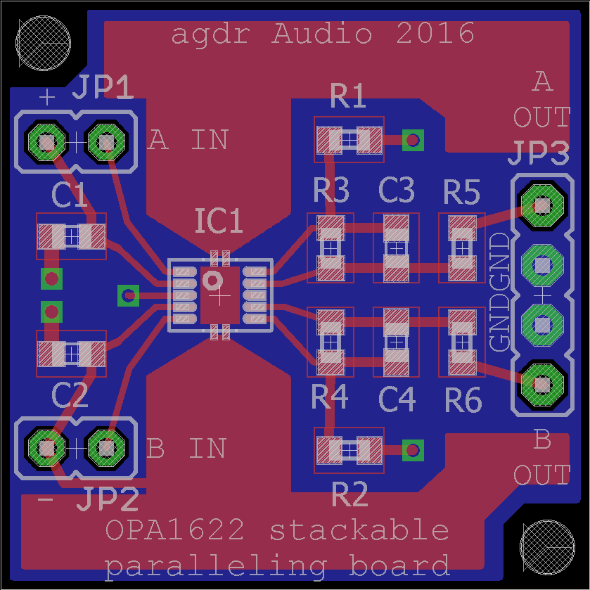

If I do have it professionally stuffed I could swap out the 0805 sized parts here to 0603, 0402, or other eye-crossingly-small SMD types.

I'm looking at your layout, and the R and C in the feedback loop are just as shown on the datasheet page 26.I think that I'm going to parallelize the OPA1622's by stacking boards.
The data sheet says:
"Place the external components as close to the device as possible. As shown in Figure 60, keep feedback resistors close to the inverting input to minimize parasitic capacitance and the feedback loop area."
This may be picking nits, but I've seen elsewhere that such small things can make a difference. It looks to me that the higher frequency currents (that are more liable to be radiated and such) go through the feedback capacitor (C3 and C4 on your layout) rather than the resistor (R3 and R4), and so it should be the capacitor that's closest to the opamp's output and negative input terminals, not the resistor.
On the datasheet layout it says "Place feedback resistors to minimize feedback loop area." That's certainly correct if there's only a resistor in the feedback loop, but I'd change that text to say "Place feedback COMPONENTS to minimize feedback loop area" and the component conducting the highest frequencies should be closest to the opamp.

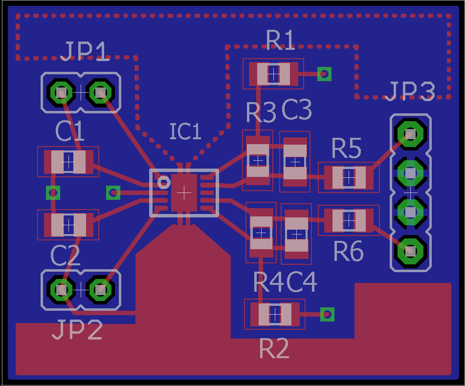

I cleaned up the parallel stackable board a bit, 25 x 25mm now, and converted to 0603 sized stuff. Clicking on the lower left corner will zoom it up quite a bit. I've also received an assembly quote that it is not too bad, $150 for any amount of boards up to 50 or so. If this thing works when it gets back and tested I'll start a thread in the headphone forum here.

Benb: You make a valid point about placing the capacitor closer to the chip to shrink the feedback loop at high frequency.

Whoops, I just realized that benb's helpful comment there was for the board stack. He was posting while I was composing! Thanks guys, I will take a look at that. I should swap R3/C3 & R4/C4.
Also, a question for John or anyone else out there with a boatload of layout experience. Would removing the soldermask over the two end-fire heat sink foil areas dissipate more heat than if they were covered with soldermask?

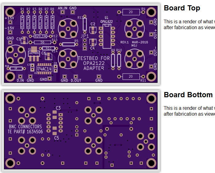

Just taped out my little test motherboard. It accepts the OPA1622 in the 10-pin, 300 mil DIP package, which I believe will probably be the most frequently used form factor for thru-hole adapters and daughterboards (example: post #76 in this thread).
It places four power supply bypass capacitors right at the pins of the opamp DIP: two electrolytic caps on the front (C2,C4) and two X7R ceramic 1uF caps on the back (C3,C5). Then the adapter daughter card itself has four more bypass capacitors.
50 ohm BNC jacks are provided, in case I ever want to try connecting it up to a spectrum analyzer or other super high frequency test equipment.
Will the very first revision work flawlessly? Highly doubtful. But we'll see.

Mark - I think your board is going to be popular. Despite quite a bit of searching I haven't found an off-the-shelf (V)SON-10 breakout anywhere. Lol, Google did come up with this for "SON-10 breakout" though and I got a good laugh.
I'm designing an amp in another forum here that will use one of your boards, if the vertical dimensions work out.
