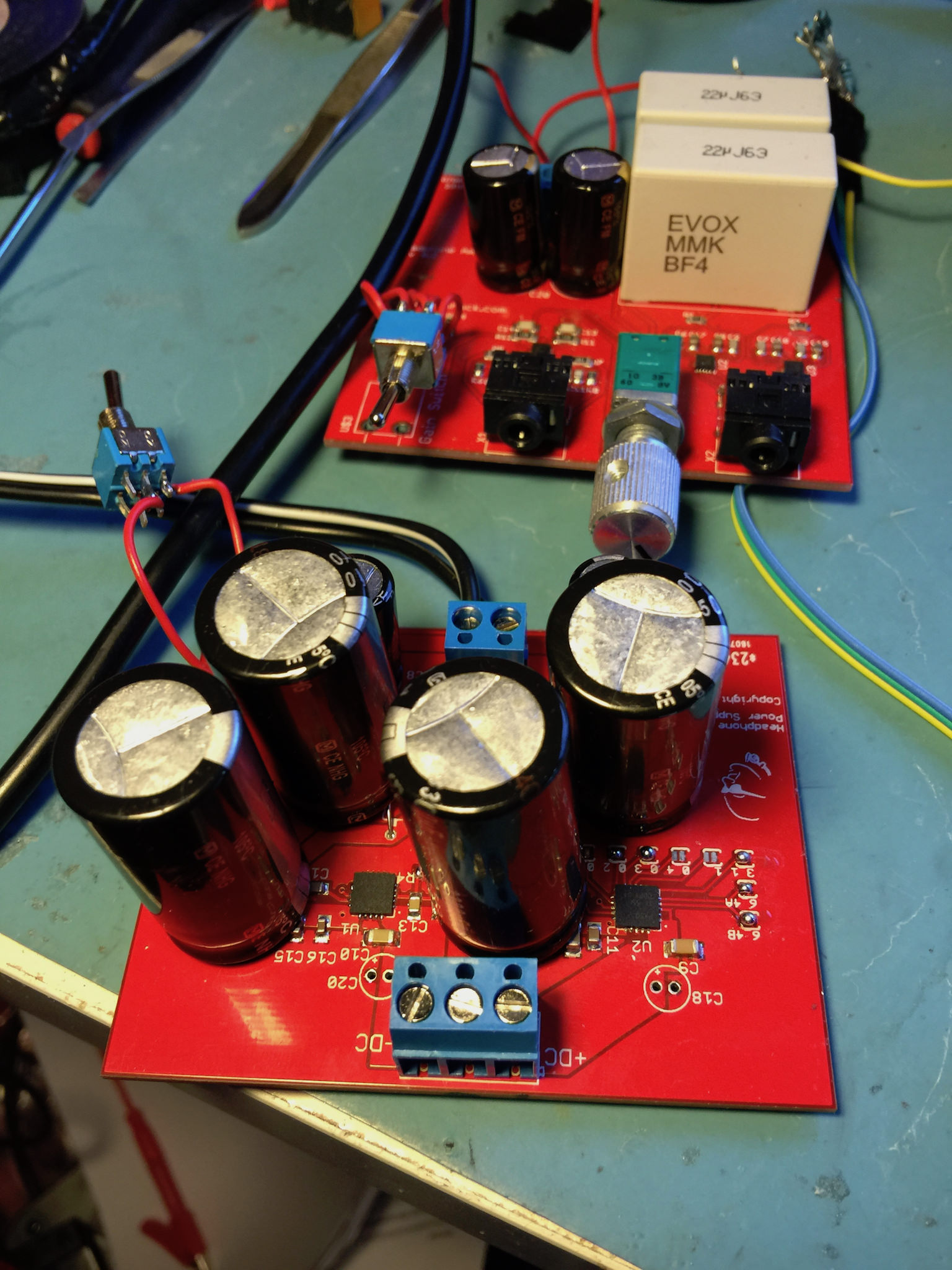

I've been running a dual parallel OPA1622 on the output for a couple of months now. Insane drive and measures excellent. Waiting for the final board version now. It can take quite the punishment! :)
Jacken
Awesome project!

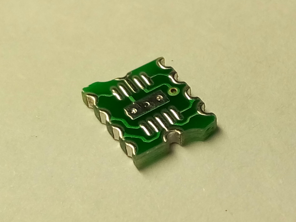

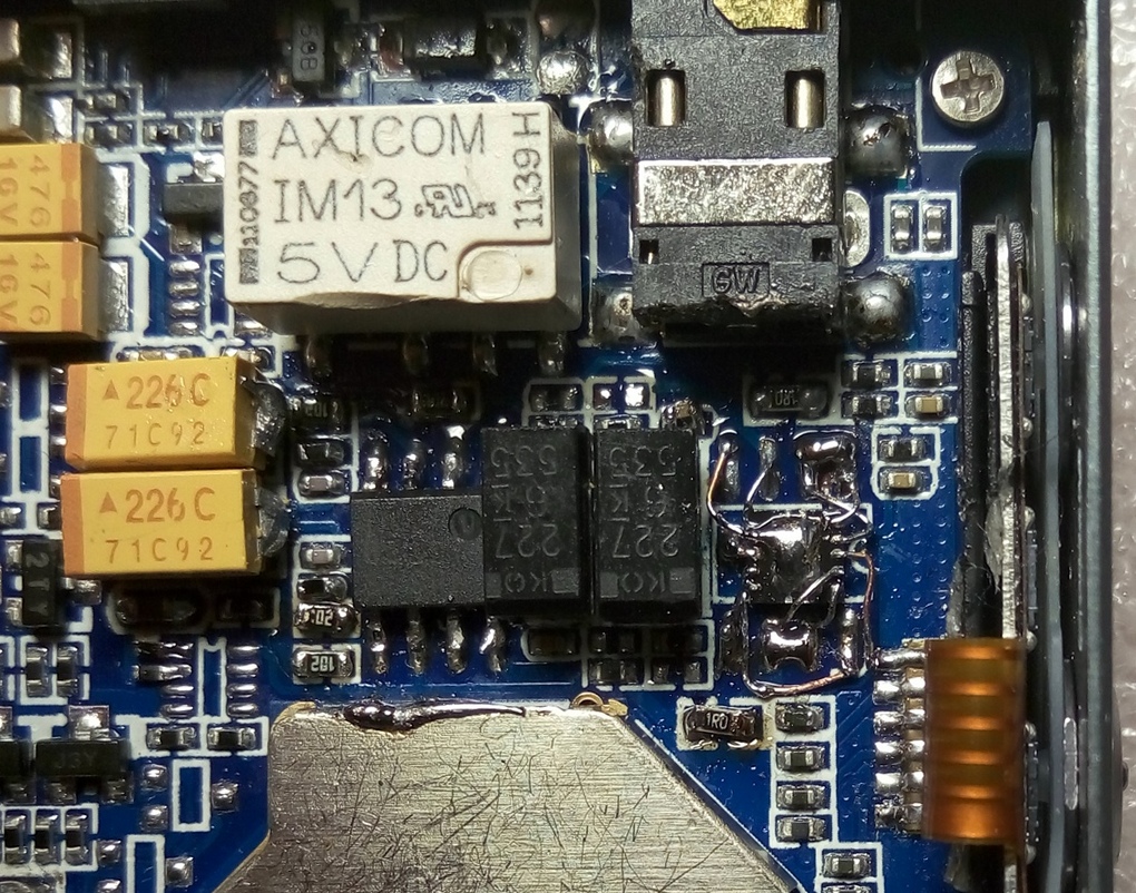

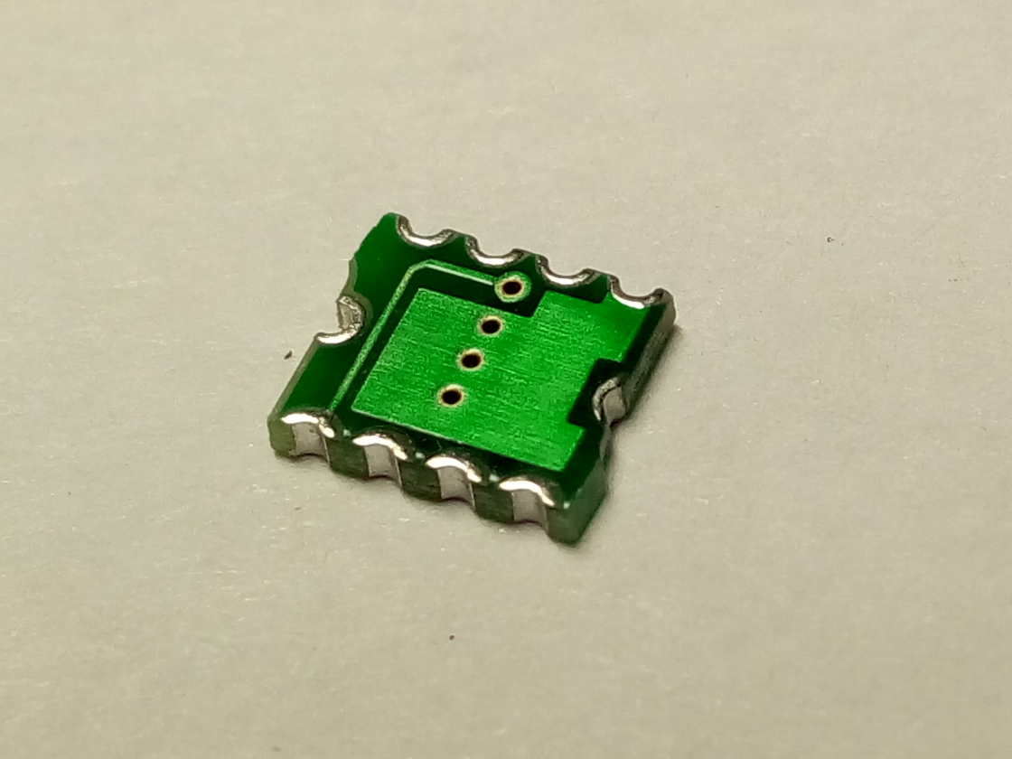

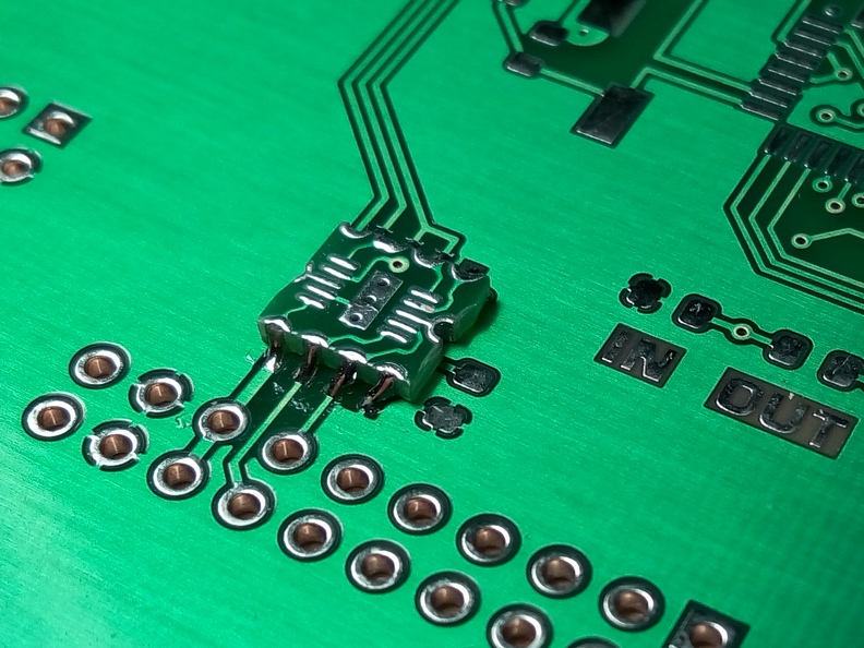

I tried to put OPA1622 to the output buffer of FiiO X3II player in place of LMH6643. The sound became excellent - clarity and powerfull. Amazing amplifier, no problem with unity gain stability. No thermal problems on 32Ohms earphones. It was very hard to solder VSON to the SO-8 place. Therefore I developed PCB converter to SOIC-8 placement but can't check it now, cause I had only one chip and TI discontinue to sent free samples to Russia.
