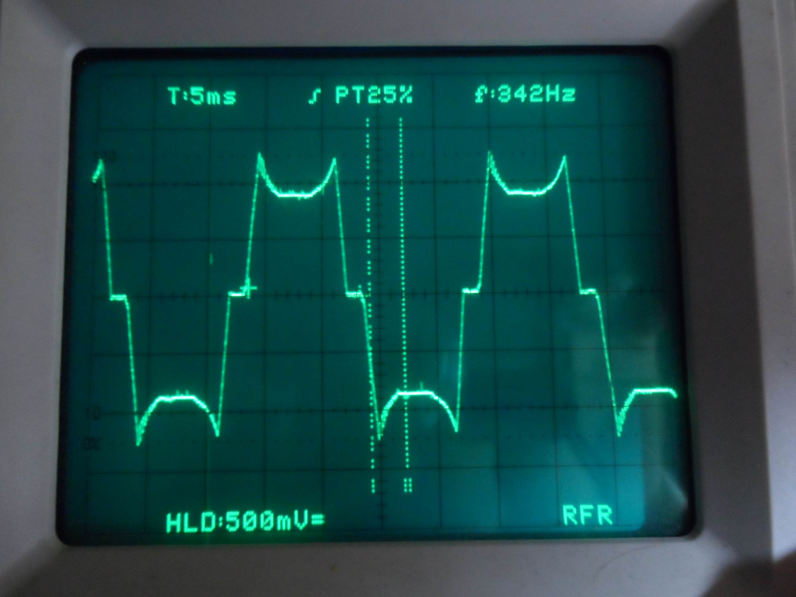

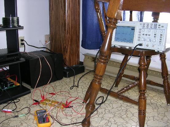

Hey guys,
I posted a question similar to the one tweeker is asking here. If you read back a few posts, you'll find it pretty quickly. I was having a hard time correlating the power output predictions of the Aleph spreadsheet, and the published specs from the Aleph 2 service manual.
Wuffwaff,
You gave me a similar answer to the one you're giving tweeker now (Basically accusing Nelson of exaggerating his power specs) , and after doing some measurements I can confirm that it's definitely the spreadsheet that is in error, not the published specs of the Aleph 2.
I used my completely stock Aleph 2 amplifier (built exactly as per the service manual schematic) for testing two dummy loads of exactly 9.5 ohms and 4.8 ohms. Using a 1000Hz sine wave input, and with the dummy loads connected to the ouput, I took current and voltage measurements using my Fluke meter and a Tektronix digital scope.
The Aleph 2 managed 4.18A pk into the 9.5 ohm load, which works out to 82.98 watts without any clipping visible on the scope. With the 4.8 ohm load, the Aleph 2 managed 7.63A pk, which gives you about 139.67 watts without any sign of clipping.
Now, what's worth noting is that my preamp was at full volume, and I'm pretty sure I could have managed a higher output if I had a little more drive from the function generator (my laptop). With the given setup, I couldn't even gets the amplifiers to clip.
So, tweeker, there you have it. The Aleph 2 does seem to accomplish its published 0-100km/h rating without a fuss. I think the spreadsheet might be fun to play around with, but it obviously falls short of describing the actual operating conditions of the Aleph, at least when it comes to power output.
I'll include a picture of the test setup, just so you know I'm not making this stuff up.
Hope this helps things,
Owen C.
