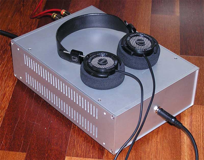

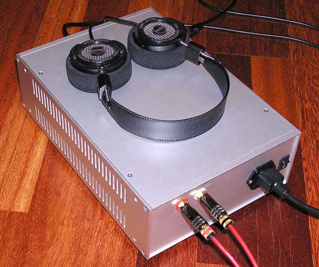

Yes, I would definitely like to change the front plate with a thicker one some time, the same goas to the bottom plate as that one also is only 2mm. It is just that I had really easy access to these plates. I do not really mind the screws, but it would be nice if they could at least sink into the aluminum a bit.

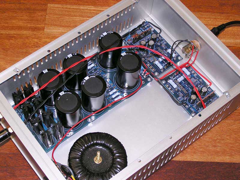

Interior view. You can't quite see it from this pic, but there is 0.2F in the powersupply in a CRC configuration. I also used Ultrafast Soft Recovery diodes from International Rectifier for the rectifier bridge. Major overkill for a headphone amp, but this supply is deadly quiet even without using a regulation stage. I left room in the chassis to add separate regulators for each channel in the future if I change my mind. I designed for +/-15V rails, but ended up with /-17V. Gotta luv Plitron trafos.

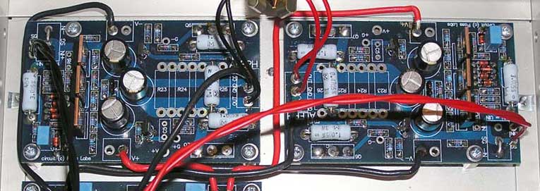

Closer view of the stuffed amplifier pcbs's. Nothing exotic used here. Matched the IR9610's to less than 0.1mV, and ended up with +8mV and -11mV DC offsets for the left and right channels respectively, probably due to resistor mismatches. The bias is set at 0.25A and the CCS at 50%. Max power into the Grado's is 3W.

Oh yeah, I almost forgot to point out that the output transistors are not missing, but are underneath the pcb's and mounted to the chassis for heatsinking. Used IRF610's for the outputs.

Great job, Metalman Now lets see, in order to scale this thing for a headphone amp: Supply rails +/- 15V, output devices irf610,
source resistors 1 ohm, output resistor 0,47 ohm. Smaller trafo. Thats what I gathered from your posts and pics. Is there any other changes needed?
Steen.

metalman said:Interior view. You can't quite see it from this pic, but there is 0.2F in the powersupply in a CRC configuration. I also used Ultrafast Soft Recovery diodes from International Rectifier for the rectifier bridge. Major overkill for a headphone amp, but this supply is deadly quiet even without using a regulation stage. I left room in the chassis to add separate regulators for each channel in the future if I change my mind. I designed for +/-15V rails, but ended up with /-17V. Gotta luv Plitron trafos.
Hey there Tin Man, those caps look good.
What value are those power resistors in the PSU?
Regards
Anthony
A few of the resistor values need to be adjusted, but not many. I'll put together a complete schematic for you and post it.Originally posted by steenoe

3 x 27 ohm on each rail. Quite high in comparison with what you would use on power amplifiers, but as this is only dealing with 0.5A total current, I could really ramp it up to drop the ripple, which measures at 0.5 mV(peak to peak).Originally posted by Coulomb
Cheers, Terry

Thanks Terry, I tried 5 x 50R all the way down to 2 x 50R on my Mini A's and the rail VD was half the Supply voltage. I figure that when using one PSU with two Mini A's 5 x 500R is going to be required to suppress ripple without crushing the rail voltage.
