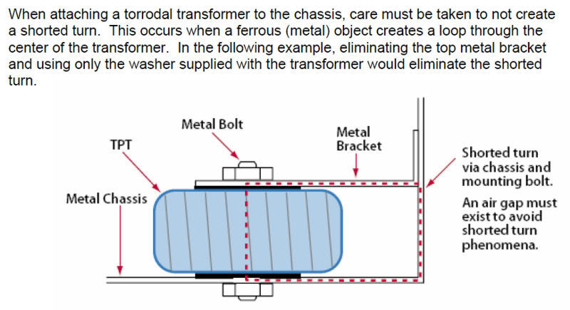

Shorted turn ?...copper grounding bus...
That's intersring, I had not thought of that. I can replace the bolt though the transformer with a nonferrous bolt, or even a reinforced nylon bolt.
I wonder what kind of voltage is induced here. FYI the copper bar is not bolted to the chassis at any point. The rear of the coper bar is bolted to the transformer retaining bolt, and the front of the copper bar is attached to a delrin post. But, a copper wire does connect the bar to the account line safety ground, on the back panel.
I'll put a nonferrous bolt in there, that should eliminate any interaction with the transformer.
What kind of problems could this shorted turn cause? There's no hum or noise in the amps output.... I suppose the shorted turn could heat up if there was a significant current flowing....

Shorted turn on transformator - YouTube...What kind of problems could this shorted turn cause? ...

I opened an air gap between the copper bar and the chassis, and I measured NO VOLTAGE there, to the limits of my ability to measure - so, less than 0.00 mV of AC (or DC for that matter) and also looked at current that might be flowing through this "shorted turn" and found less than 0.00 uA of AC. This is the lowest limit of my ability to measure. So, no, the assumed "shorted turn" created by my copper bar is not real, it is not a problem.
I listened to the amplifier and then replaced the steel bolt through the transformer with a nylon one, and listened again. There is no difference in sound.
In best case it will just melt without burning your house.
