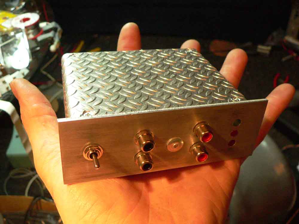

I've just really started to listen to AMP9 and it keeps surprising me, what a wonderfull amp....sigh.... Showed it to my collegues yesterday and they were really surprised again by the enormous power from such a small box...'so there are two stereo amps in there?! Waaow!' Tomorrow (if there's time) I will connect some PA speakers at work, one of my collegues insisted upon doing this test...
I've just recently upgraded my subs at home a bit and will test AMP9 in parallel on them soon..(I have three TAA4100A-based amps at the moment..two can drive my speakers at home, one in my car if it performs well in parallel. otherwise I'll sell one to a friend...my car will have an SMPS-driven AMP5 or two AMP11 in the near future....)
