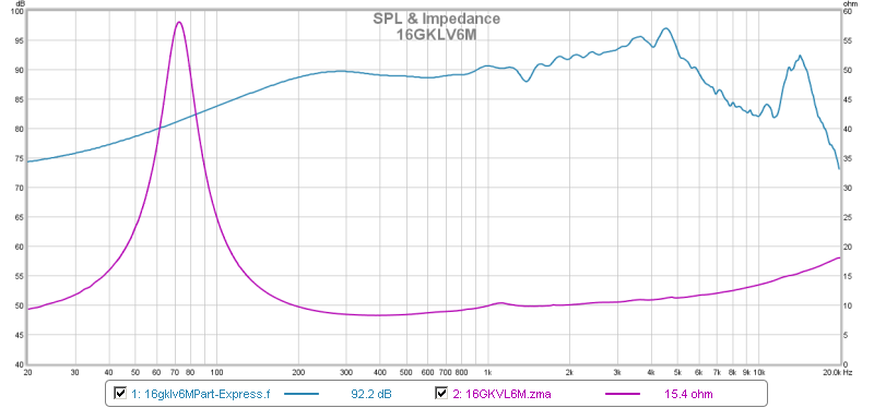

You will find in attachment the measure on axis of the low pass section of the Davis 16 (0.56 mH + 4.7 mF). It's about 4.5 Khz, and should be more near 3.5 kHz of axis.

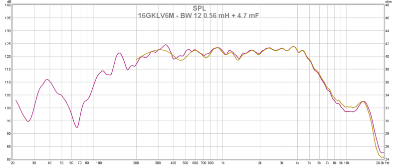

Thank you very much, this is very helpful :).

Because an electrical 2nd order filter with 0.56mH and 4.7 mF applied to the 16 Davis produce a 3rd accoustical order.
Oops, didn't think about that !
The filter order must be combined to the driver's response to obtain the acoustical order.
BUT, in my case, I have chosen drivers frequency response that overlap a lot.
The Mid goes up to 5000-6000, while the tweeter goes down to 1000. So If I take 4000 as a cutoff for my filter, I'm far away from both drivers cutoff and no need to take into account the driver response slope :)

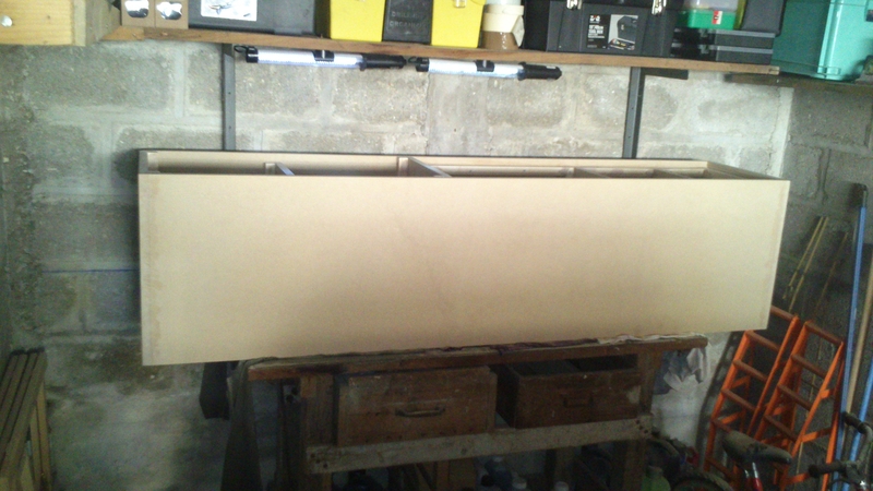

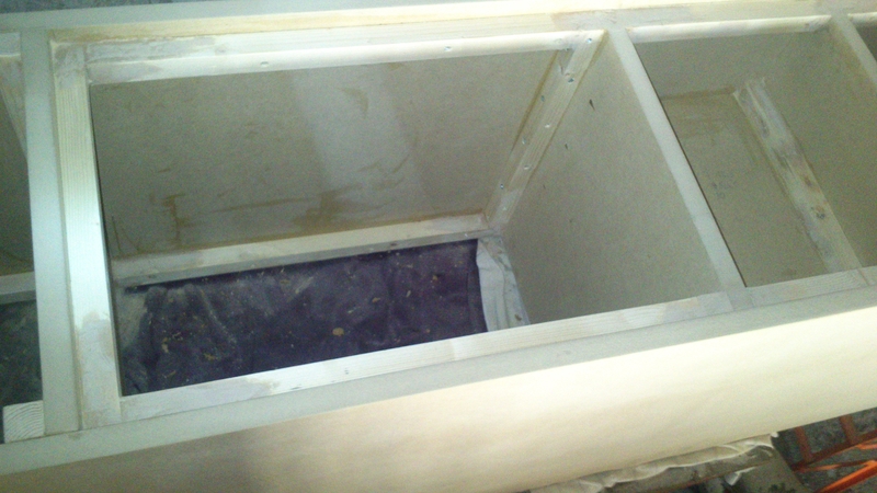

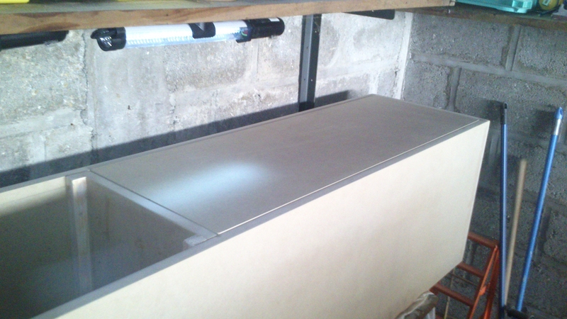

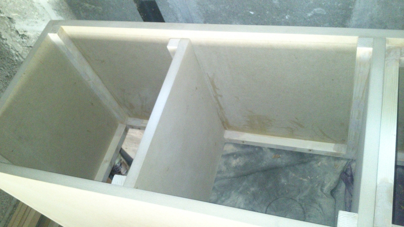

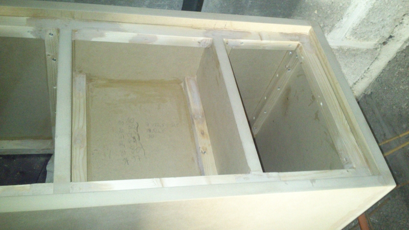

Hi guys,
Some news of my project !
I'm almost done with the woodwork of the first speaker :)
I still need to cut out the holes: for the 3 drivers, for the binding posts and for the vent.
It took a while to apply wood paste to all the junctions between the different wood parts and to be as much air-proof as possible. I also bought some rubber joints to stick around the woofer and midrange volumes.
I've decided to make a few changes to the initial plan.
The 16GKLV6M mid-range will be working in a closed box. It will be cut-off at 300Hz so no need to have a bass reflex vent to enhance the low-frequency .
As for the woofer it will have only one vent in PVC : 9.4cm x 33cm.
The next step is to paint the white sublayer/undercoat in order to make the MDF less porous.
After that, I think that I will paint it all in glossy black. I would also like to have part of it painted in dark red but I don't know where... :confused:
Cheers

You will find in attachment the SPL and impedance files, see plot.

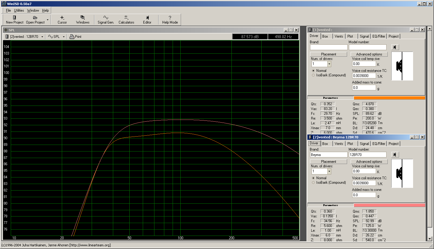

Concerning the simulations of the two speaker D300P04 and 12BR70, see WINISD simulations : 12 BR70 / 90l / 35 hz - D300P04 - 60 l - 30 hz both 350 Hz low pass first order.
The second-order @ 2000 Hz for the Davis is a shame... The 16GKLV6M has a linear response up to at least 10KHz
See plot ... Very linear :)

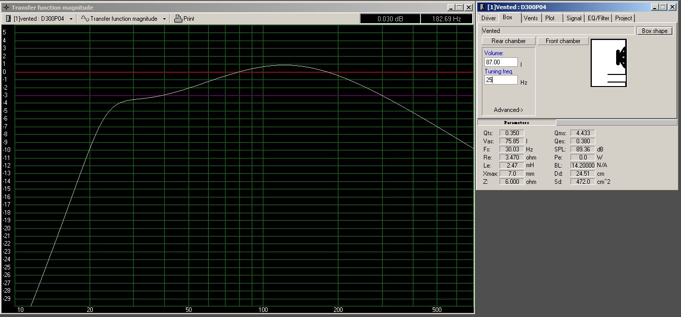

On both setups, If you look at your response at 25Hz, there is nothing left (around 76dB)...
If you choose 87L for the Atohm D300P04 with a vent resonance frequency at 25Hz, you obtain almost 86dB at 25Hz (please see simulation in attachment).
Regarding the response of the 16GKLV6M, you are right ! It is not linear at all starting at 2000Hz. So I think the option of cutting off with a second order will mask all those non-linearities above 2000Hz but you need a tweeter capable of going down to 2000Hz.
On my side, the first order cutting off at 4000Hz turns out to be not so bad because it will attenuate the response peak of the 16GKLV6M around 4000Hz with a -3dB attenuation. As for the seconde peak at 15KHz, you will have -15dB of filtering at this point (~78dB response), so it will be completely hidden by the tweeter 92dB at this point.

I can't presume of the transfert fonction of a crossover without simulations.
QB3 alignment for D300P04 is 52l tuned to 33 hz.
