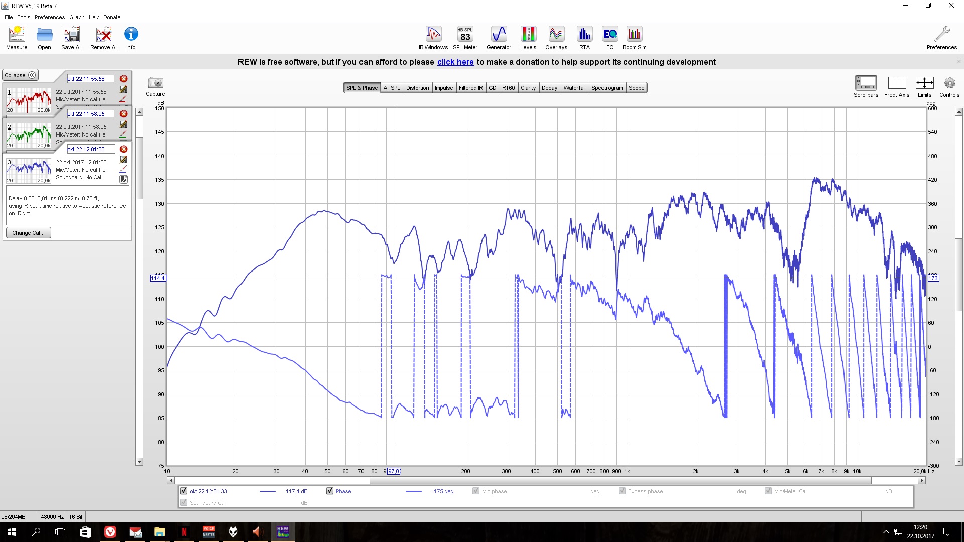

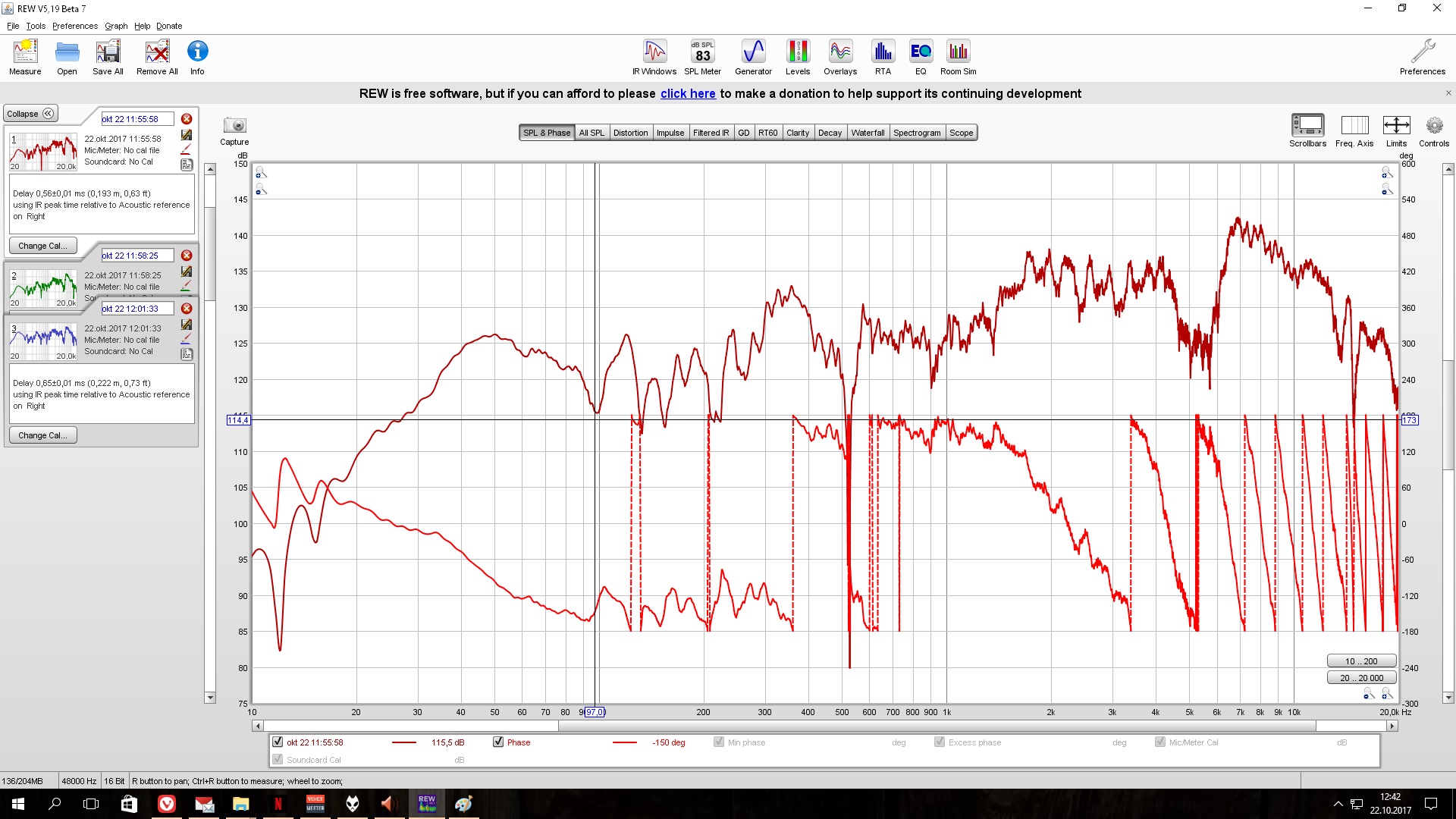

... I've tried taking some measurements, and asked everyone to be quiet for the duration, you know just before pressing the button in REW and giving an "all ok" after the sweep. It's just under 30 seconds including a quick "check levels" and "wait for timing reference".
The kids where quiet enough, but the Lady of the house could not accomplish this simple task... Even though we woke her up with omelette breakfast, coffee and well behaved kids.
With this in mind, in addition to the sub-optimal baffle and absolutely rubbish room placement, please ignore the results under 1khz. Done the sweeps 3 times, had to do it a bit too close to limit reflection about 40 cm so there might be some artifacts that do not exist further out., and the results over 1khz are reasonably consistent. The v2 picture is the most accurate. V1 is with some EQ.

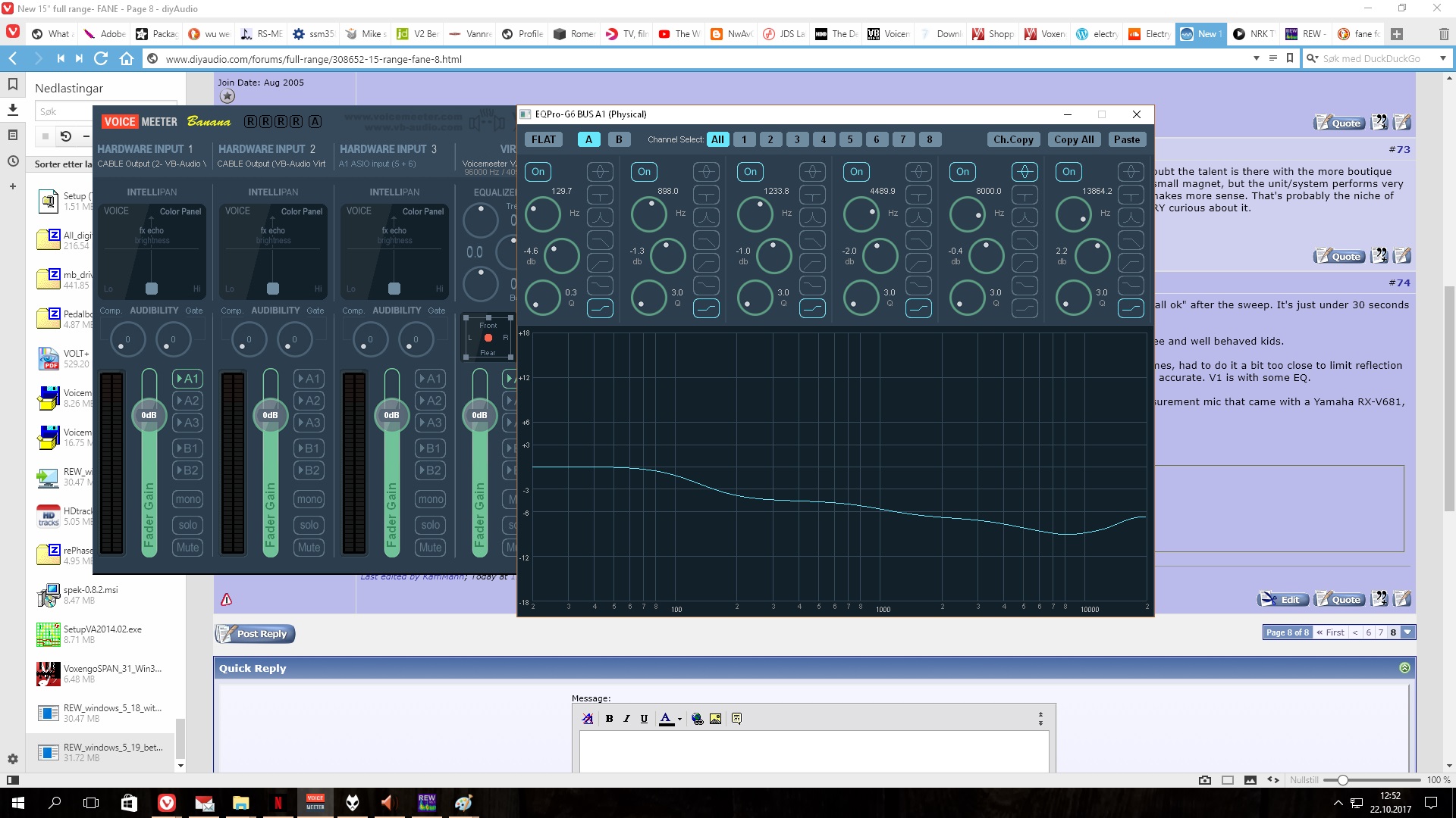

Added very basic EQ curve from the V1 measurement picture.

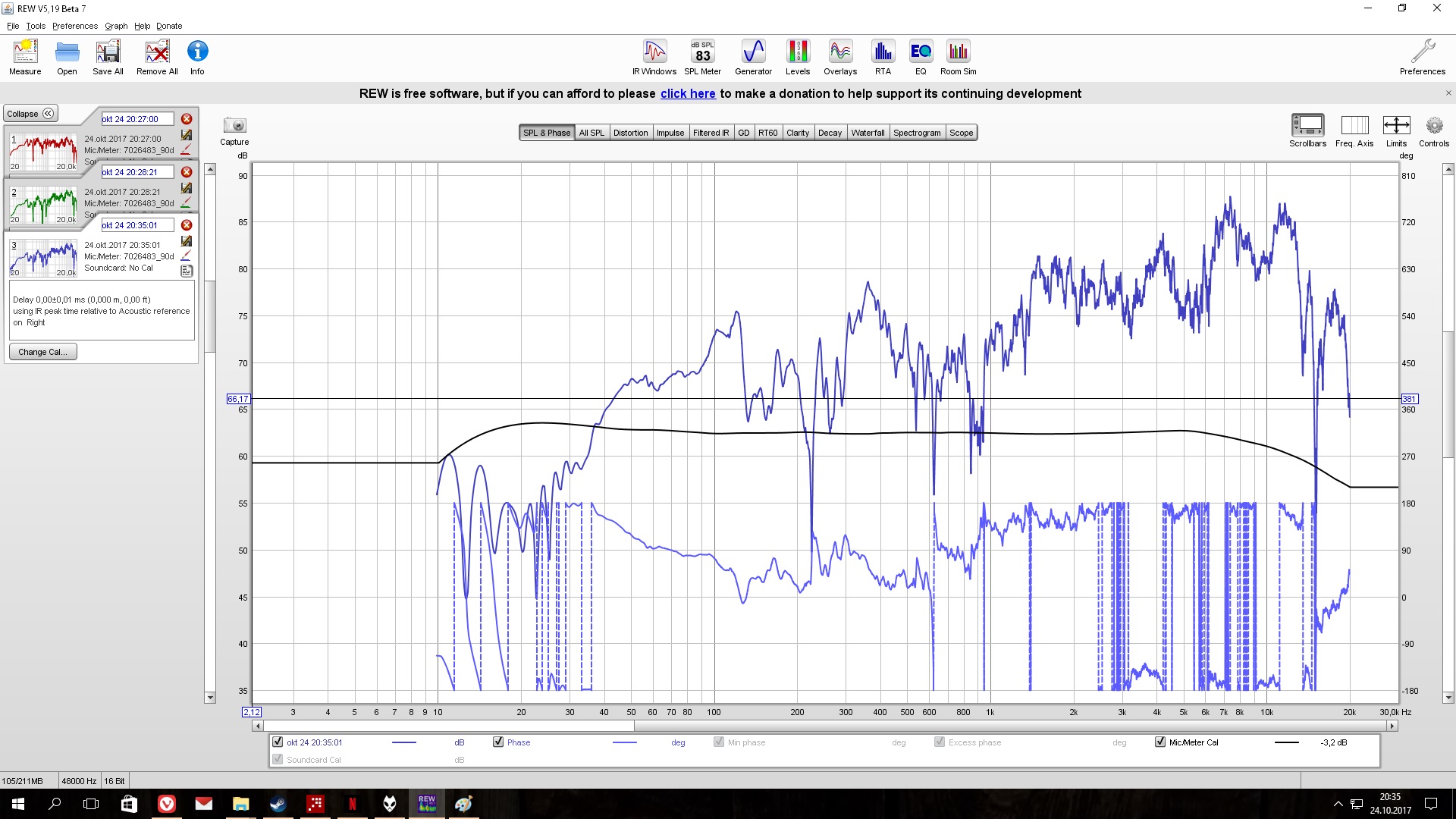

I bit the bullet and got a Umik-1.
Here's the vanilla response with the sub-optimal baffle and the rubbish room placement. 5db/division.
Edit:
Will not make proper measurements outside until 1. it stops snowing and 2. the sealed box is finished.
But then I expect flat response below 1khz also.
