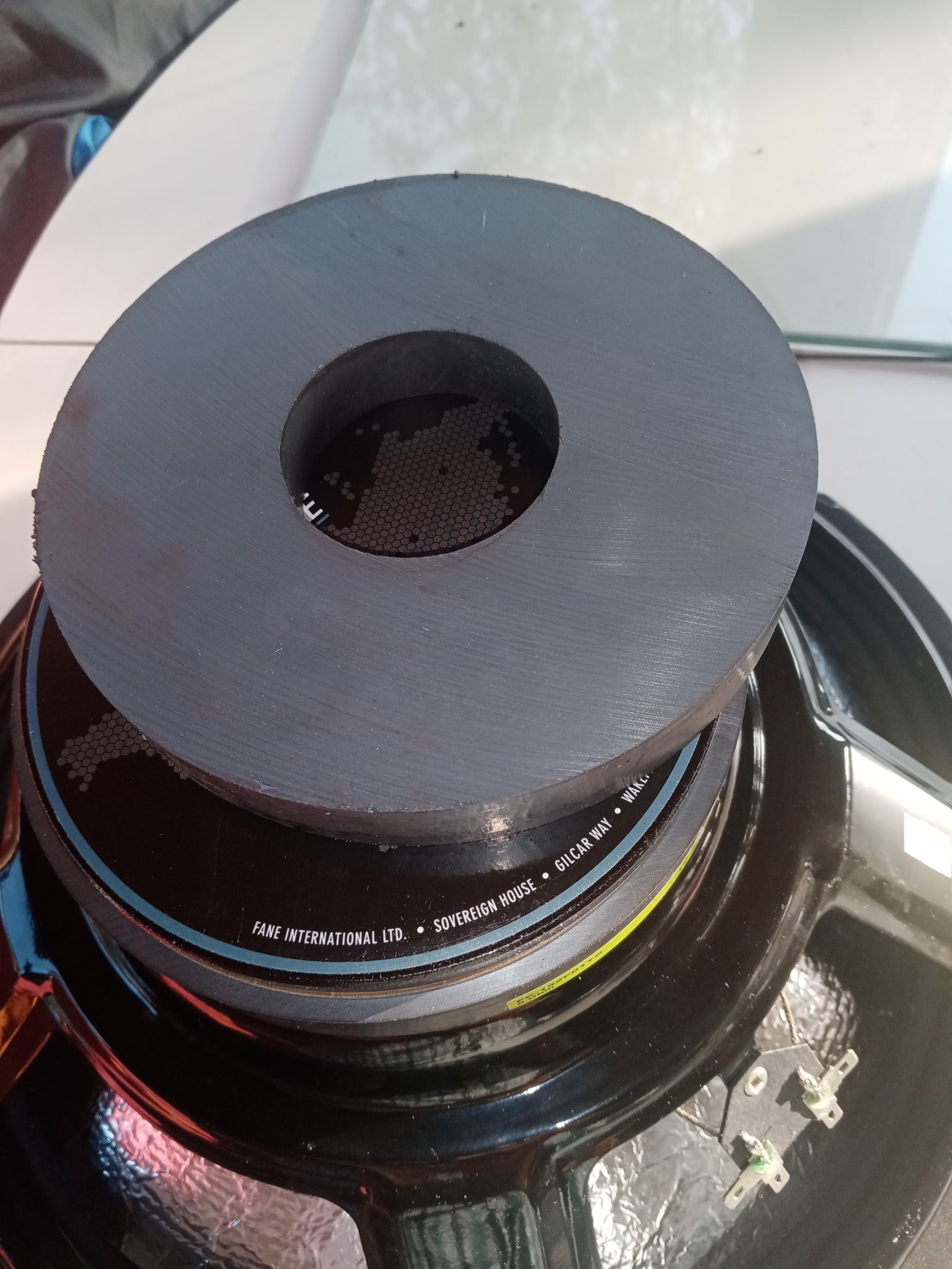

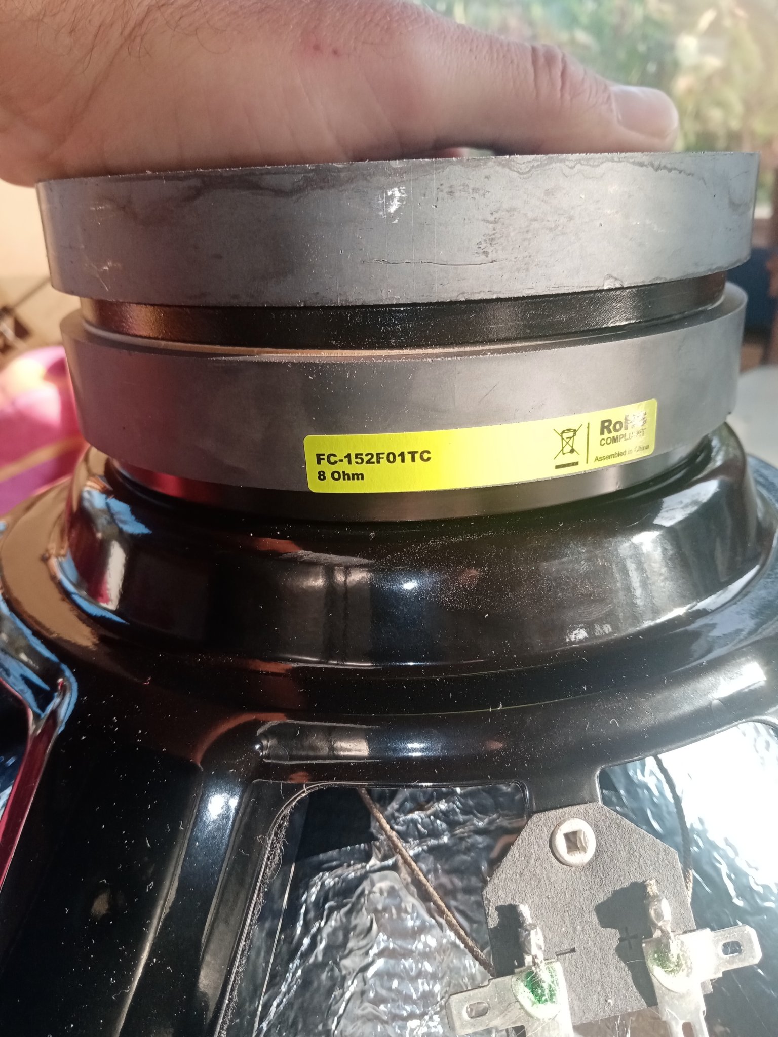

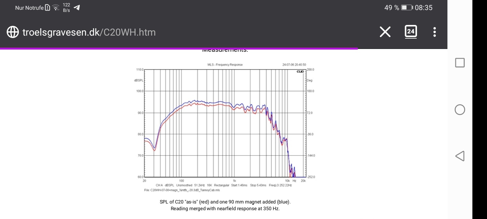

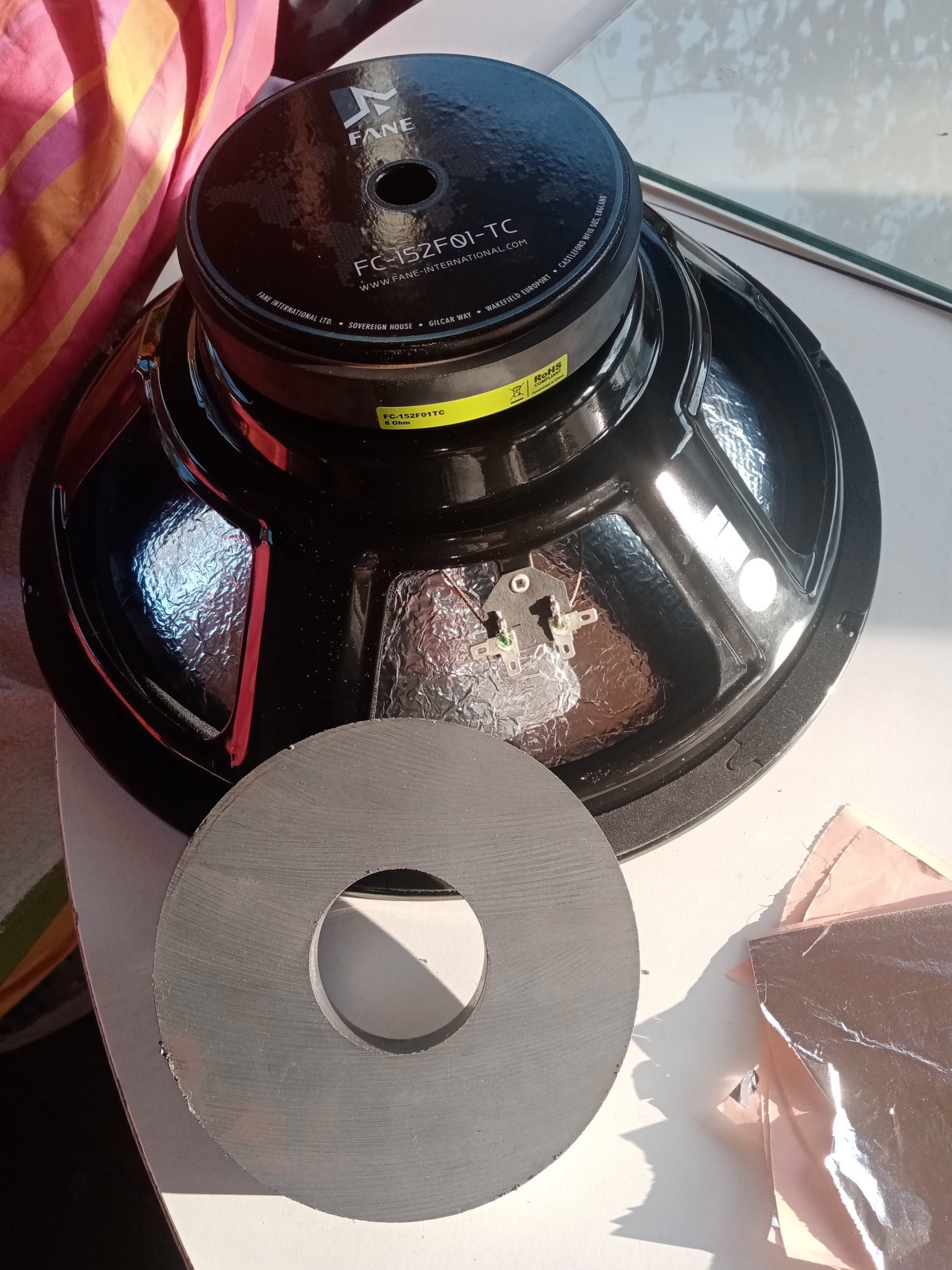

You can get a magnet of the same size for the 15-300tc for 18€.
You can expect +1.5db more efficiency. So reports Troels Gravesen for a speaker project.
At magnet max company
Ringmagnet Ø 156,0 x 56,0 x 20,0 mm Y35 Ferrit

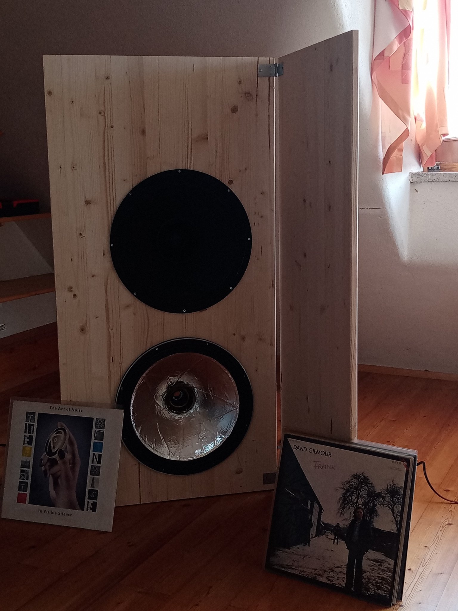

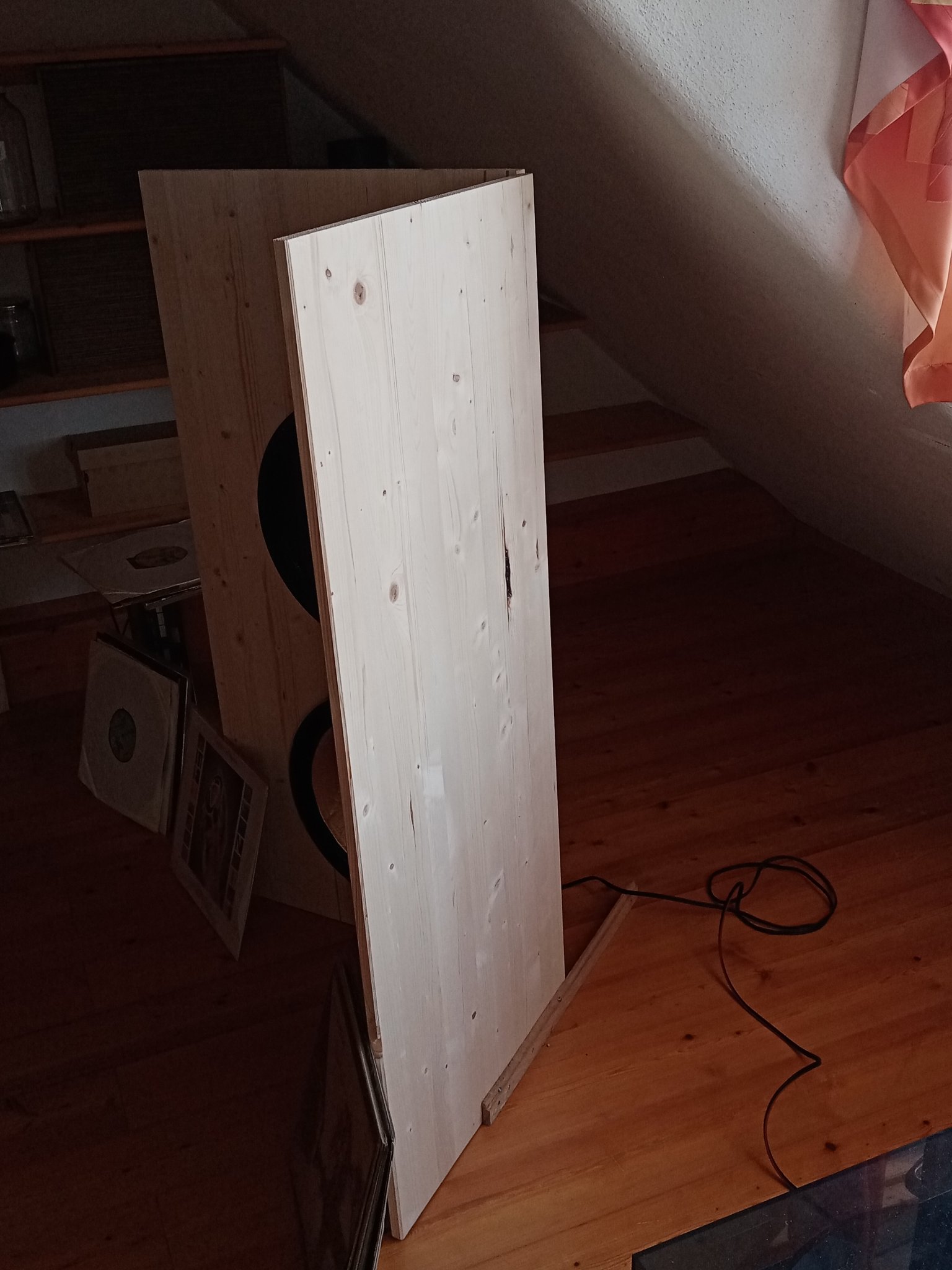

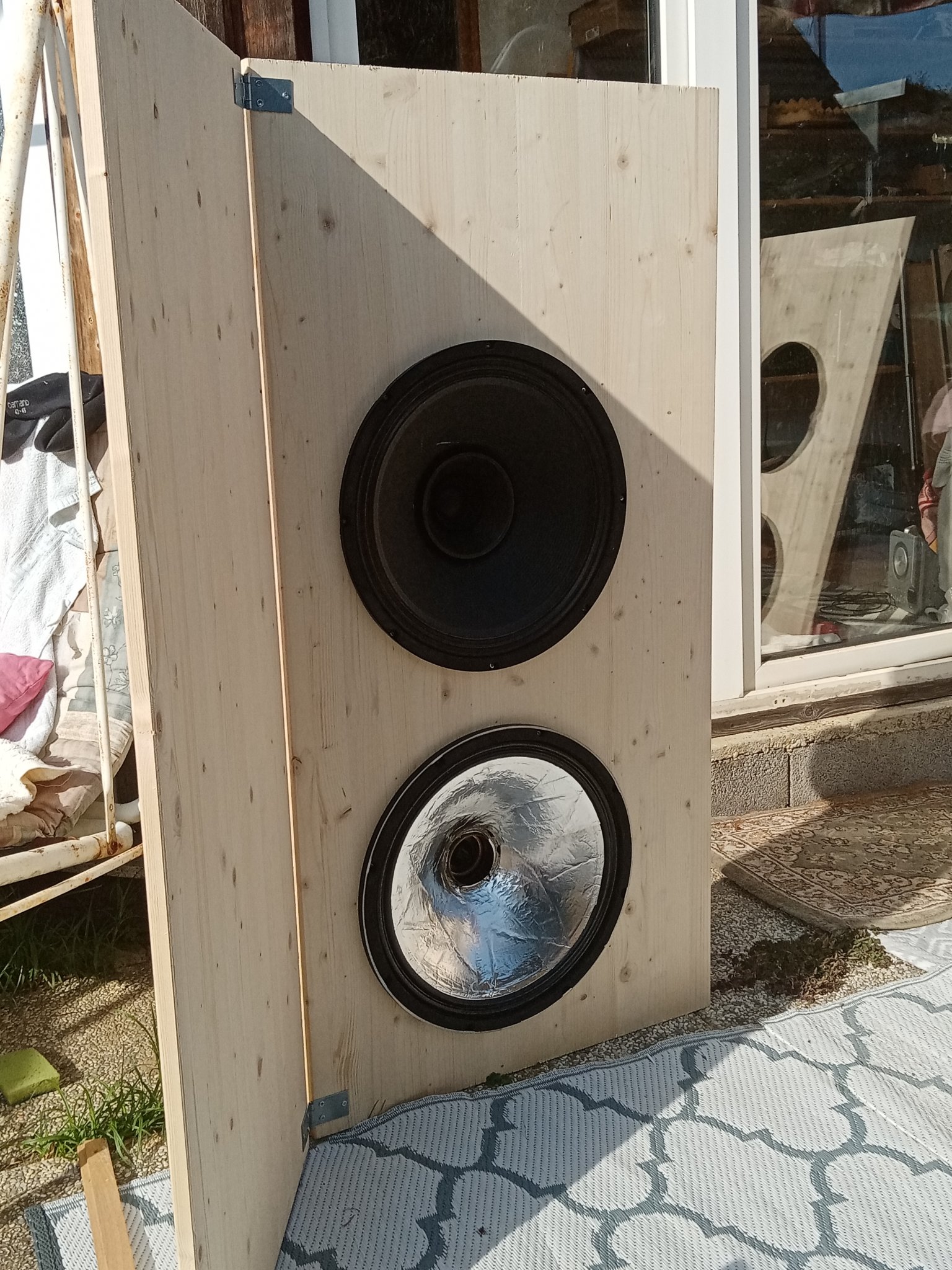

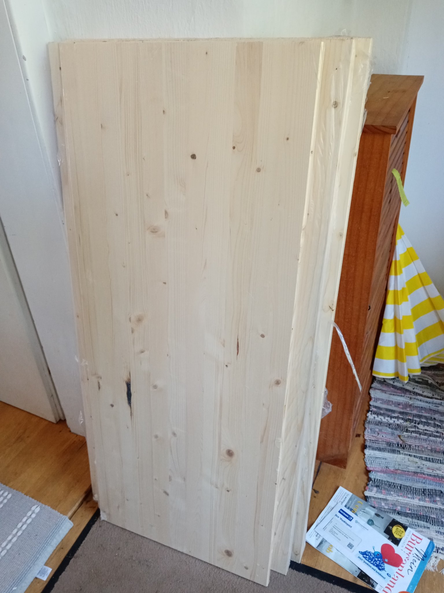

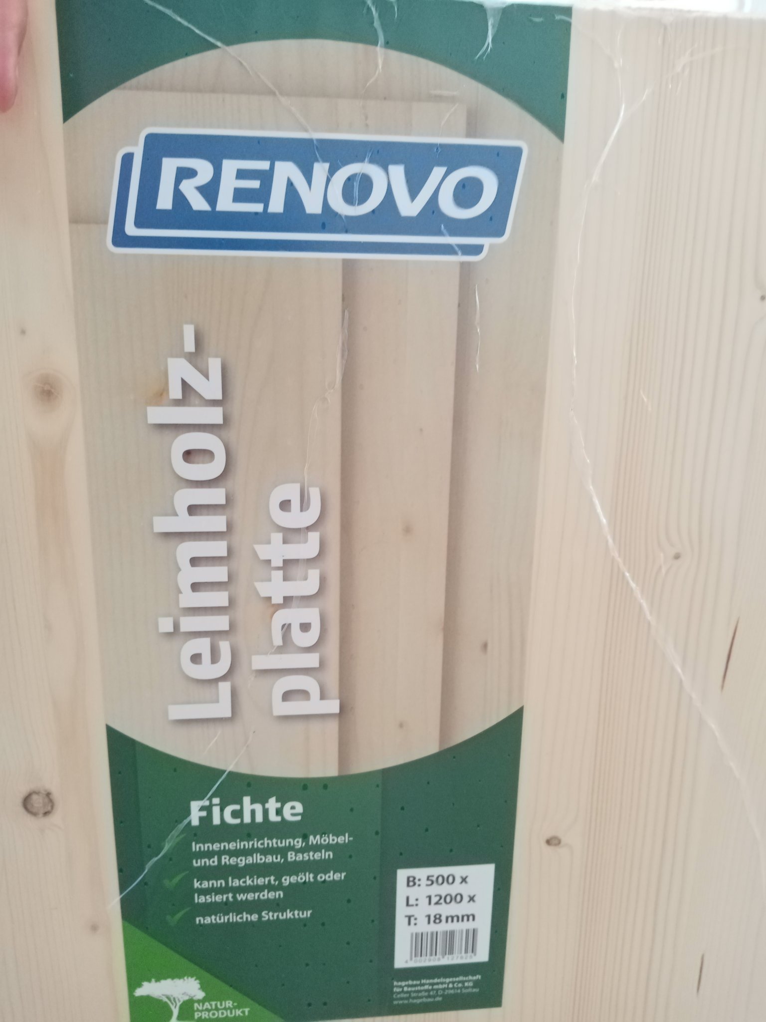

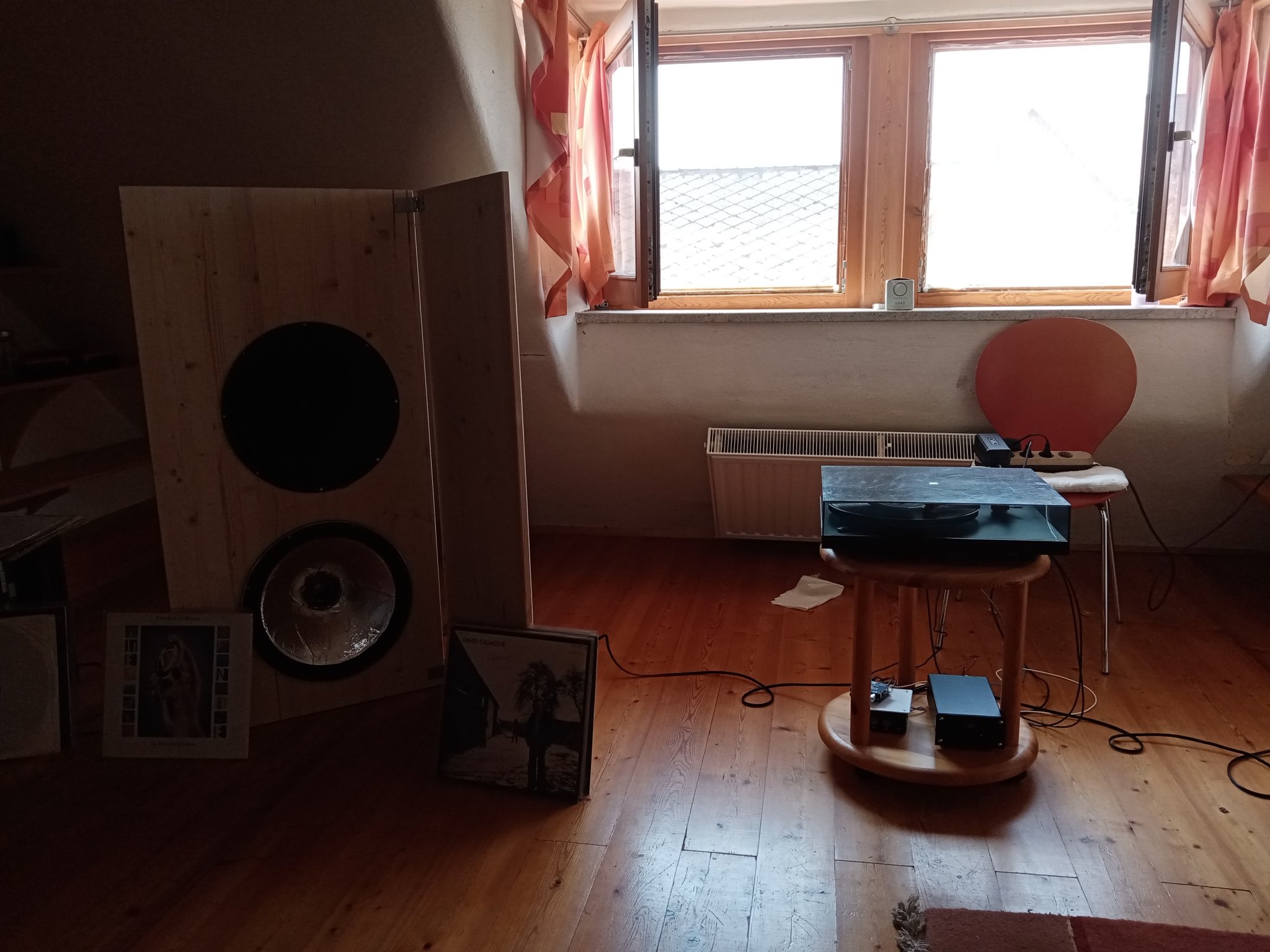

I decided to try open baffle with them.
Two boards 120x60 and 120x50cm
Will put two together with hinges. So I can angle one of them to boost certain frequencies. You can see that here.
Maybe I will add two 38cm bass drivers with some inductivity in series.

Fane 15 300tc in open baffle project and added bass with Alu foil without crossover and a movable sideboard for equalizing middle tones and bass.

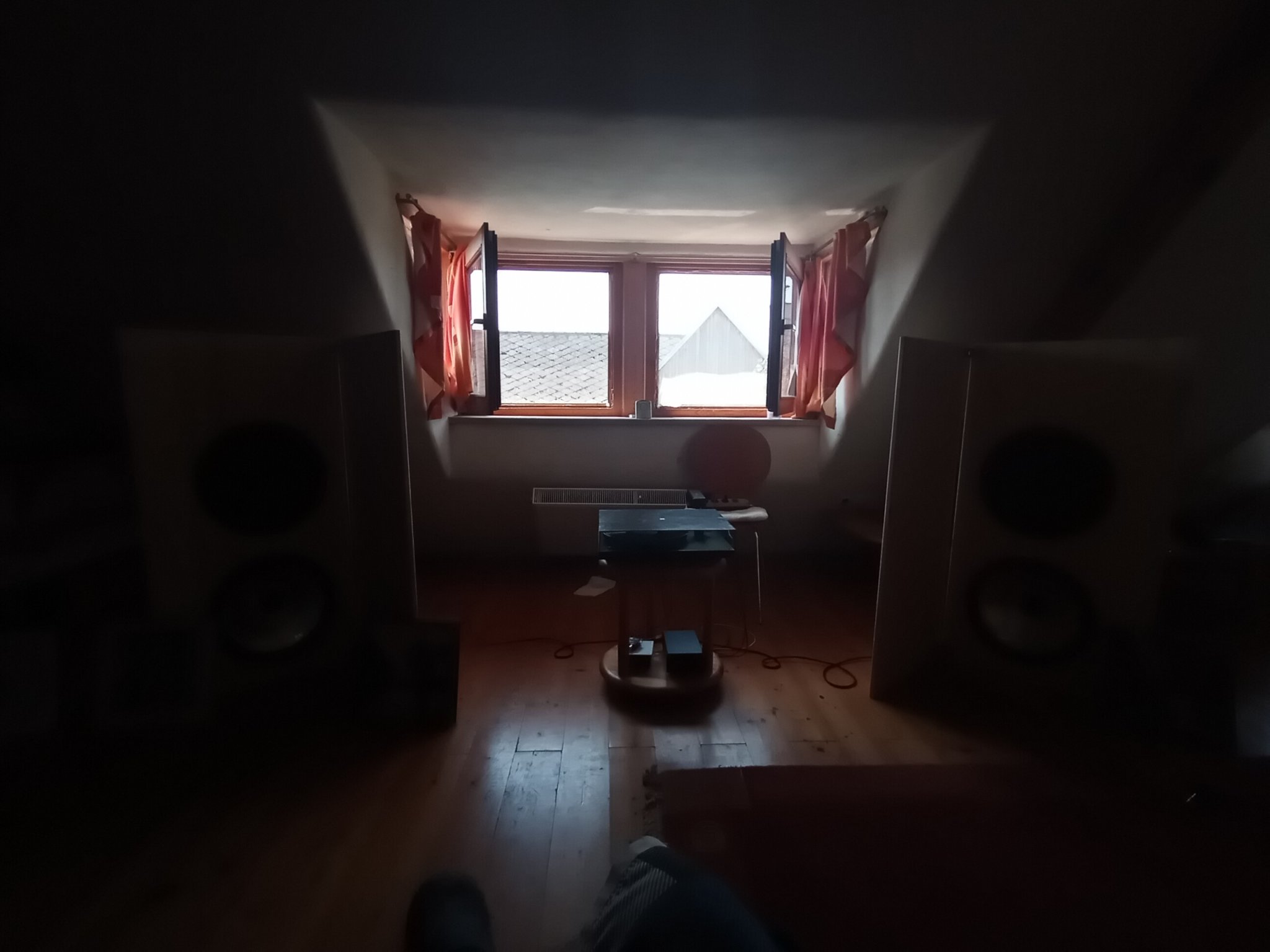

Now listening. Bass will get some inductivity.

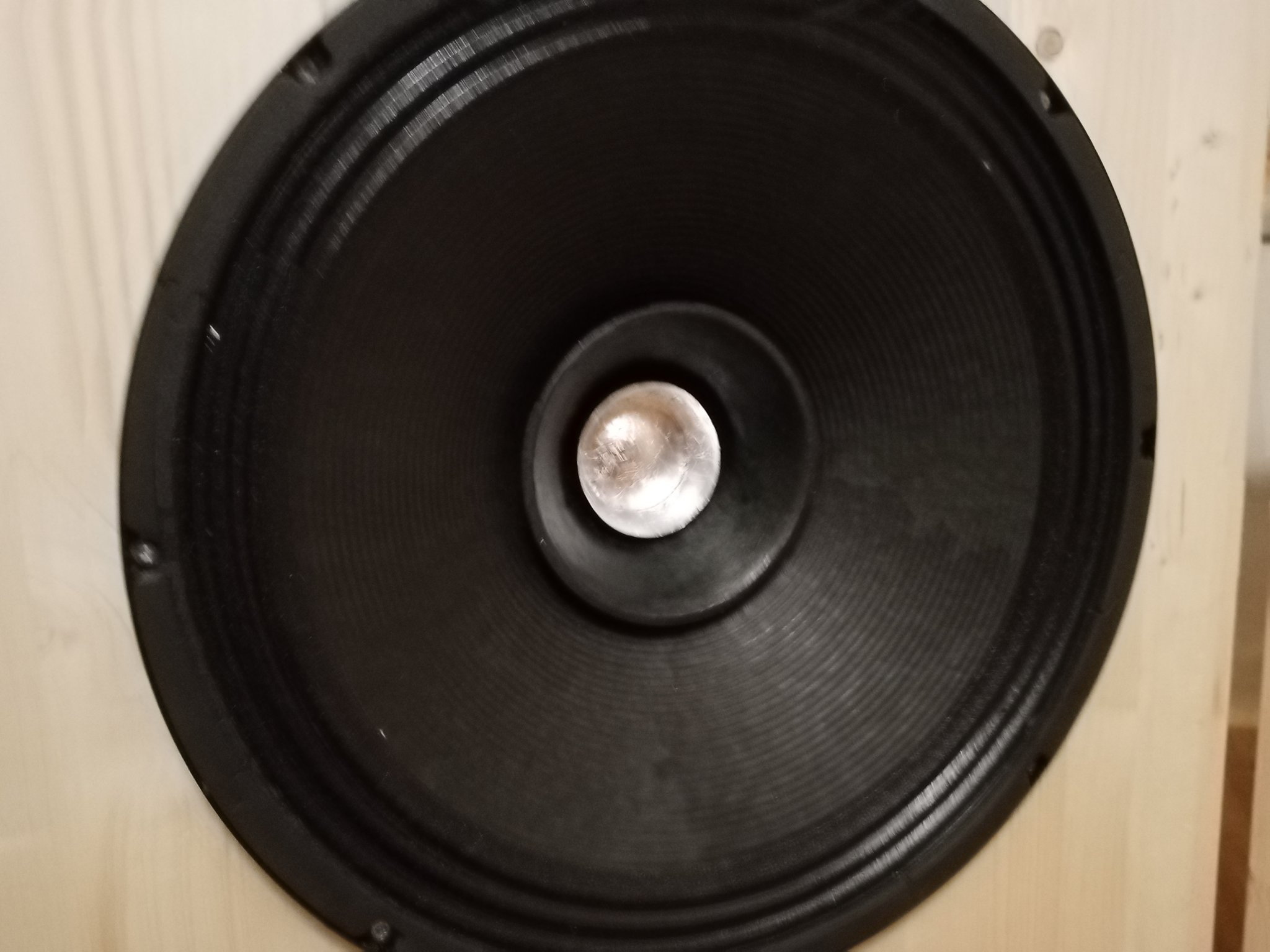

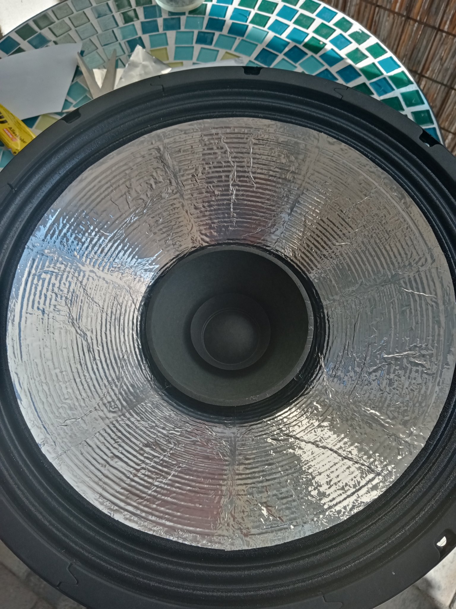

The Fane will be aluminized. Can't listen without on the long run.

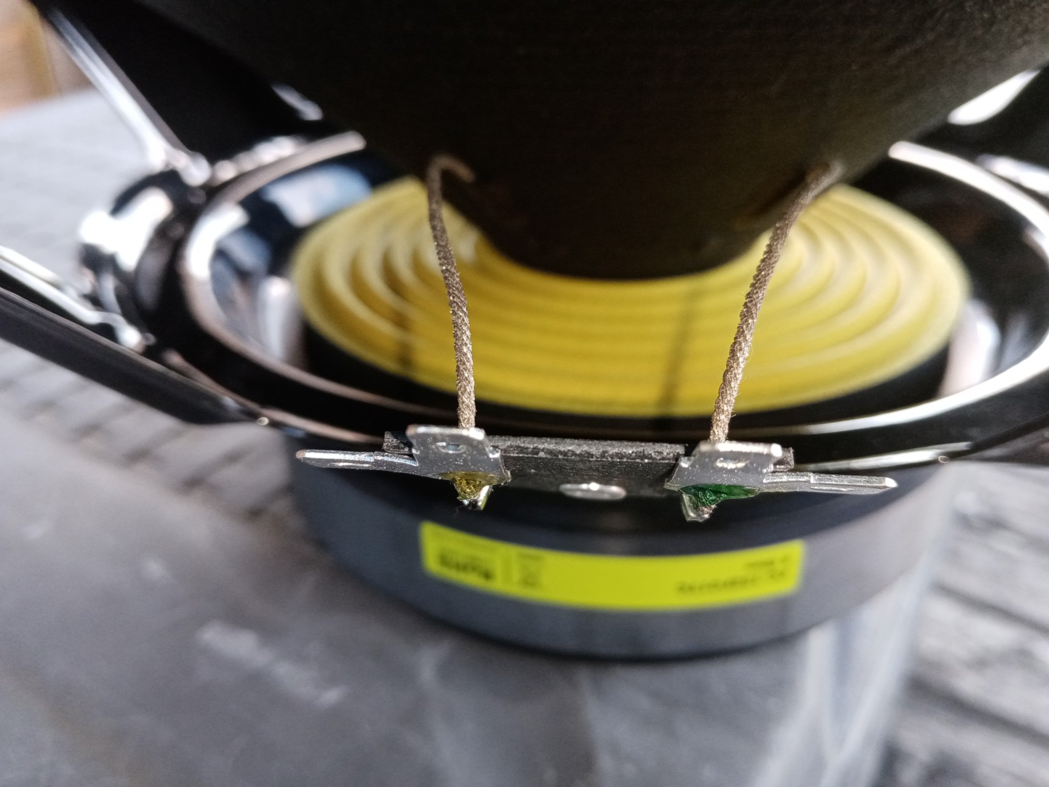

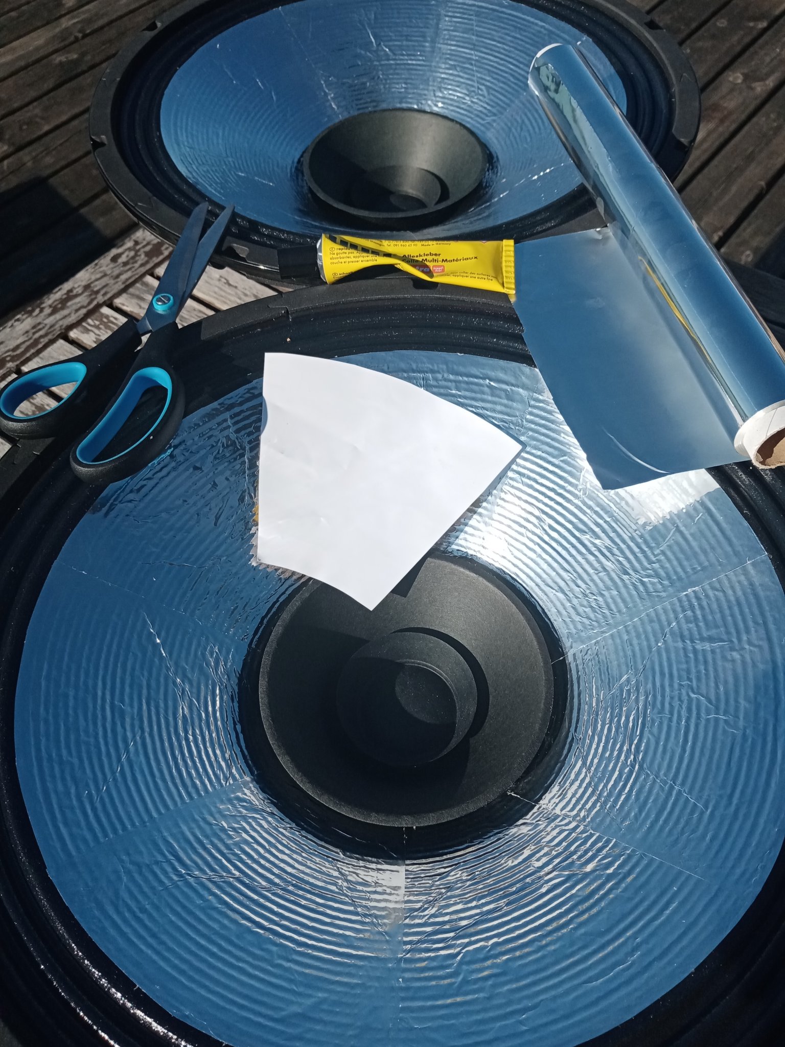

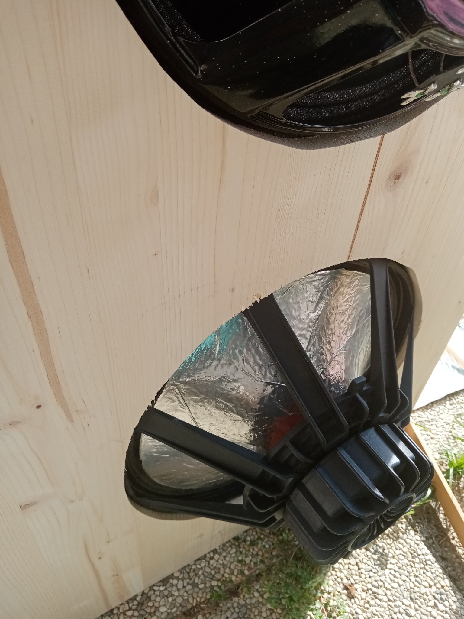

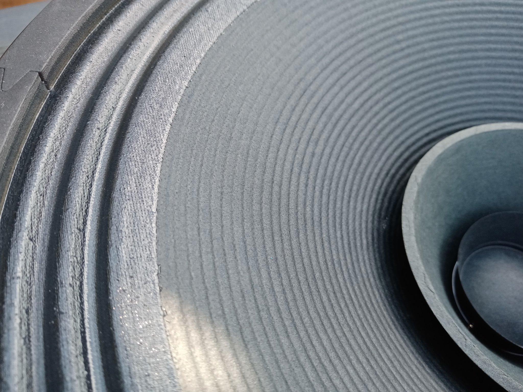

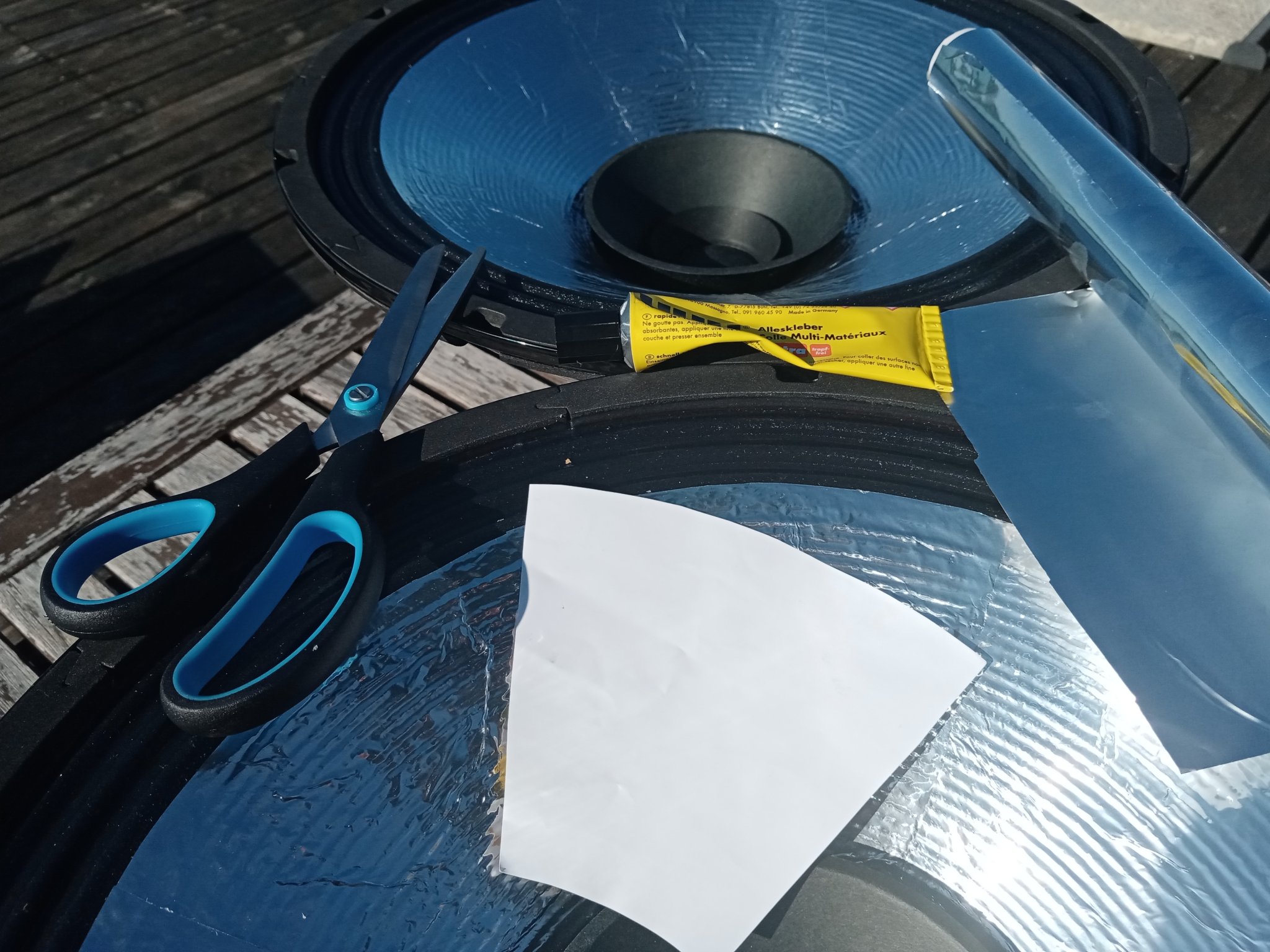

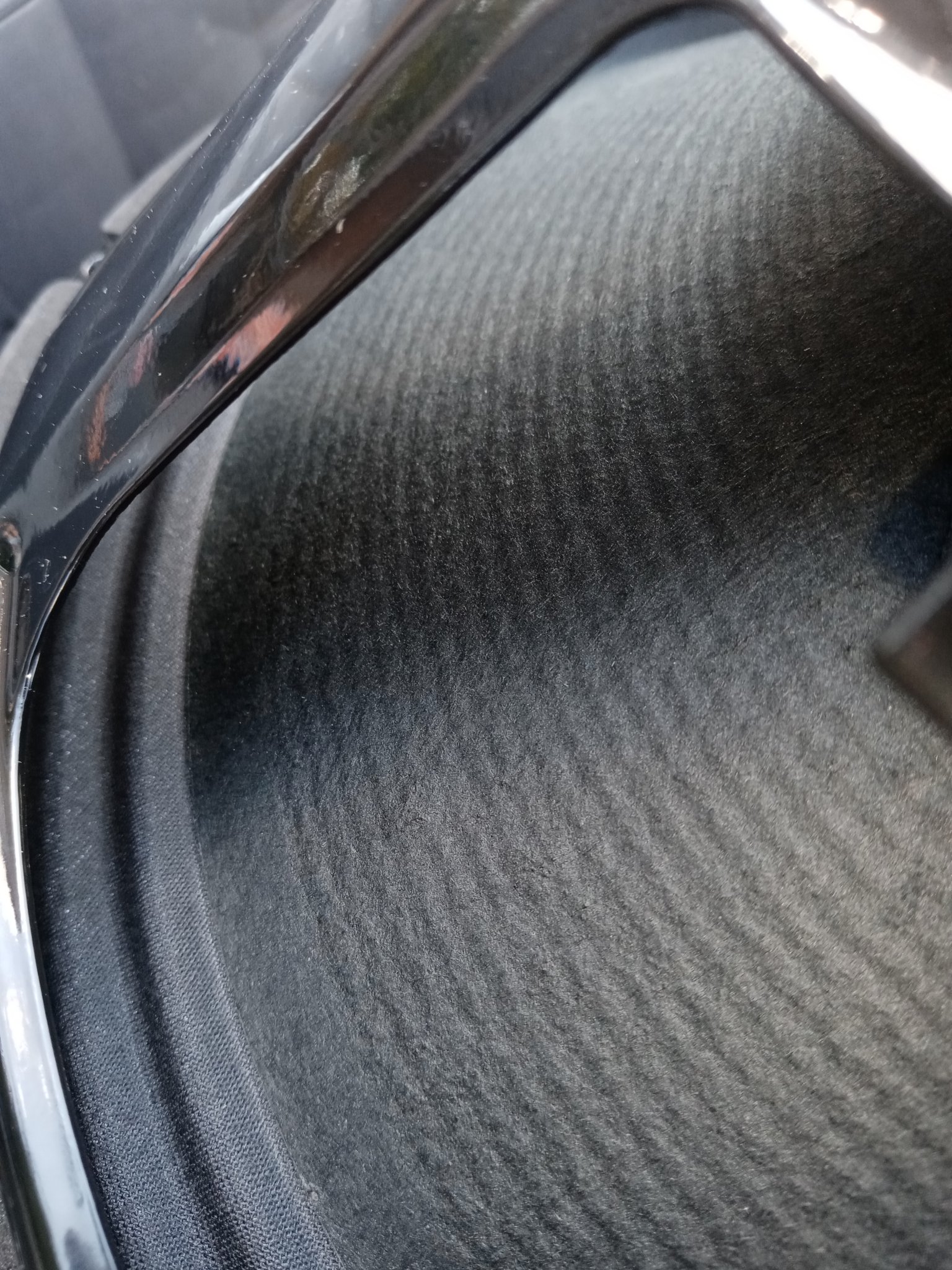

Fane Sovereign 15 inch with aluminium foil
https://www.diyaudio.com/community/...loudspeaker-sandwich-cone.402917/post-7455936
The whizzer cones will be aluminized, too.
The bigger one with household foil the smaller one with thin foil from the goldsmith

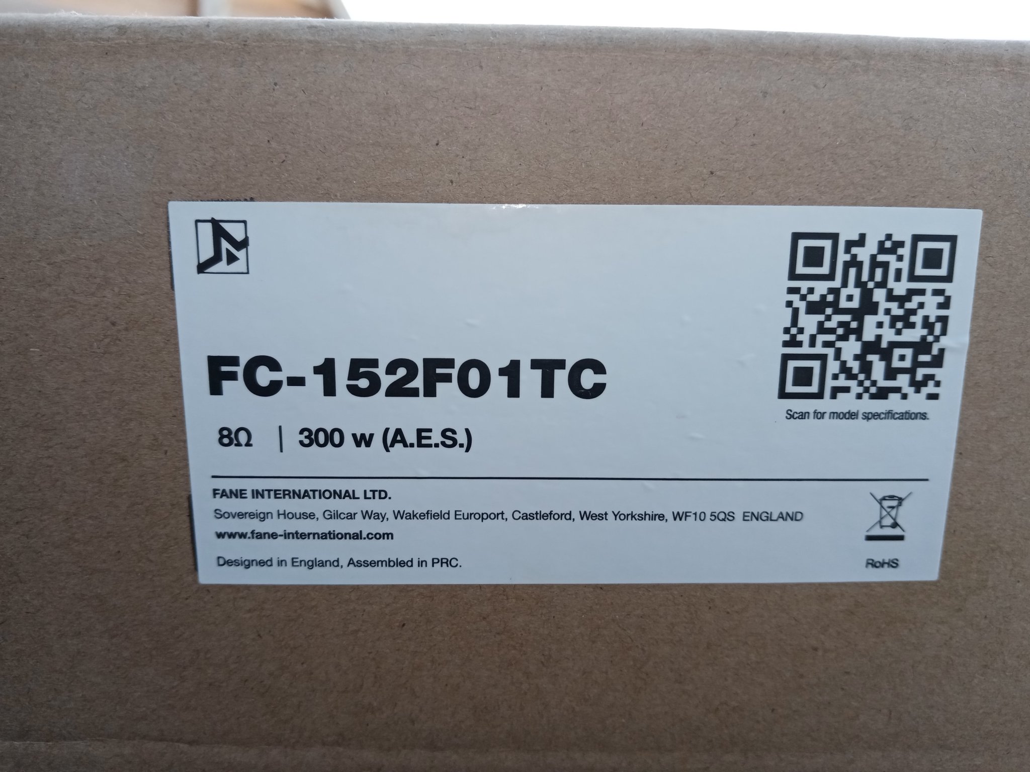

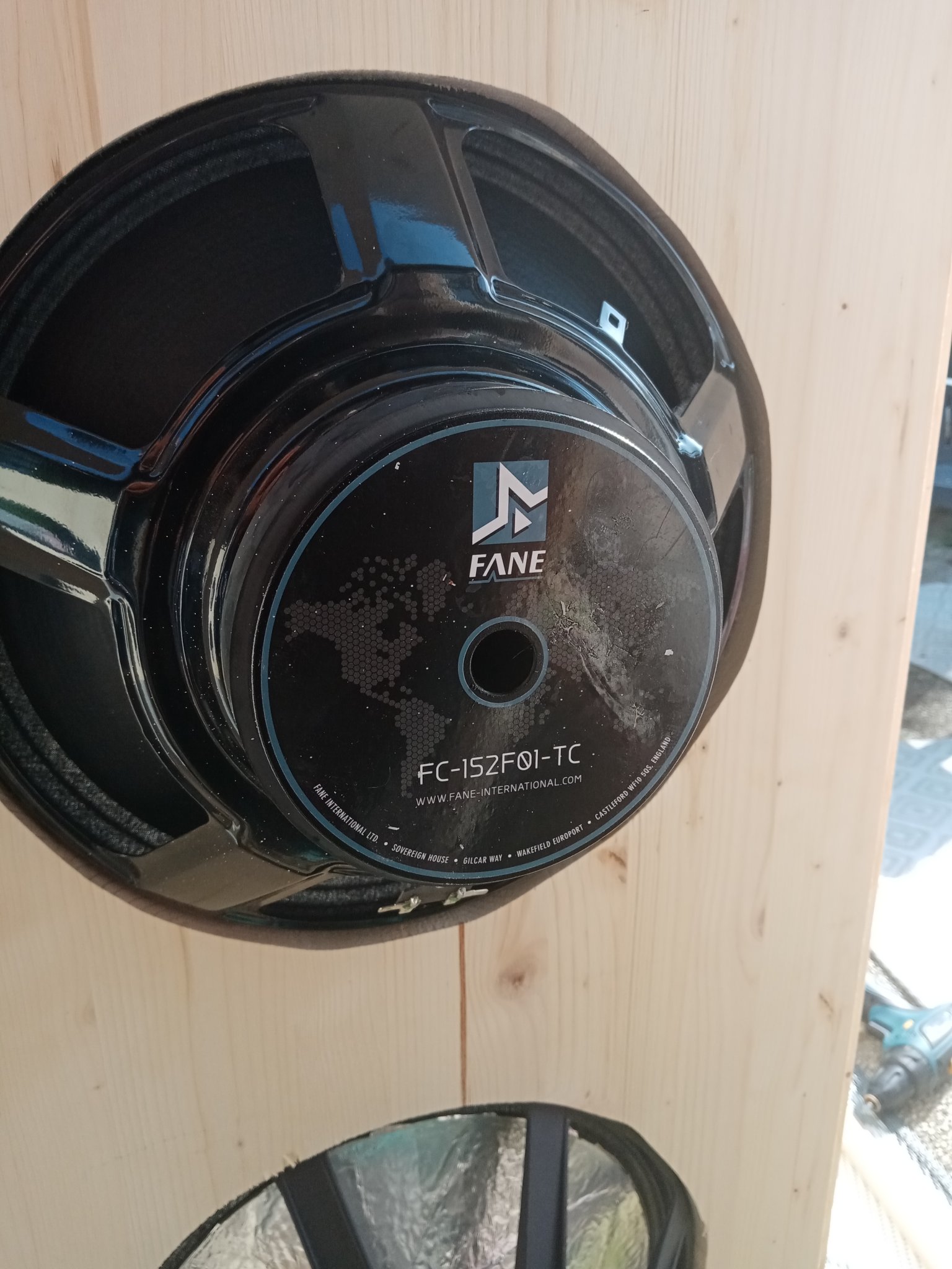

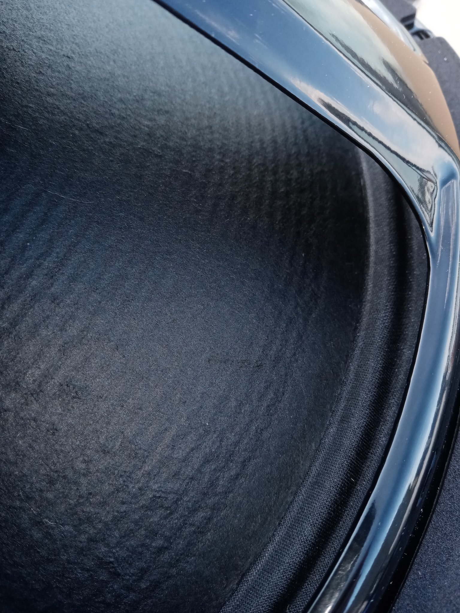

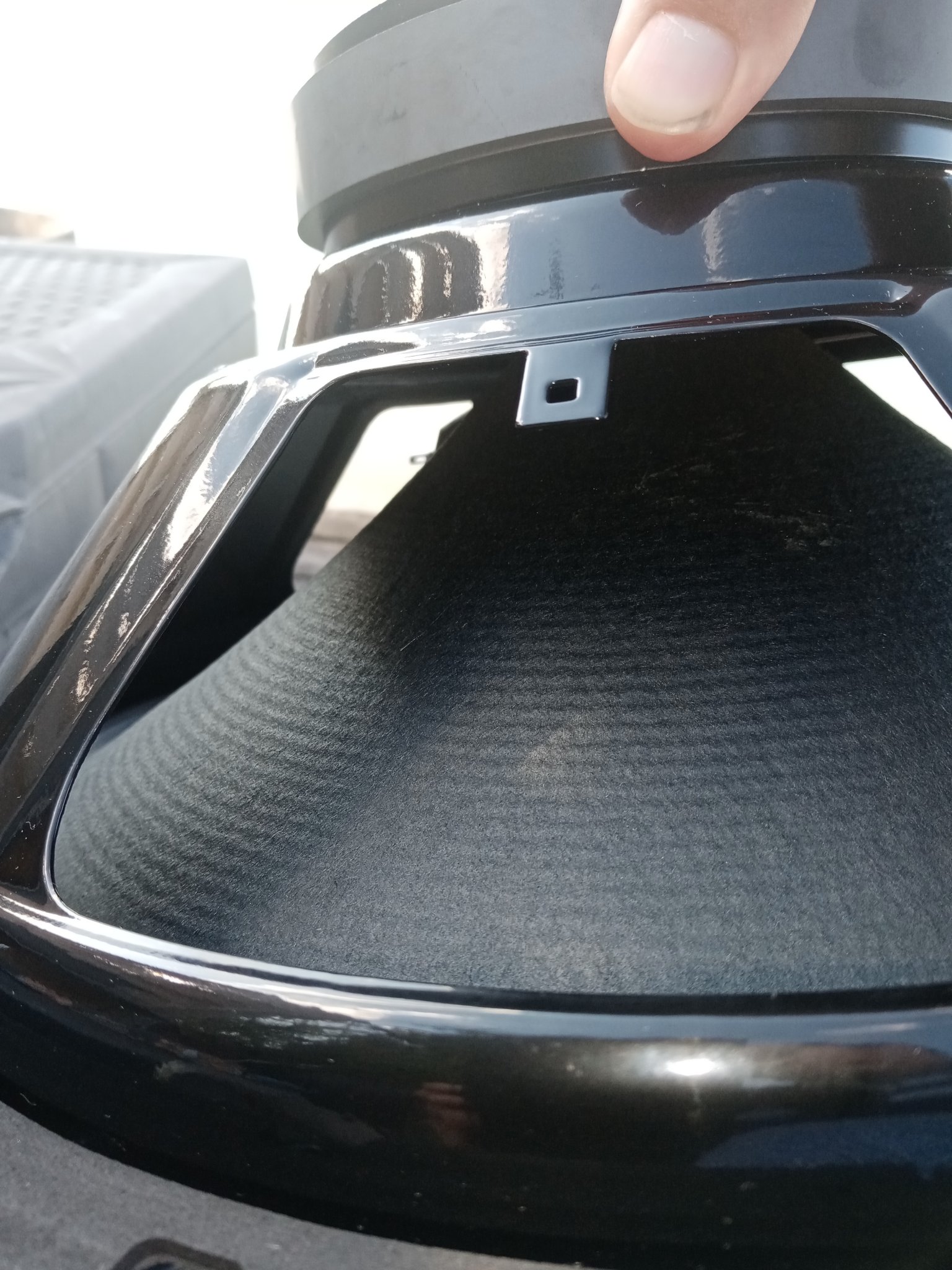

Unpacking / unboxing Fane Sovereign 15-300tc aka FC-152F01-TC

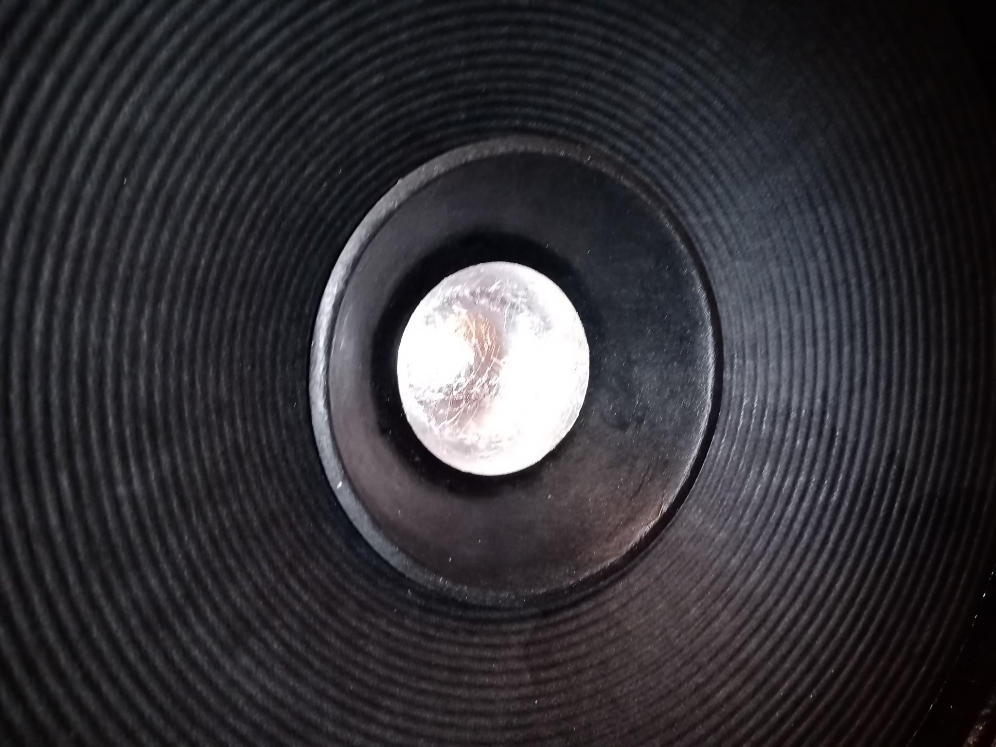

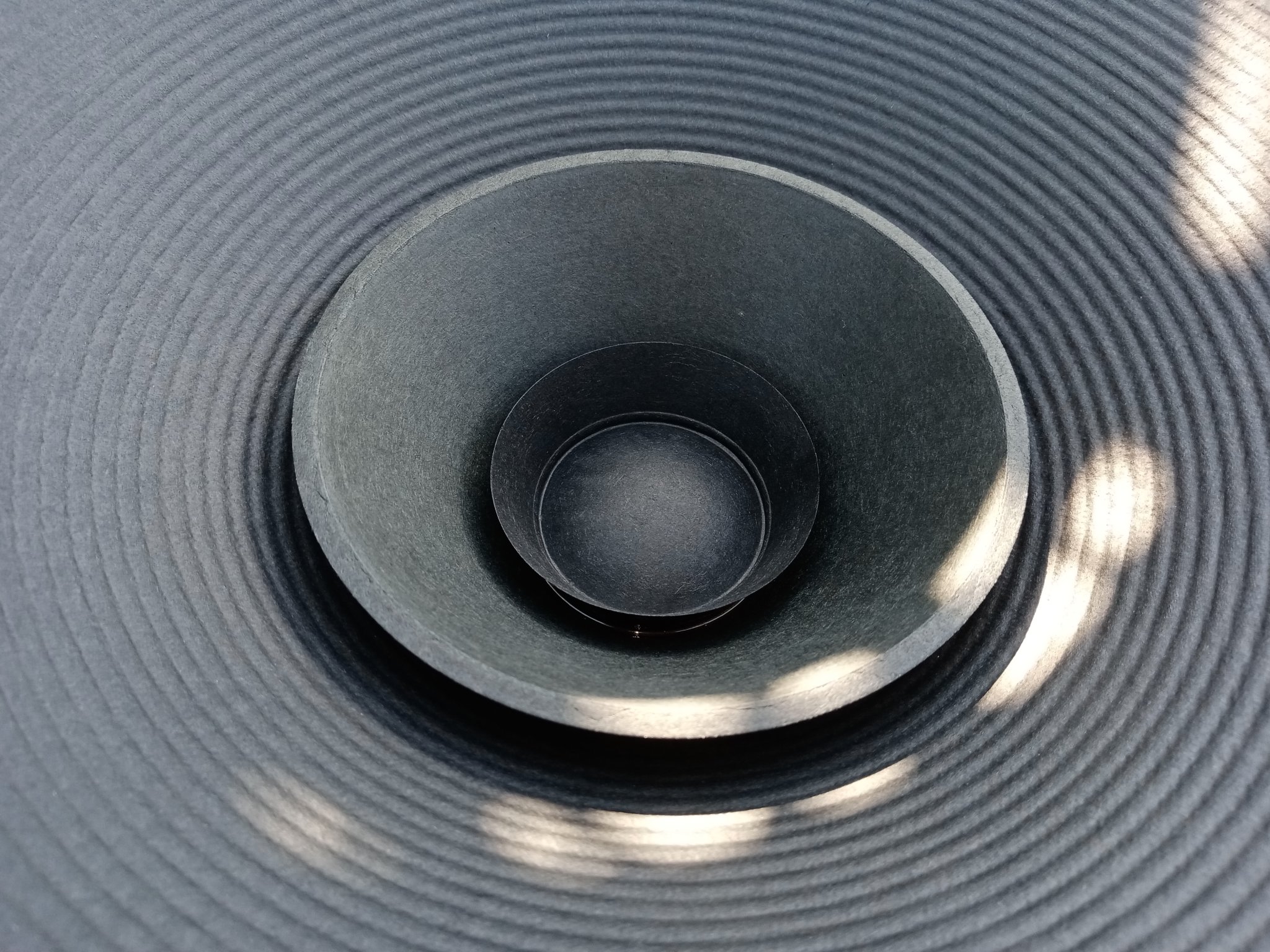

Small whizzer cone with thin alu foil covered
https://www.diyaudio.com/community/...loudspeaker-sandwich-cone.402917/post-7459180
Now listened to the big Fane with aluminized small whizzer cone:
Just with only this treatment (not aluminizing all surfaces) the sound from the 15-300tc driver becomes more convincing.
As the high frequencies become more articulate everything profits from these better transients. The sliding guitar on Ry Cooders Paris Texas album sounds perfect. Amplifier is a small TDA2004 converted to current feedback.
Double Magnet same size for Fane Sovereign 15-300tc aka FC-152F01-TC, approximately + 1.5db to be expected. 18€ per Magnet y35 quality from Magnet Max germany
