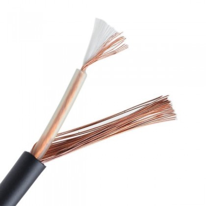

so i might as well use this kind (signal in the middle, shield for return):
or this kind (one lead for signal, one for return)
...and there'll be no difference. also the gauge won't really matter. did i get that right?

Yes, you got it!
Looks fine.
I'm sure that would work too, although you may not need the braided shield on the outside. You'll end up either stripping the braided shield off at the end, or the time consuming task of un-braiding it (toothpic and magnifying glass), then joining it together with the ground inside the cable. You only need two, not three wires for RCA.
My opinion is that smaller is better. I say this with the realization that it's possible that you or I may not even be able to hear the difference.
