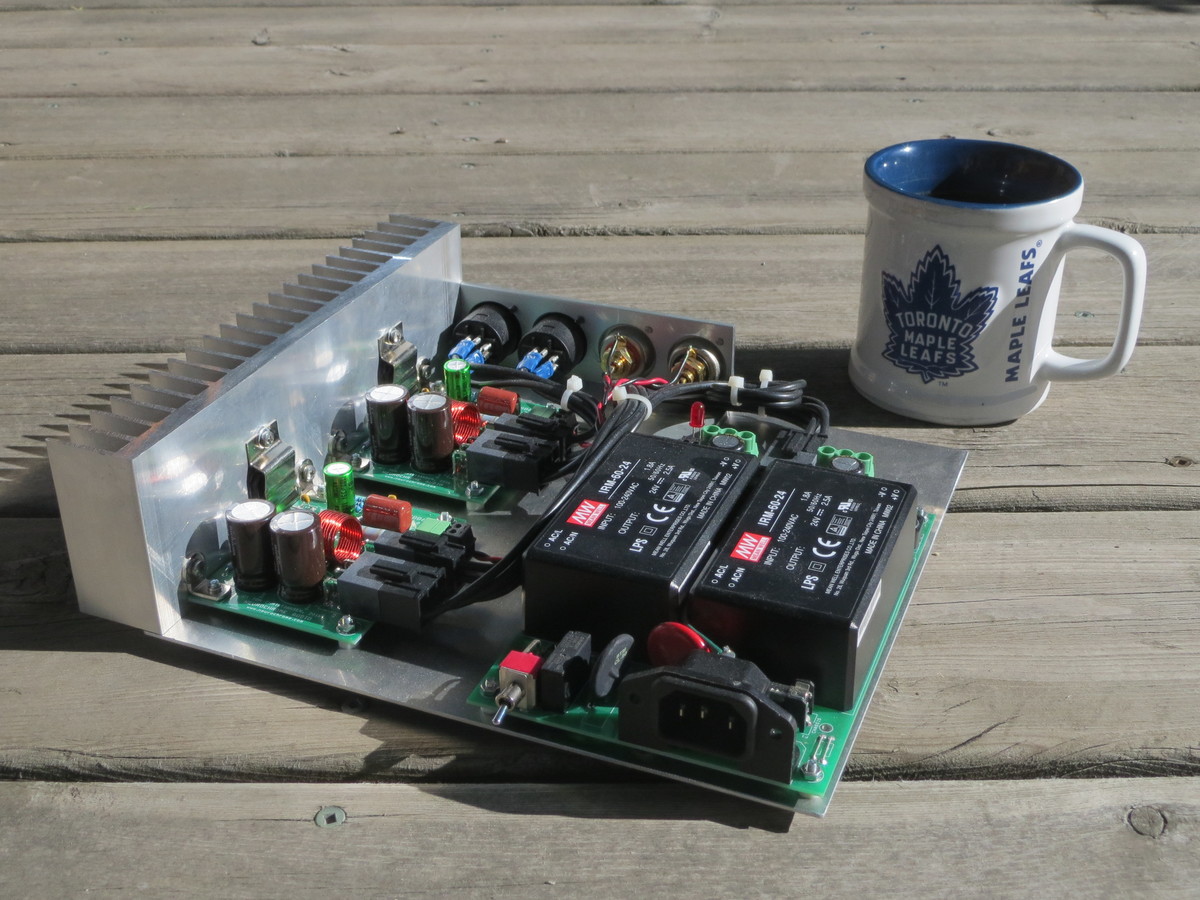

Earlier, I mentioned a prototype build that I showed off at the Vancouver DIY Fest in 2016. Attached picture shows the amp enjoying the morning sun (and eyeing my morning coffee!). I put the amp together in an hour or two as I wanted to demo it at the DIY Fest. In blatant violation of my own recommendations, I run the grounding wire all the way down the supply before it meets the "chassis".
The amp works just fine. I'm not able to detect any appreciable RF interference. It could be that my RF environment is cleaner than yours, but then again, your build is a lot cleaner than mine.

Earlier, I mentioned a prototype build that I showed off at the Vancouver DIY Fest in 2016. Attached picture shows the amp enjoying the morning sun (and eyeing my morning coffee!). I put the amp together in an hour or two as I wanted to demo it at the DIY Fest. In blatant violation of my own recommendations, I run the grounding wire all the way down the supply before it meets the "chassis".Tom
