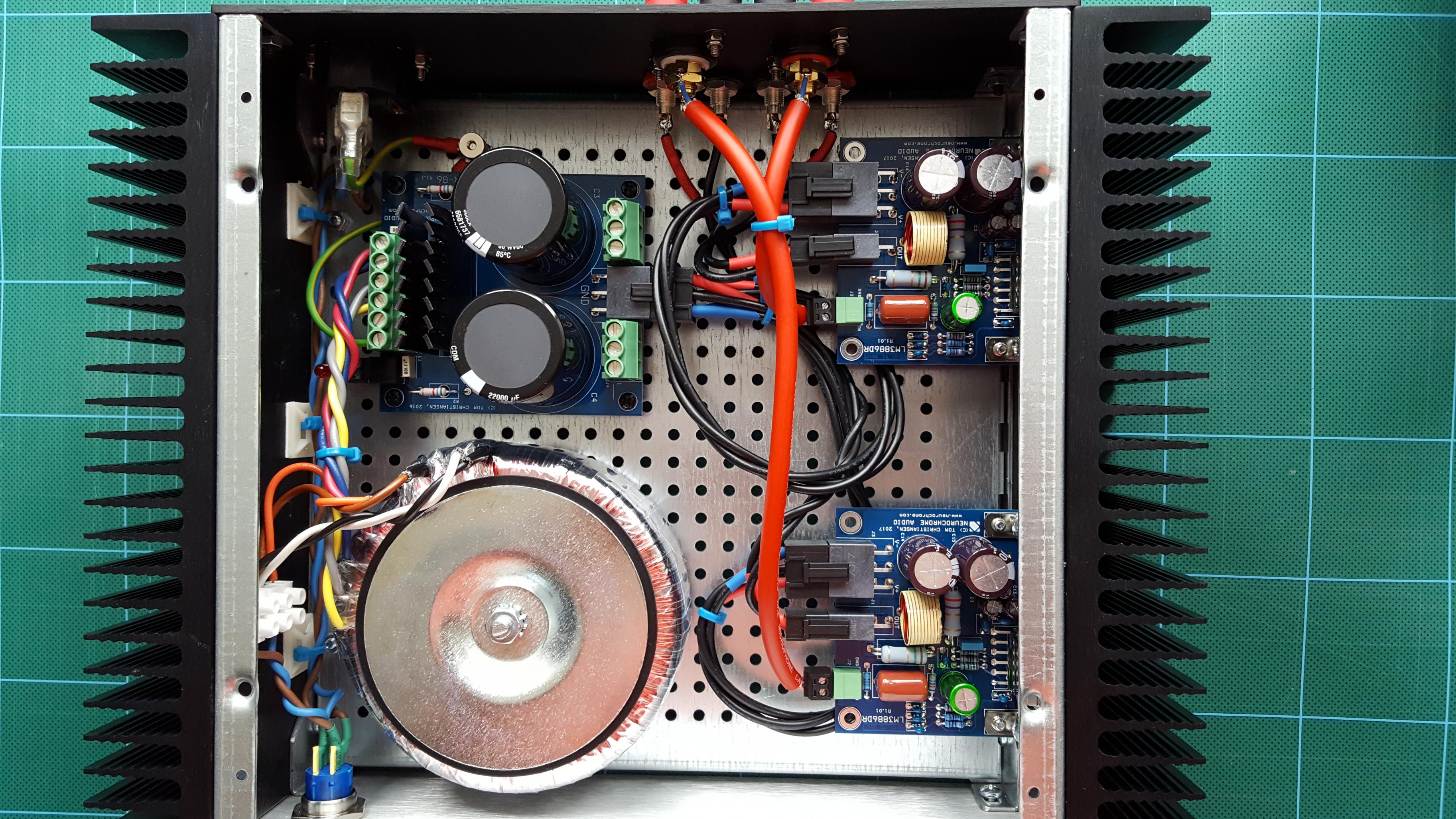

Just wanted to give a quick update on my progress...
The LM3886DR boards came together very easily and then it was on to putting it all into the chassis. I'm a bit of a "neat-freak" so want this to look good (internally as well as externally) as well as sound good. Lots of planning and this is what I've ended up with (see picture).
The CD cables between the Power-86 and LM3886DR are a bit long, so I may redo those, but other than that, I'm quite pleased at how it has come together. Other than testing, the only remaining chassis job is routing a bit of fibre optic from the Power-86 LED to the front panel.
At this stage, I've powered up the Power-86 and checked voltages but haven't yet applied power to the whole amplifier. I've cobbled together a light-bulb tester for the initial tests, just in case.
Oh, and the hum from the torroid is much smaller now it is screwed down in the chassis, so that's a relief.
Fingers crossed for the moment of truth. Too busy today though so it will be in a few days time...

You have two chips on one heatsink and none on the other?
Yep, see planning discussion earlier in the thread (starting at post #308). It certainly would have been more symmetrical to have one chip on each side, but laying the chassis out as I have done keeps all of the AC power tightly down the left hand side of the chassis, away from the signals.
I should stress that this is just my thought process - I'm a novice at this type of thing. It remains to see whether it all works!
