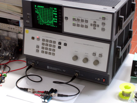

The spectrum/network analyser was built late '90ies by the reputed german measurement equipment company Wandel & Goltermann.
The model is SNA-2, the second model in their range which adds phase measurement capability to the earlier SNA-1. Frequency range is 100Hz...180MHz which is just perfect for audio use.
Sitting on my bench it looks like this (note that it is comprised of two really heavy 19" die-cast aluminum boxes packed with electronics to last cubic inch) :

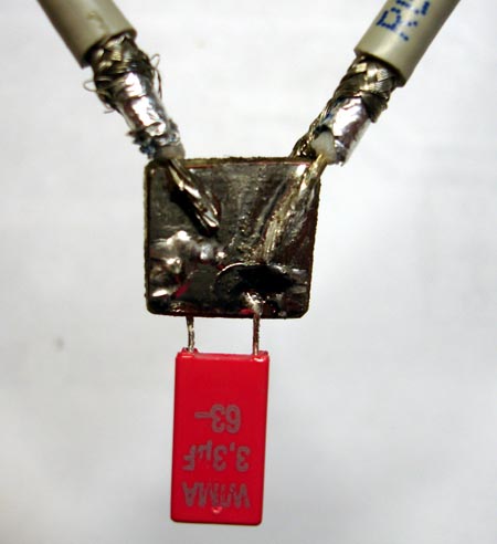

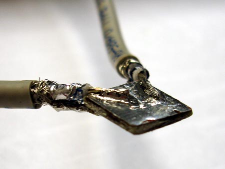

The little test jig I made for capacitor etc measurement :
A short coaxial cable was cut in the middle and a tiny double-size blank PCB was soldered in between, forming a tiny capacitor (a few pF at most).
One end of the coax was fed by the tracking generator of the analyser while the other end goes directly to the receiver input. System impedance is 75R. When a DUT (Device Under Test) is low impedance, fractions of an ohm typically compared to the system impedance this forms a constant current source and the voltage seen at the output is proportional to impedance of the DUT.

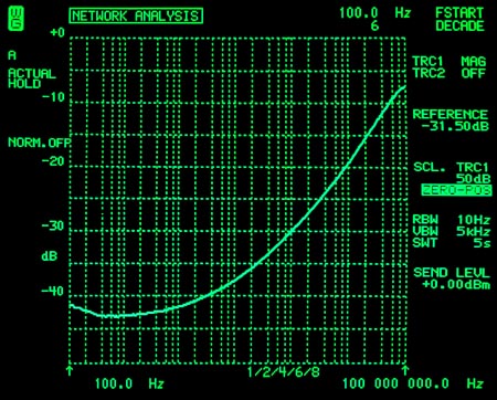

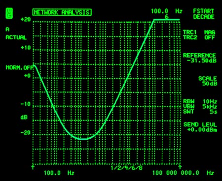

Plotting the transfer function of the jig alone looks like this :
We can see a pretty perfect line at 0dB with a slight roll-off at the highest frequencies (above 40MHz) coming from the tiny capacitance mentionened and other high-freq effect in the measurement chain. Horizontal scale is ranging 6 decades from 100Hz to 100MHz, in 1-2-4-8 increments for the grid lines (as indicated). This setting is kept for the rest of todays measurements.

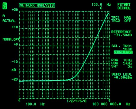

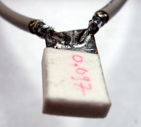

Using a 0.1R resistor as a reference to adjust vertical dB scale to read in dB ref. 1 Ohm :
Resulting impedance plot after adjusting the reference level (which just shifts the plot) :
Now 0dB=1R, -10dB=0.32R, -20dB=0.1R, -30dB=32mR and so forth. Likewise, positive 10dB step give 1/3.32/10/... values.
The 0.1R wirewound is inductive as seen from it's constant slope from 400kHz upwards, the inductance can be calculated from |Z|=2*pi*f*L, hence L=|Z|/(2*pi*f). Reading 1R (0dB) from the plot at 8MHz we get 20nH.

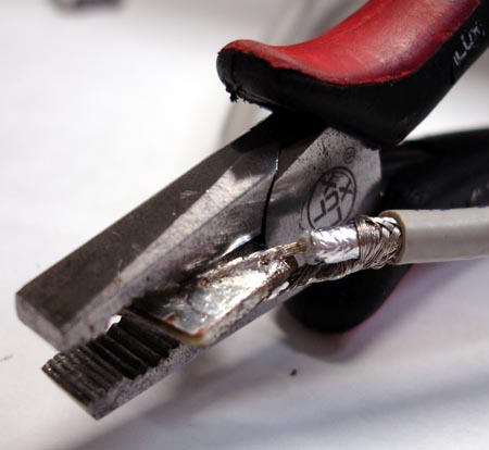

In order to figure out the "baseline inductance" I tried shorting the jig with pliers as close as possible to the cables and using a lot of pressure to get a low shorting resistance :

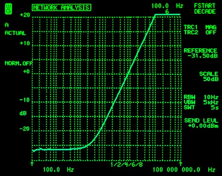

The according plot looks interesting :
There is an inductive rise again above the <10mR of shorting resistance, coming from the residual path around the PCB edges through the pliers, but the inductance doesn't seem proper in the region where it starts to emerge and it doesn't reach the 20dB/decade slope, only a little more than 10dB/decade. My educated guess is that we see the result from eddy current losses and/or the magnetic properties of the steel pliers (need to investigate that further, with a copper short things looks quite different -- perfectly inductive -- from earlier tests I made on another jig).

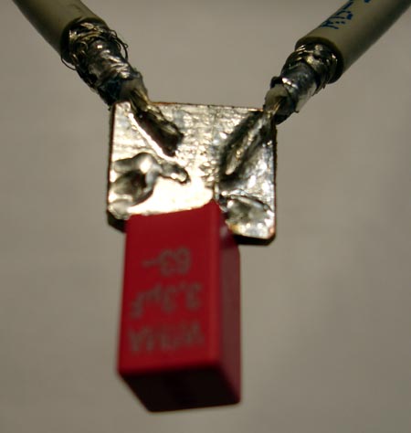

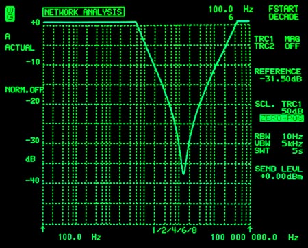

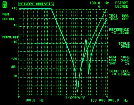

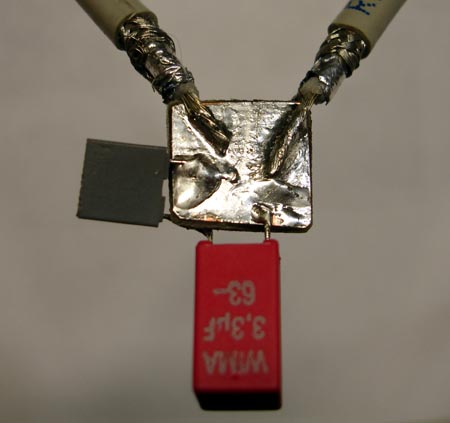

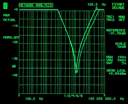

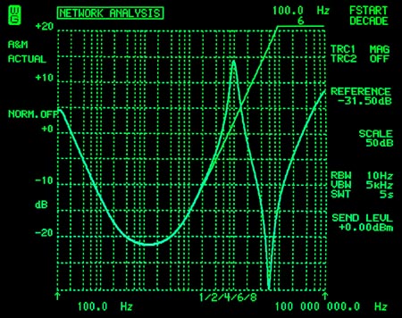

Let's add a bit of lead length to the 3.3uF capacitor :
The result on impedance in comparison to the previous one (overlayed):
Inductance kicks in earlier (notch shifted to the left) and is about 5dB higher -- which is about twice the original value of the cap intrinsic inductance when flush-fitted to the PCB edge.
This demonstrates the capapilities of a network analyser in an impressive way. Add a mm of lead length and you'll see it instantly!
Capacitance reads as before, calculating from the falling slope via |Z|=1/(2*pi*f*C) we get find C=1/(2*pi*f*|Z|). In this case we read 0.32R @ ~180kHz ==> 2.8uF. That's "close enough" to 3.3uF, from the eyeballing employed.

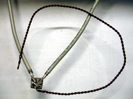

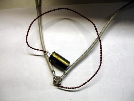

A 33cm (1ft.) lenght of shorted twisted pair using thin hookup wire was attached to the jig :
Impedance came out much worse than expected :
Resistance is about 50mR but most important is the inductive rise, calculating to about 200nH!

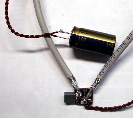

Adding a local 150nF film bypass :
Impedance plot... well, we've seen that kind of disaster before :
Clearly not a way to wire for example a chip amp supply, not even for temporary testing. Tomorrow (hopefully) I'll try show a better way, striving for a reasonably low and flat impedance with a remote main cap bank and a mimimum of local bypassing...
Note that tight twisting reduces magnetic field pickup (as used for heater wiring and to reduce inductive coupling) but does not much affect the inductance of a shorted transmission line. Twisting is of course much better than not twisting, but the twist length is immaterial provided that it is short enough to keep the two wires next to each other. In fact tight twisting could make things slightly worse by lengthening the electrical length of the cable when compared with the physical length.
