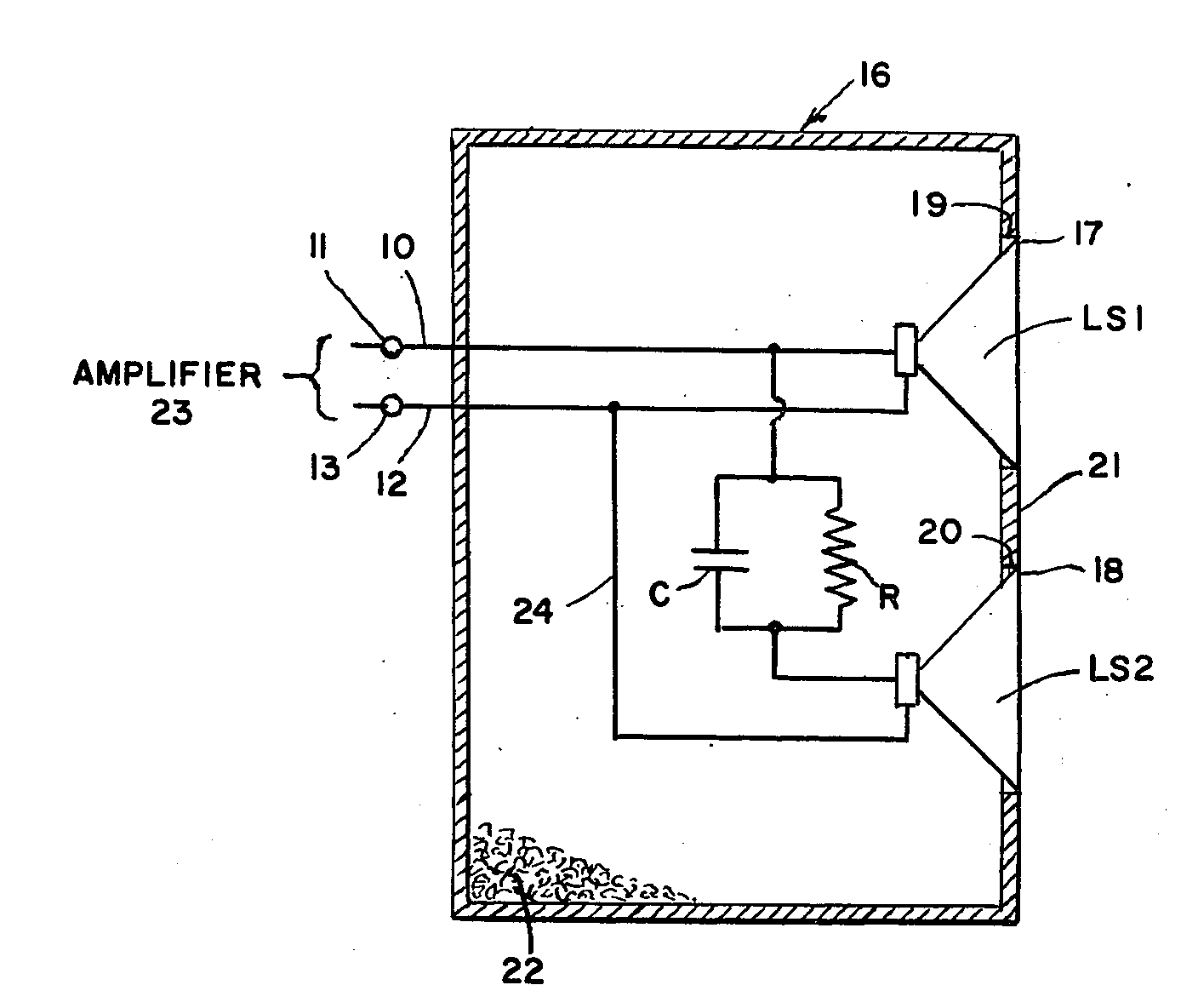

I'm very curious about the so called "Nestorovic woofer system" , a bass alignement solution used in some late seventies Speakerlab kits, and in the Nestorovic own brand models.
The sketch is from the patent site, but I'm not registered, so not able to take a look to the complete documentation.
I intend that it uses two different diameter, different parameter woofers, that share the same closed box volume. There is some aditional trick in the passive circuit that connects the compound to the power amp.
Had someone actually experienced / measured this sort of thing?
Any idea on how it actually works?, also is this just for megacurrent SS power amps, or is suitable for tube amps as well?

I used to build these things for Mille', so I can provide some help. Unfortunately I am pressed for time and must go archive digging to come up with crossover information. You have the basic idea correct. The two drivers can be of the same or different diameters but must have quite different free air resonant points. The crossover then provides that the lower frequency resonance driver is rolled off with a huge bank of capacitors and becomes an ultra low frequency passive radiator that couples it's mass to the driven unit and alters the response of both. More in a couple of days, though we will have to figure out the needed parameters by trial and error because Mile did not share his knowledge even with those who worked for him. We were left to implement the "teorey" with only minimal guidance. All part of his training regimen.

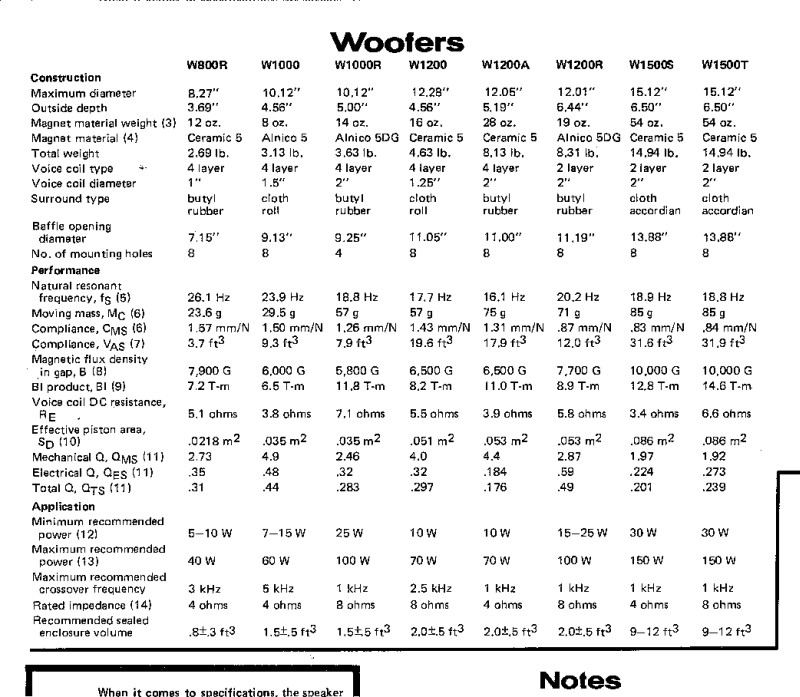

Hi, in the old Speakerlab kits leaflet they published the TS parameters of their
drive units, including those used in the Nestorovic system. Maybe some reverse
engineering will be possible. I think I've got one of these somewhere in the attic, hope I can found it.

some data
Speakerlab - Catalog 1980
Though can't swear about, I believe the drivers used in the S30 for a Nestorovic alignement, were the W800R and the W1000R.
I have a pair of S30's and have drawn the crossover which also includes the Speakerlab driver model numbers. Enjoy.

Looks as if they had some serious SS power in mind, otherwise they would not allow such varying impedance.
Certainly an inspiring design to me.
What I like is the ultra low Fs and vas ~300L, even if Fs doubles in the closed box, it again will be low enough.
This design looks like a serious evolution of "A Cabinet of Reduced Size" by E. J. Jordan http://www.ejjordan.co.uk/PDFs/A-Cabinet-of-Reduced-Size-with-Better-Low-Frequency-Performance.pdf
However, it seems that the ARU has been substituted by the suspension stiffness over the cone area of the bigger driver. This is the relation between raise of internal pressure and cone motion (mm/n) and also the resisting part (Cms and inertia).
Big difference is that the back wave of one of the drivers is actually contributing to the system SPL.
Another difference is that unlike the ARU calculated target properties of the suspension of the bigger driver can be translated into actual measurable target properties.
Right now, I have placed an order for a pair of custom 15-inch drivers with sub 20 Hz Fs (with unknown commissioning date) for an aperiodic cabinet, but as the cabinet will have replaceable front baffle, I could do some experiments if guided properly. I suppose this would mean that the full electrical equivalent of enclosure and drivers has to be derived - something I am not capable of.
I have on hand some capable 12-inch drivers with properties close to the quoted above for W1200R.
