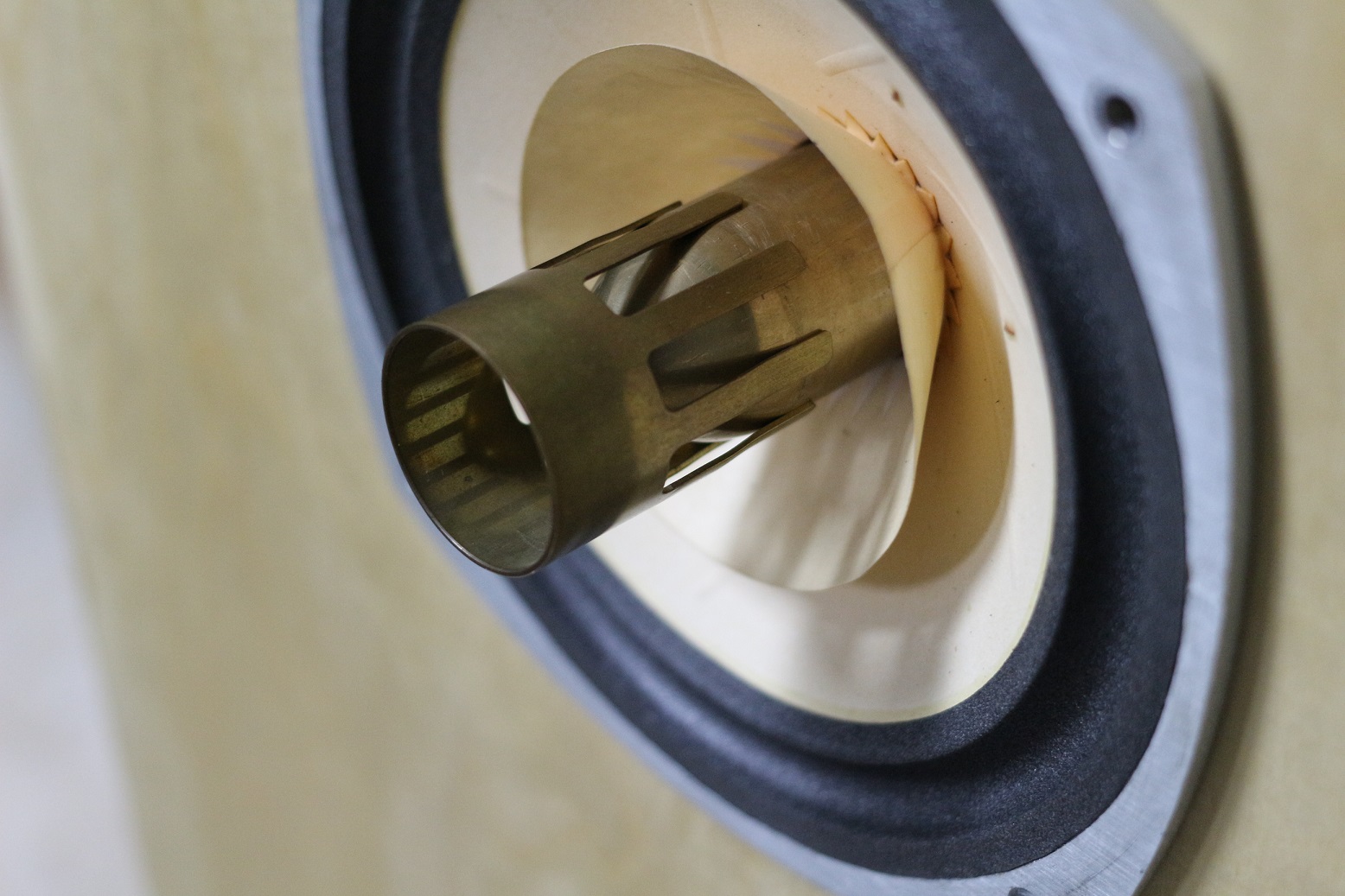

Hi
I am pleased that this thread exists. Although I have not gone through all the posts, I wanted to post my pics. This is AER MD3 driver and Eminence 15' woofer... with Firstwatt B5.
Not the deepest bass but you can enjoy the huge soundstage and transparency in a relatively small size OB.
