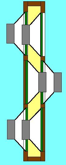

Don't you think that kind of push-pull arragment of speakers could cancel some of their intristic distortions? The only problem is that the slot should be wider like on attached picture. push_pull_slot.JPG

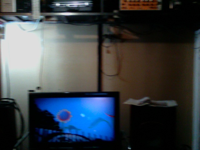

Hi Fokes, I'm looking at this design concept and it looks like a good simple approach to some custom speaker installation I'm looking to integrate into a system I'm building. I figure since there are so many experienced diy'ers around I might capture some suggestions or feedback.
The photo below sketches the basic situation. The wall area involved is 6'x8', below 3' of rack/shelving under a 9'4" ceiling. This area will have a quilted cloth material over 4" rock wool.
Anchored into the left side of the frame will be three 6.5 foot shelves. The top one will be about a foot of space for audio/video rcvrs/players/amps. Below that is 14" space for stereo sub-woof and center channel for surround. The space is about 16" deep. About 26" below that will be a shelf for the stereo monitors a video screen. The room is about 9x10x11 feet wide, with a bay-window shaped wall opposite.
Enough detail. This slot-loaded speaker looks simple enough for my limited shop tools and looks to be simple to tune and modify after the fact.
What I want to know if there are any gotchas to look out for in my situation. I read the first half of this thread and scanned the rest, so I'm not totally in the dark. At this point I would like either build a passive low pass filter and have phase control, or buy some inexpensive active controller.
One idea I have is to build a passive small-signal pass filter/controller before the power amp. Is there any reason not to do this?
Any ideas appreciated ;-)

Nevermind about the small:large signal. I think small signal EQ would give the power amp an easier time.
I left out the details of using a pair of 10" woofers for this, and a 10" coaxial woofer/tweeter for the center channel. At this point I think I'll go with an open baffle for them, with a slot in the woofer baffles.
