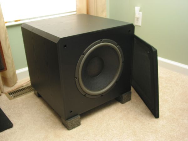

this image i found online i like.. i would like to have my subwoofers look like this. but perhaps instead of a fabric grill, i use a metal mesh one like on my yamaha Ns-1000m speakers.

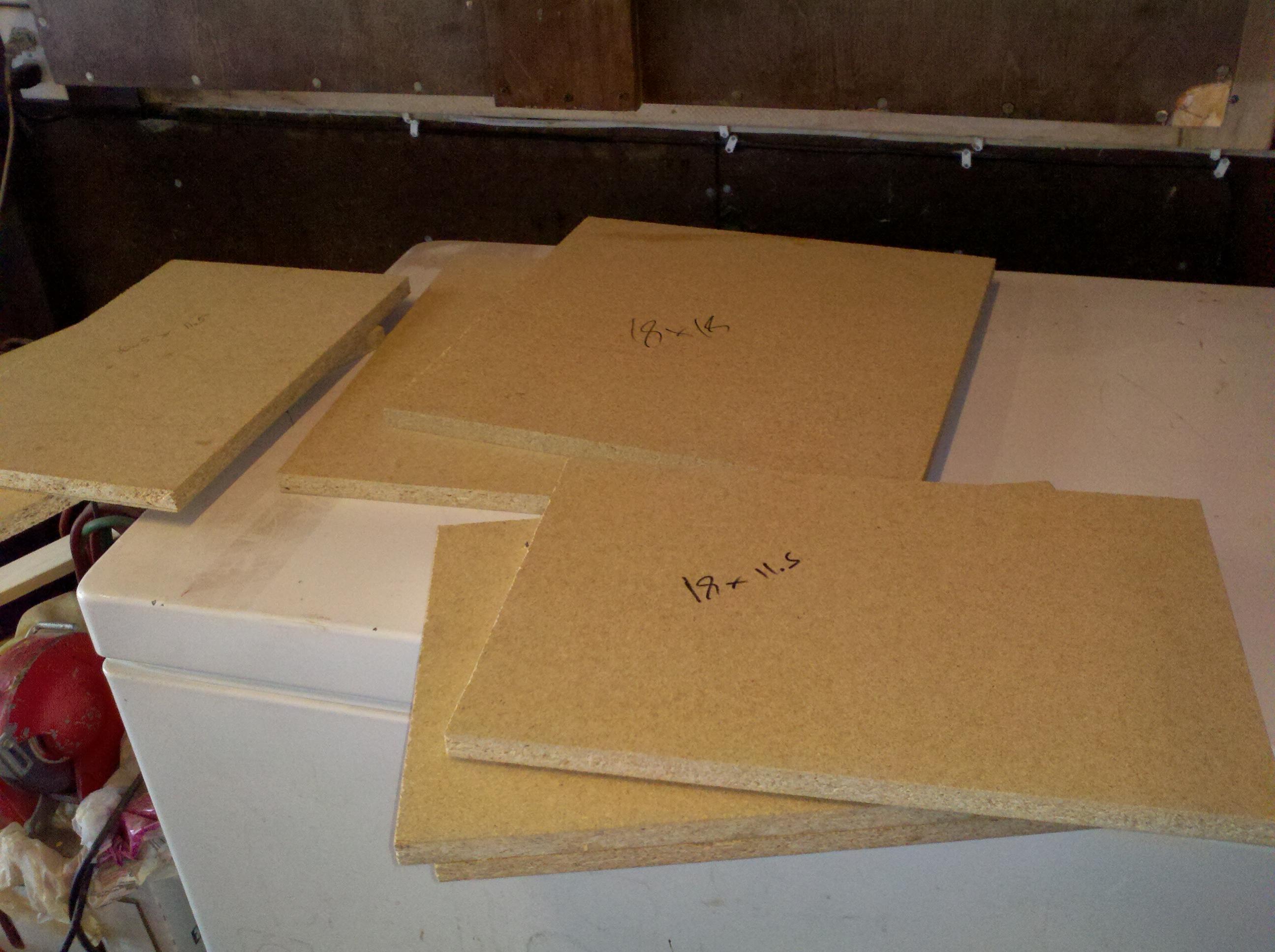

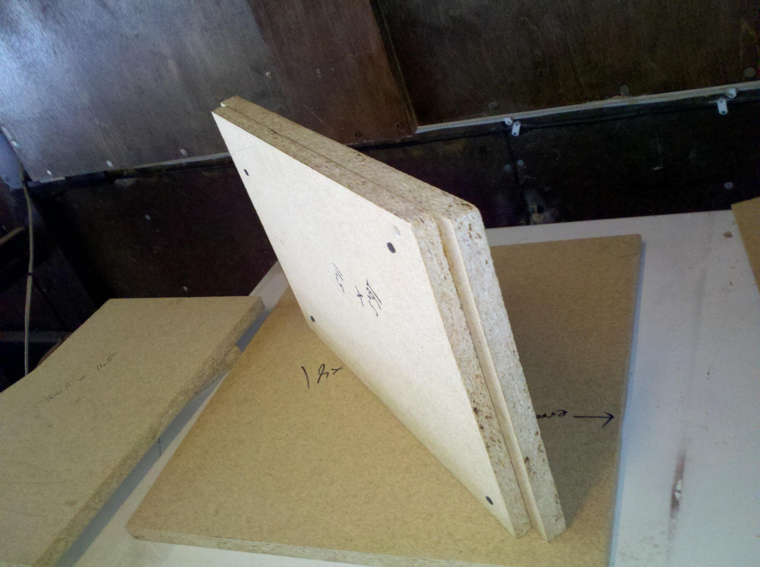

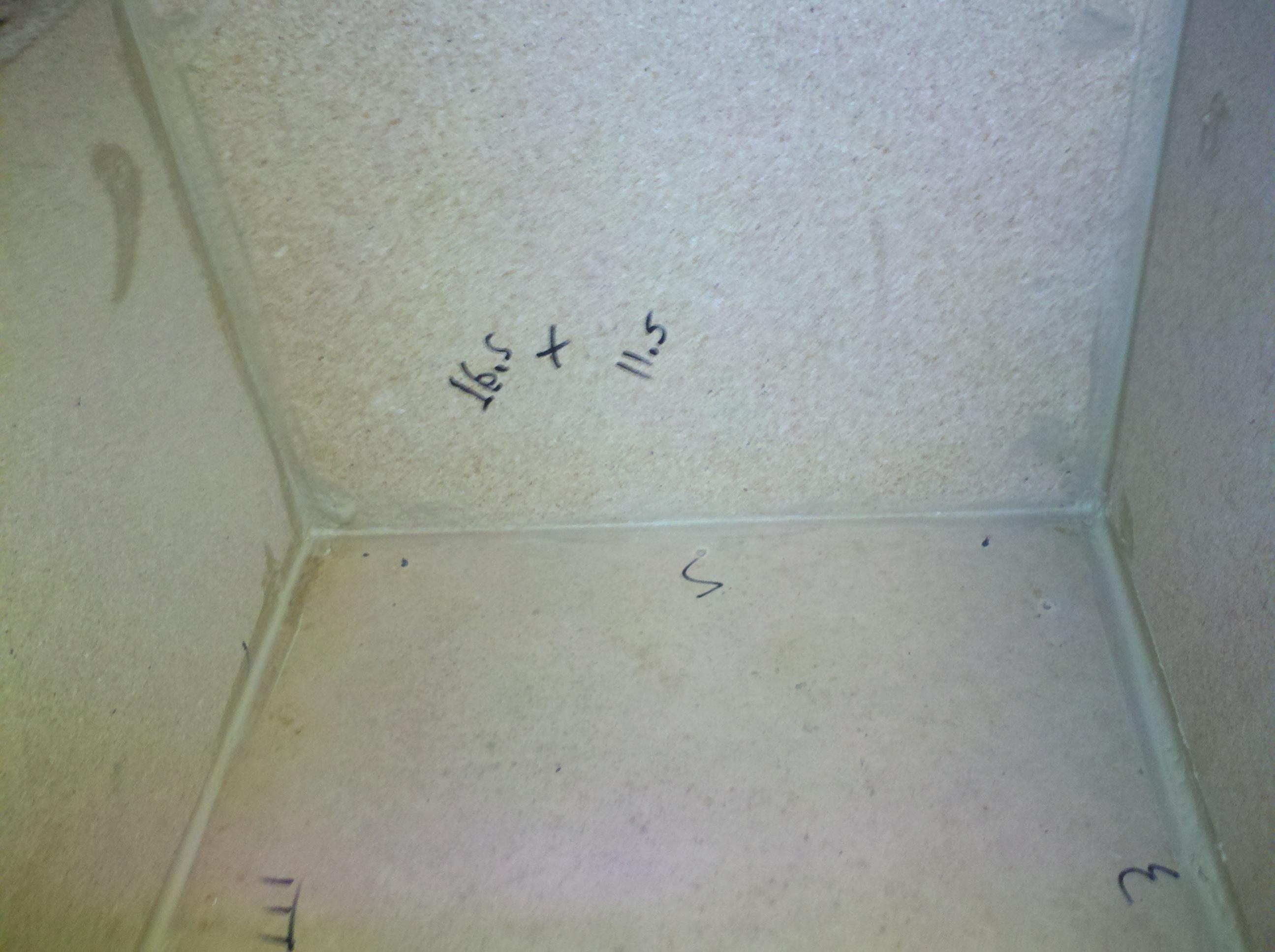

well i decided on the eminence lab12 driver. a sealed box. 1cuft.

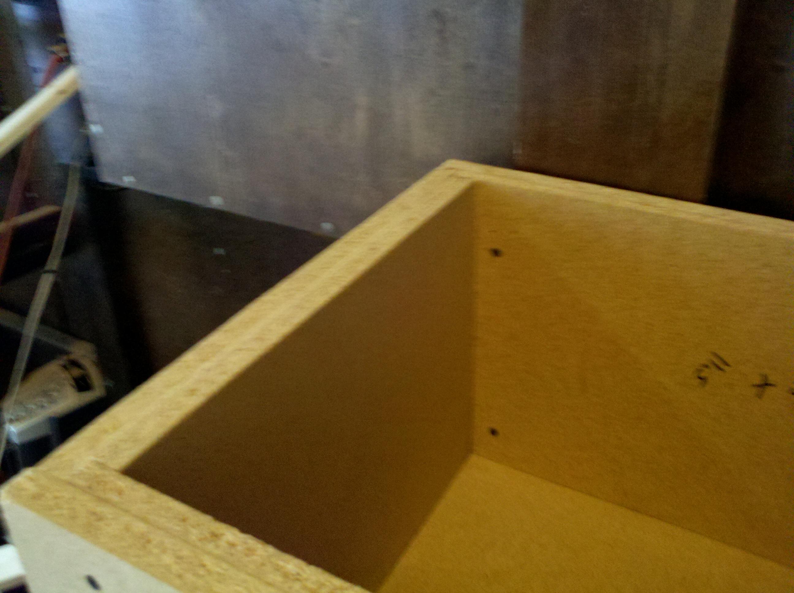

my outside dimentions are going to be 13x18x18, all sides will be 1.5" particleboard.
this leaves 15x15x10 internal airspace.. which makes 1.3 cuft.. once i put the driver in it should reduce the .3 remaining airspace and hopefully get me closer to 1cuft.

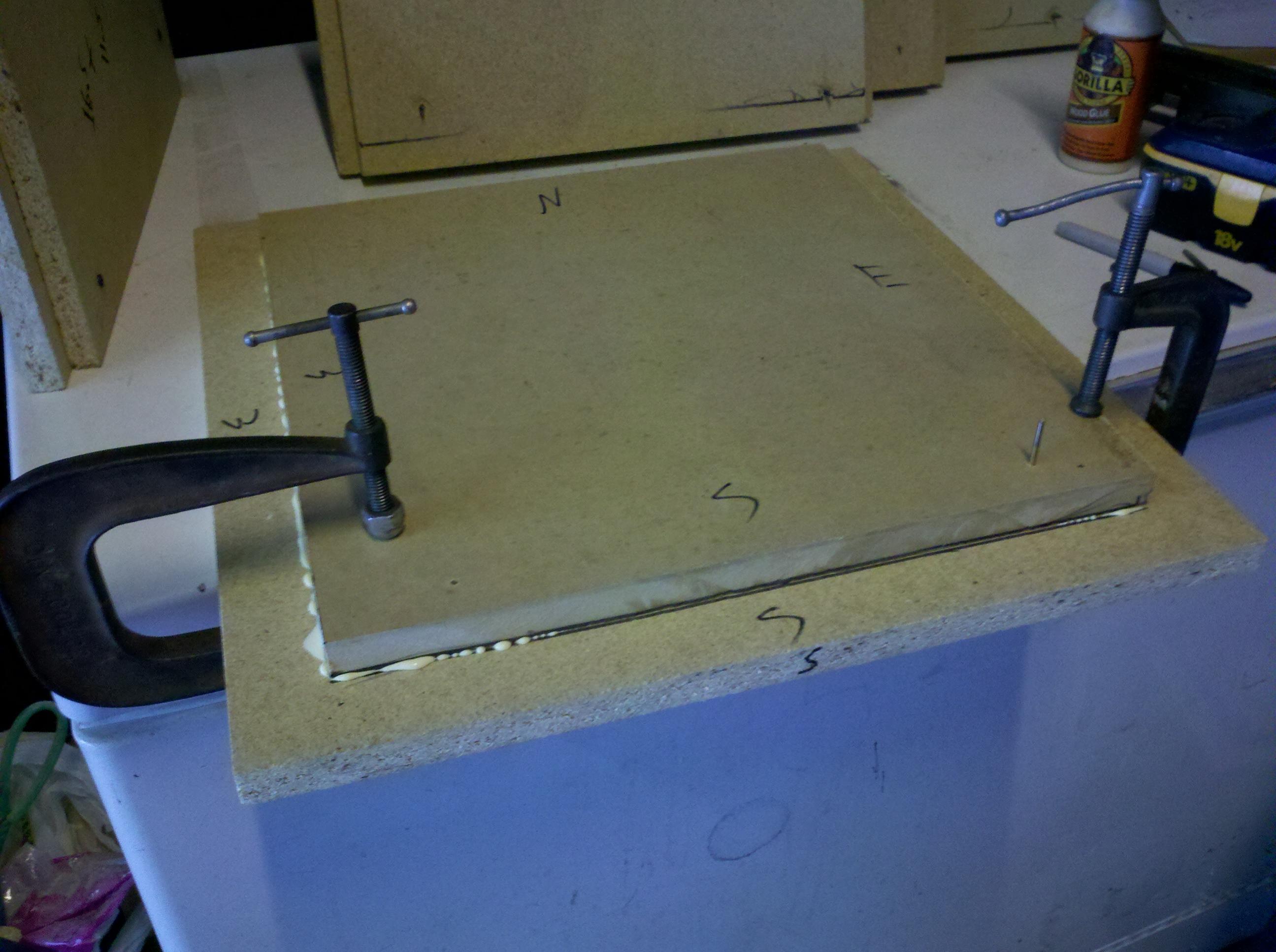

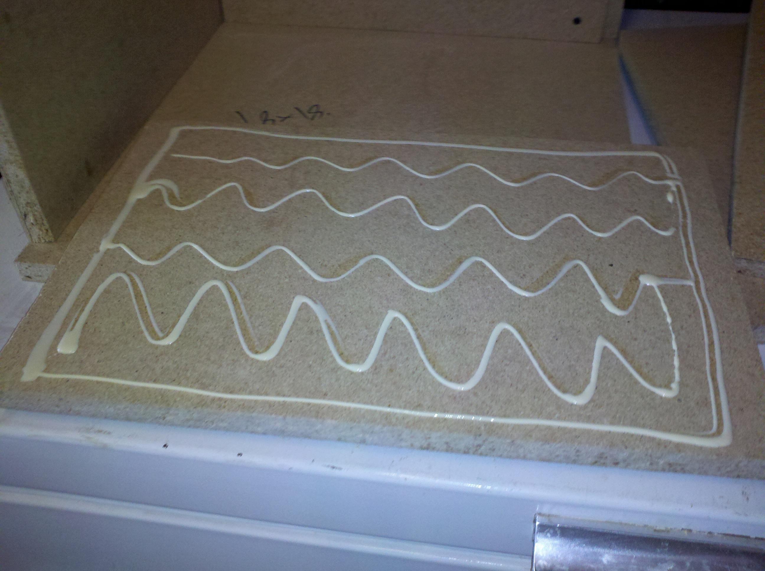

i had to sandwich pieces of .75" particleboard to reach the 1.5" width.

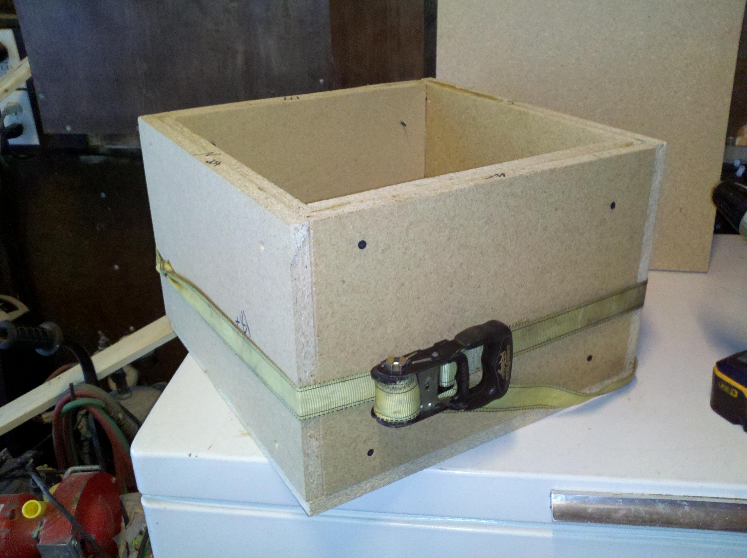

i also didnt have enough clamps so i had to use a strap to keep the sides tight while drying.. i used liquid nails for the corners of the box.
as of now, the box weighs 45lbs,, the Eminence LAB 12 subwoofer should arrive tomorrow.. it weighs 25lbs.. so my total weight of the subwoofer should be 70lbs.
It will also have a NS-1000 on top which weighs 68lbs. I'm hoping that 138 lbs should be enough to keep it from traveling.
i need a height of 20" and the subwoofer design is only 18"
what would you guys reccomend i use as feet for the subwoofer.
my floor is concrete, with vinyl laminate tile on top.. it does have some give, because there is a layer of plywood between the concrete and tile.
in this situation should i be trying to couple the subwoofer to the floor, or decouple it?
