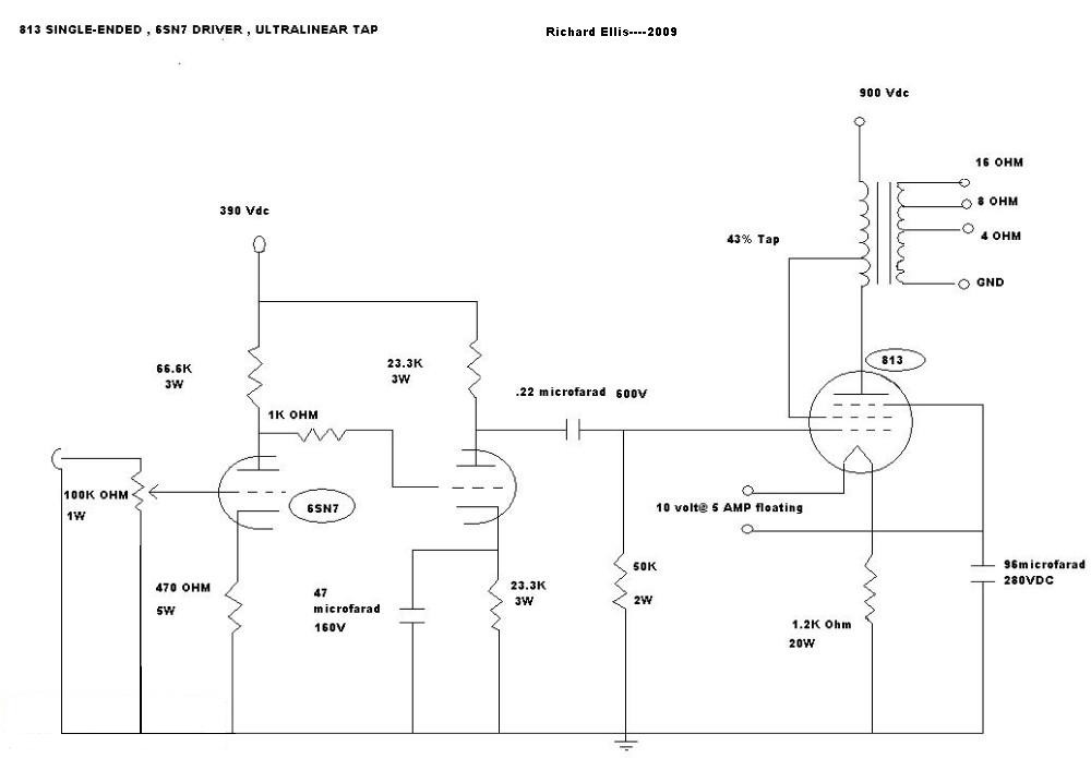

I've been working on this one over a year now...an SE with the 813.
I really haven't tallied up how much it's going to be. It will have to be done in stages to 'spread out' the costs. Have not finalized the power supplies yet....but I did find an output transformer for appx. $255 usd each. Power output at 45 WPC.

MFJ makes some power transformers that might be suitable for the B+.
Their 2009 catalog at page 71 lists an 800V at .5A xfmr with 120/220 volt primaries for $46.56, and a 900V at .5A with buck/boost 120/220 volt primaries for $132.00.
These are for SSB service, but you could probably get 200 - 225ma continuous out of either one.
I got a NOS Merrit 10V / 10A filament transformer at our local hamfest for $10.
That 833 amp is a real beauty - it's too pretty for my ham shack unfortunately, and I am not sure I want that kind of voltage in the living room or my office.
