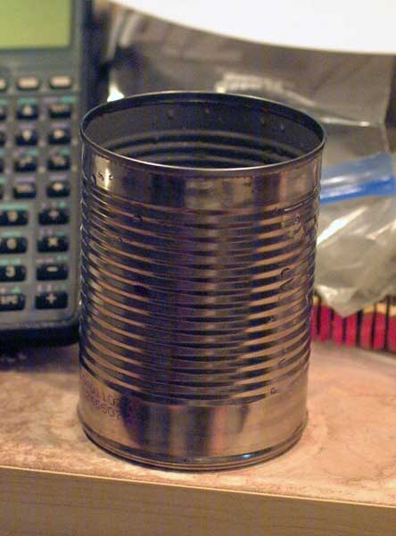

And yes, the "something cheaper" might be several/many steel cans, fitting together like Russian dolls, like in this shielding box shown here:
