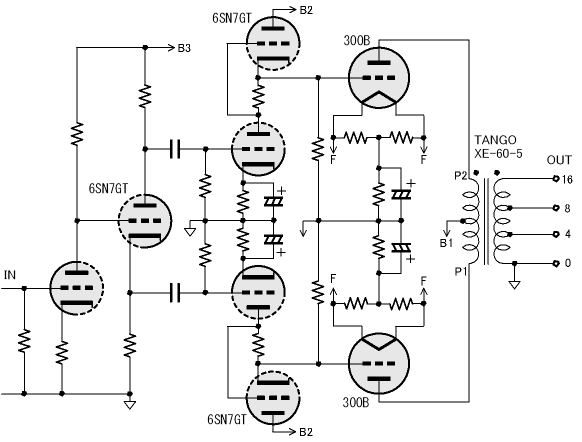

For 30W push pull amp.

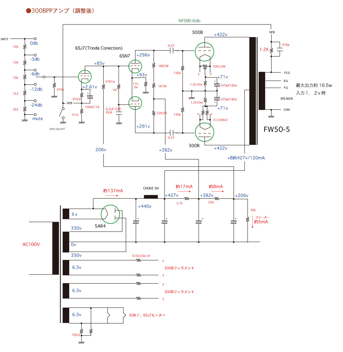

Can anyone provide value of Resistor (in ohms & watts) and Capacitor of this schematic, Please?
I think it serve my requirement and not expensive.
I gather information from this web
http://www.mizunaga.jp/cpamp0.hml
and found 6SN7 300B Push pull but no clue about Resistor and capacitors.

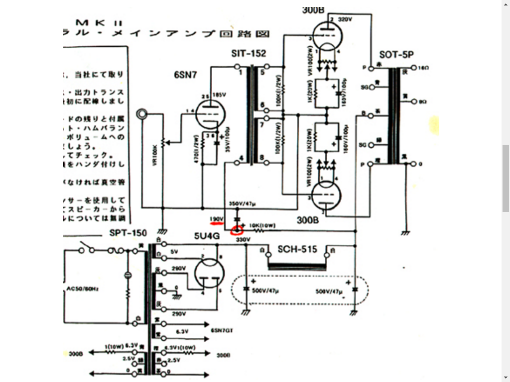

SIT-152 is an interstage transformer used for phase splitting. It will probably be a very expensive part.
I don't know the value of 1:2 interstage transformer. Some seller sell them in many value 44, 59, 106 HENRY etc

Which Henry and resistance for push pull schematic?

I have read that an interstage transformer if not high quality (expensive)and designed well can be worse than Capacitor coupling

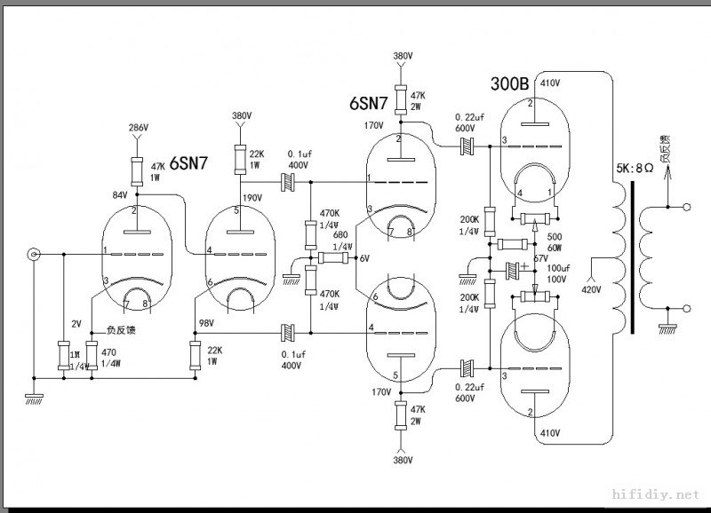

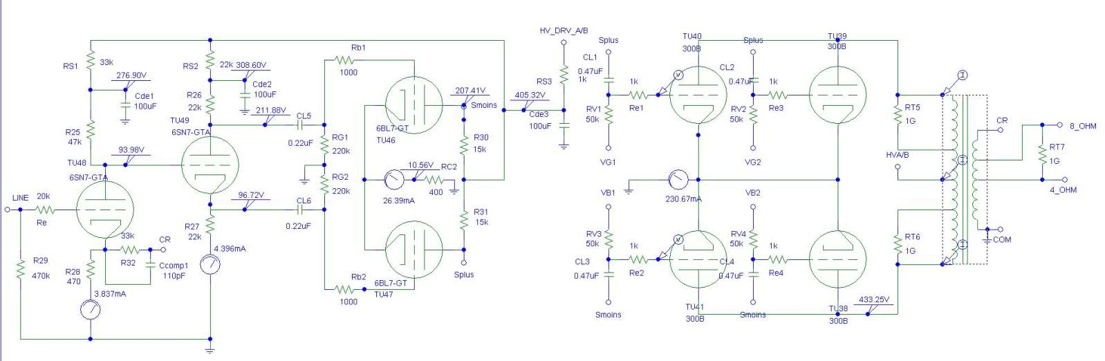

Just found good schematic and share
6SN7 6BL7 300B push pull
What makes this a good schematic or amplifier?
Parallel push pull?

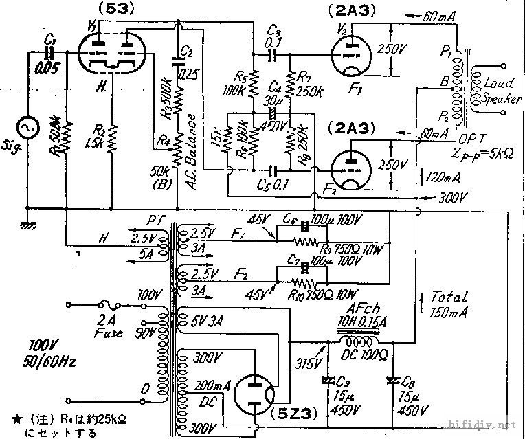

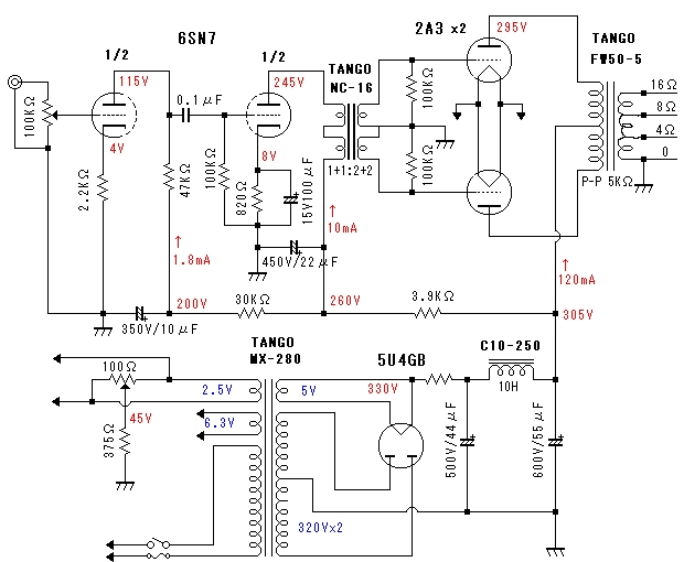

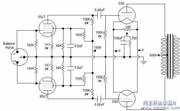

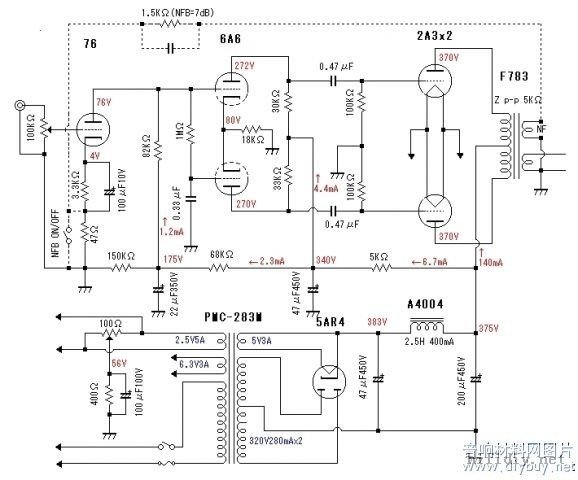

Another schematic find out.
Just want to share. Don't know which schematic sound better.
I just find as much as possible and share and hope someday, some experts here will give advice about these schematics.
