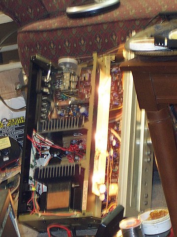

I finally got my Technics SA-5370 restored with the gainclone kit. I've got to admit that after all the tube-tone and extra power tweaking on the test bench, that her massive EI core transformer made for one heck of a surprise when I punched the bass booster button. I've just never seen the grilles blow off the speakers before. It wasn't quite like the old memorex ad, but really similar!
At first, days ago, I didn't even think the kits would work more than 20 watts each, but after a disappointing false start, days of test bench, and a re-assembly. . . Oh my gosh!
The test bench has only a 1 amp 36va center tap that will agree to 4 amps when needed. The Technics SA-5370 has a cantelope size transformer resulting 40+40 DC.
So, after tuning the amps for level reponse and as much clean power as possible (on the small transfo), today's reassembly (on the big transfo+very modded PS) results in super clean tube-amp like sound that's strong enough to redline my PA power meter.
Curiously, at such high voltage, the carbon R's that smoothed out the tone also seem to have acted as a dynamics booster.
Classical is unusually authentic--sort of like point blank range. Rock and dance is quite similar to a discotech with a wooden floor. Her passive pre has even more carbon. The raspy is now all completely gone. The remaining typical gainclone "clarity effect" survived despite the level frequency response.
WOW. This can toast the reference amp for fidelity and low listening fatigue.
See picture. I will be adding more heatsink parts and also add thermal paste between heatsink and metal frame--also going to thermal paste the transfo.
P.S. I'm off to seriously tamper some LM1875's as soon as I can find some copper heat spreaders. So there's a limiter? We don't think so! ;)
P.P.S. OH MY GOSH!! I just now had a weird experience!!! My mother just came over to my house in the middle of typing this.
She pops in a european dance CD and cranks the sucker ALL THE WAY UP. Off go the grills again! Next, she's doing some kind of sockhop vs. disco moves all over the living room!!! I've just never seen her act this way before. Now she wants one too. ;) I guess that's a good sign.
