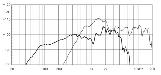

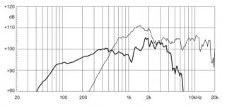

Ok so I have self built speakers with eighteensound 15cx1000 (coaxial) drivers for tops and 15mb1000 drivers for subs, and we have been using them for wedding animations for about two years powered by two Yamaha P7000 amps and a Dbx active crossover crossing the subs at about 200-250khz. Box dimensions are those of ordinary commercial ones.
On the tops I have Beyma FD250 crossovers with default jumpers (no attenuation and no equalization) crossing the woofer and the built in HF driver.
We have also some other self made speakers also eighteensound drivers but with separate woofer and HF drivers with horn, so no coaxials., and the same crossovers.
My brother says the other speakers have a more "crystal" sound, but I presume it´s the horn making its job ....
As I´ve seen that beyma has crossovers specific made for their coaxials, I was tempted to try one out, but the HF section is designed for 16 ohm, that´s why I started this new thread....
I feel that the speakers are very goog stuff and have a balanced sound, as the DBX with it´s self calibrated microphone produces a flat plot on the display when performing auto-eq.

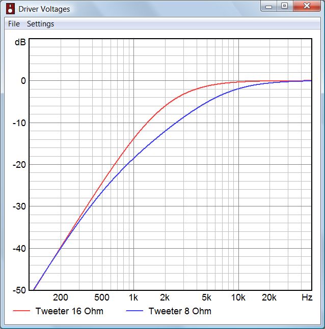

Considering an ideal 2nd order LR high-pass filter, I calculated C = 2,5 microF and L = 2,55 mH. Then with inductor L in parallel circuit with a 16 Ohm resistor, and cap C in-series with L || R, at 2 kHz, I calculated the voltage division that occurs. The voltage across the resistor turns out to be one-half times the total voltage applied across the network. This is of course what it should be, that is - 6 dB.
Then I repeated the above calculations, except that I substituted an 8 Ohm for the 16 Ohm resistor. Voltage division with the 8 Ohm resistor at 2 kHz is now 0,25.
The only thing that I can conclude is that wolf_teeth and myself are not looking at the same thing. Can you or wolf_teeth explain how it would be possible to reduce the resistor from 16 Ohm to 8 Ohm while maintaining an identical voltage division?

He asked what the Fc of the xover would be if he changed the impedance from 8 ohms to 16 ohms, when it was originally at (for example) 2kHz for a 12dB xover. The answer is still 2kHz after the impedance change. The filter will still have a corner frequency of 2kHz, but the Q of the filter will be different.
Only in a 6dB xover AKA first order will the actual xover point or Fc shift an octave.
For example- If you have a xover meant for 4 ohm drivers initially, and it has a BW2 alignment, and you swap the drivers for 8 ohm drivers;
The Q of the filter will shift from 0.707 to 1.414 and the Fc will remain the same.

I took the OP to be asking something different from what you say. He asked what would happen if he connected a tweeter and woofer, both 8 Ohm, to a pre-assembled cross-over network with a 2 kHz cross-over frequency, 2nd order, calling for an 8 Ohm woofer and 16 Ohm tweeter.
When you say "The answer is still 2 kHz after the impedance change" does that include changing the values of capacitance and inductance of the caps and coils of the cross-over network to keep Fc equal to 2 kHz? If so, I think that you misunderstood what the OP was asking. The only change that the OP had in mind, I believe, is connecting a 8 Ohm tweeter where a 16 Ohm tweeter is supposed to be connected.

The result most likely will be something like a gap in the frequency response between 2 kHz and 4 kHz, more specifically a dip or lowered intensity in that range. Both the woofer and tweeter would be audible between 2 kHz and 4 kHz, so you could call that an overlap. The problem would be that the summation of their intensities is too low.
I believe that I'm correct in this, even though others here are saying that what you propose won't shift the cross-over frequency at all; that to me doesn't make any sense at all.

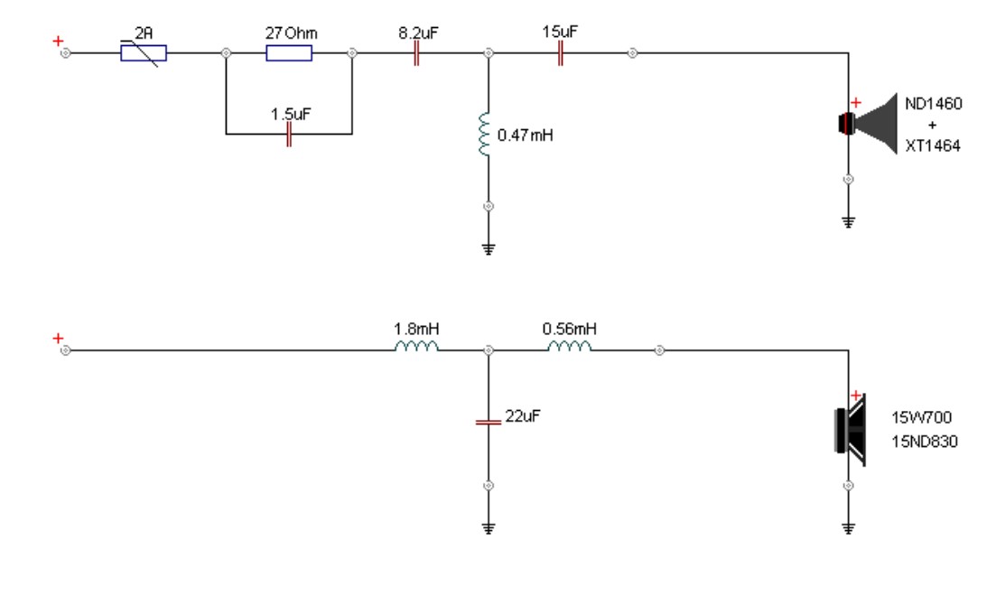

crossover for the Eighteen Sound 15CX1000 COAX
He needs a crossover for the Eighteen Sound 15CX1000 COAX with CD Eighteen Sound ND1480 and a co frequency @ ~1KHz.
You can use the filter already made for the other drivers and reducing about 2dB in the CD driver (ND1460 vs. 2dB attenuation/ND1480) and changing the frequency from 1K5Hz to 1K0Hz. Simulate, build and test.
http://www.eighteensound.com/renderPdf.aspx?pid=247
http://www.eighteensound.com/staticContent/applications/kits/18Sound_kit15.pdf
Nope- no change of values. Speaking from textbook or ideal situations, the xover frequency as the filter operates would not change. The fact that the rolloffs of the drivers are not incorporated to yield the effective acoustic slope and Fc is something you can't even fathom due to no graphs, plots, etc.
That said- the Fc of the xover will not change if it is 12dB or higher, but the Q of the filter will. I didn't misunderstand.
If the xover is BW2 @ 2kHz for 16 ohms, and you use an 8 ohm driver, the Q of the filter will be 0.3535, and the Fc of the filter will be 2kHz. If it's an LR2, the Q will be 0.25 and Fc = 2kHz.
