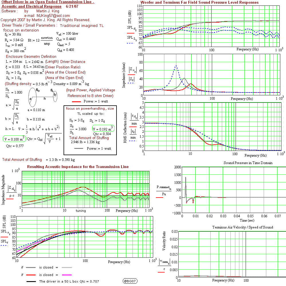

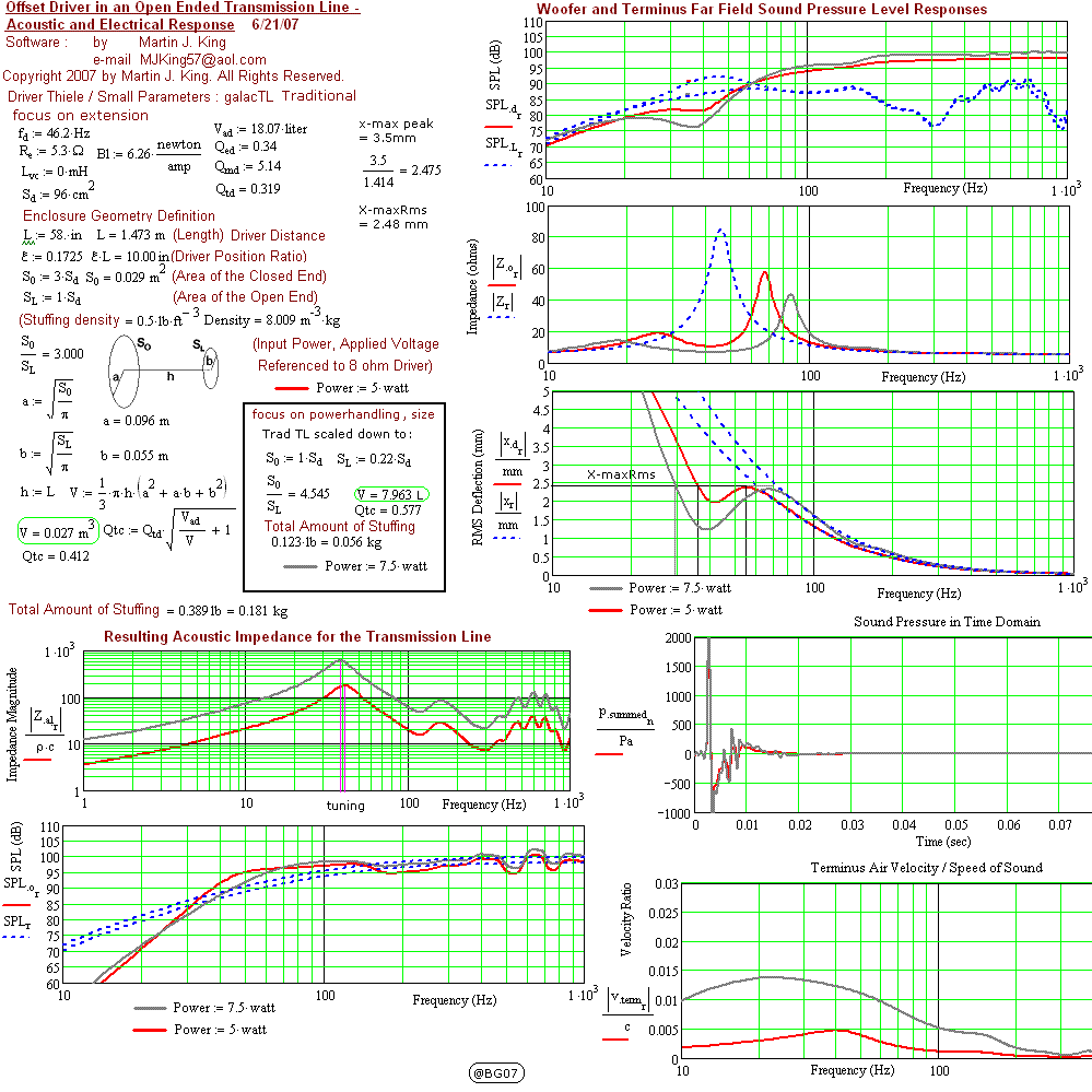

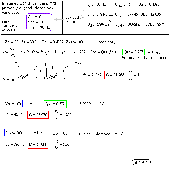

My basic T/S driver specification for a suitable TL -driver was and are a driver very suitable for a closed box having lowest f- 3dB when picking a flat BW Qtc= 0.7 alignment in a box with Vas/2 volume.
In case for the traditional TL case I mostly have used (and still use) a tapered or in case non-taper volume >= the Vas value, trying to avoid volumes > 2 x Vas as then x-max turns out to be very most limiting factor for bass extension/acoustic power.
So, if the driver Qts number is chosen to 0.41 then the Vas number if divided by 2 results in the mentioned closed box volume suitable for a flat BW response (f-3dB optimised) and if multiplied by 2 in to a critically damped box were Q= 0.5 and last, if kept as is, a Qtc = 0.58 = Bessel response, also easy to remember.
See picture # 1(3) where a imaginary driver T/S numbers are shown for a couple of closed box calculations and picture 2(3) where the driver also can be compared when used in a straight TL or in a traditional 3:1 tapered Tl where also the easy remembered numbers are in use (Look at the resulting TL volumes).
galac, See picture 3(3) where your driver is simulated.
