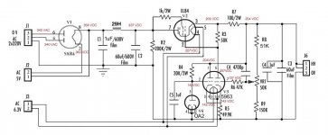

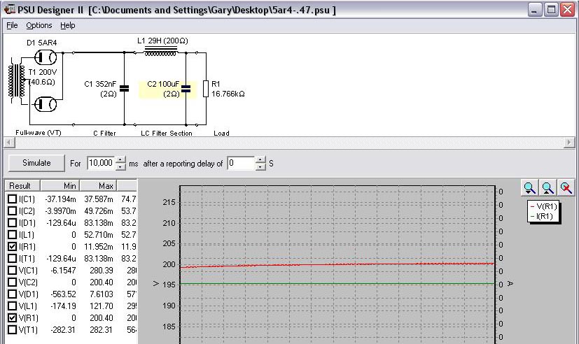

Thanks aardvarkash10 -- here's a screen shot of the psu I modeled. I'm using a choke loaded with a small film cap before the choke to set voltage. Presently, I'm using a 60uF film/oil ASC cap but in order to reduce ripple I modeled with paralleling a 40uF and the 60uF. Since I don't have experience with this I'm guessing the extra 40uF is reducing ripple.

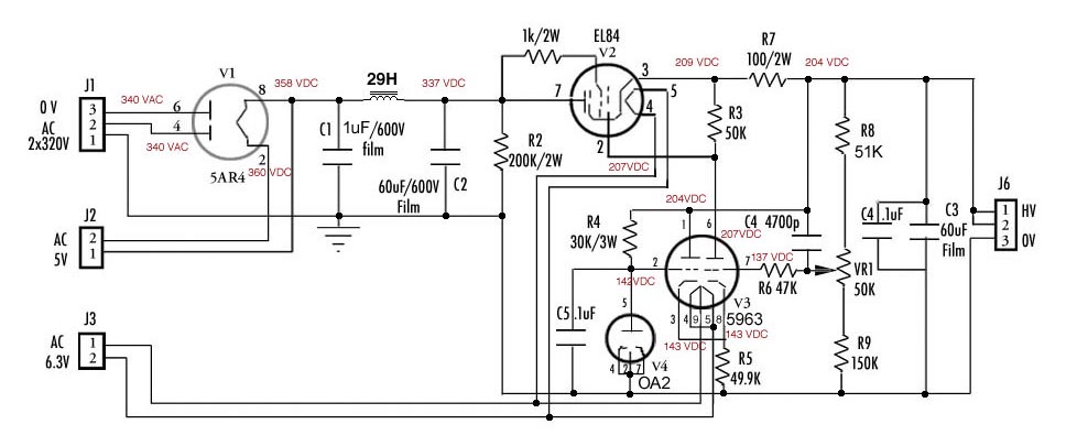

What I don't understand is the drop across the 5AR4. In the present regulated supply(which I'm replacing) also attached, you can see an increase, but I don't know if that is due to the entire circuit.
Thanks. :) Just did. Comes out the same. Voltage is 199.7vdc
What I don't get it when I make a slight change to C1 I get a big change in voltage. For example, changing the value from .352uF to .33uF results in a 20v drop. However, in real world when I've change from a .47uF to a 1uF I only got a couple volt increase. Again this is with the regulated supply which may behave differently.

Look at V(C1) in your model. It is 280V, so the big voltage drop is not over the 5AR4, it is over your 200R inductor resistance.
Got it! Thanks. I've been struggling with this program and understanding the power supply design. So by looking at this does everyone feel its accurate enough to spec the PT at 200 0 200 on the secondary?
The schematic you provide shows much higher voltages, so I suspect not, if you are trying to build that. Isn't the transformer in the schematic 320-0-320?
That schematic is what I'm using now. It would be replaced by two PSU's modeled off the schematic in PSU II
But you still need the same voltages, right? I don't see how you are going to get 337V on the plate of the EL84 with a 200-0-200 PT.
It only will have to handle half the current, so sag will be a little less, but you still need close to a 320-0-320 to get what that schematic reports.
