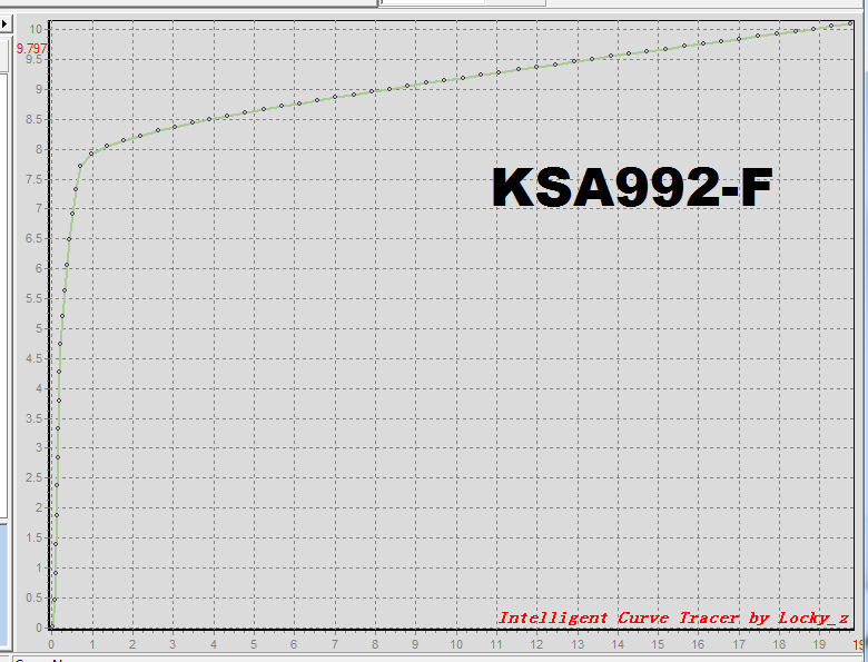

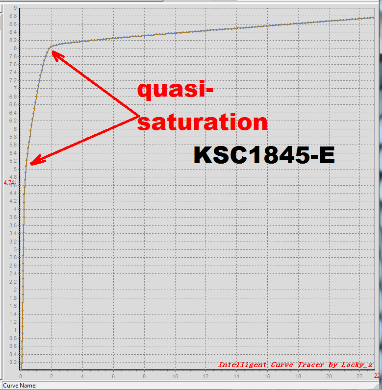

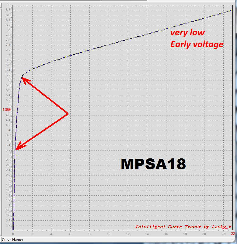

Hi Mark,They aren't all that wonderful either. Locky-Z curve tracer plots attached. | Ice | on Y-axis, units = milliamps. | Vce | on X-axis, units = volts

how is looking curve at 0,5-1,5mA where this devices is mostly used?
Pn100a pn200a or bc550c bc560c good up to 45 v dc at input stageI wasn't so thrilled with the MPSA18
