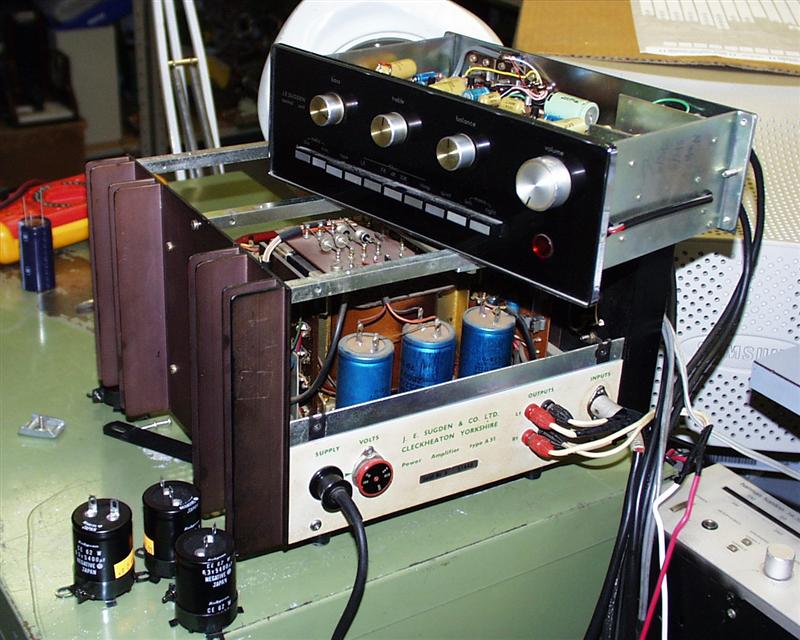

Hi everybody
I'm trying to improve my old Sugden C-51 A-51 preamp/amp combo. Then i realized it is not a class A amp as i expected. It runs cold and there 2 pairs of mj12955 and 2n3055 mouted on those big heatsinks. Then i open the top cover and i saw 3 big 2500uf 40v capacitors for each sides. Two of them in series for 0v-35v-70v and one before the speaker output to filter the 35V.

Why it's not a class A amp as expected? (no apparent mods)

Someone have a schematic of that version of the amp?
Question 3
I will put 5400uf 63v caps instead of those 2500uf for the supply. What kind of capacitors should i use for the output? I've heard there is some audiophile-approved ones...
Question 4
I've order some transistors to try in place of those 3055 2955, Mj15003 Mj15004 and MJ21193 Mj21194. Is it dangerous to try them? How can i adjust them? My boards have 2 potentiometers.

Whilst transferring the Sugden files from my old pc to my current one I had a look at the schematics etc.
The C51 control unit was used with both the A51 and the P51 power amps.
The A51 is a Class-A design but it uses only NPN transistors (2N4914) in the output stage and has a 55V supply rail.
The P51 is a Class-AB design with a complementary NPN-PNP output stage and a 70V supply rail.
From the information you have supplied it would appear that you have a P51 not an A51. I have a schematic for the P51 but not the parts list (the transistor types and component values are not given on the schematic).
When you have emailed me I will send you what I have for both power amps.
