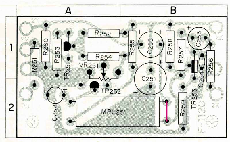

------------------------------------Netlist said:In short: Looking at the upper part of MPL251 which is the drawing of a resistor, you should make a bridge across that 'resistor'.
/Hugo
Hi Hugo,
Dig it.
I will try that later (or most likely tomorrow), and I'll let you know how I made out.
Thank you *VERY* much!
smiles,
Gregg
/Hugo
Hi Hugo (and GP49),
I couldn't resist the temptation to try it, so I took my stereo cabinet apart, pulled out the Sansui, reattached the wires I had previously removed (and never bothered to put back).
I put a temporary jumper across the two points you showed me in that photo...
...AND...
...(Keep scrolling)...
... ***IT WORKS!!!***
THANK YOU!!!
THANK YOU!!!
THANK YOU!!!
THANK YOU!!!
THANK YOU!!!
THANK YOU TO EVERYONE AT THE FORUM!!!
Very Sincerely Yours,
Gregg

----------------------------Netlist said:...Looking at the schematic, the signal from the tuner comes in at 2X. It goes through the capacitor C253 which is there to block DC voltage. Then it is presented at the Base of transistor 253 and comes out at the Collector. Now you understand that a transistor with three pins has a Base, Collector and Emitter. The emitter is the node with the arrow. The Collector is connected to the 'resistor' of the MPL251 and leaves the circuit via another capacitor C255 (again to block DC) at point 2Y. The 'resistor' works as a gate for the signal the moment the lamp (which is the winded spiral down at MPL251) lights up. In other words the lamp commands the 'resistor' to pass the signal. Transistor 251 and 252 command and regulate the lamp. But that's another story...
/Hugo
Hi Hugo,
When it is explained to me like that I understand it. My problem with schematics is a simple matter of confusing the symbols. For example, I understood the circuit when you showed me the "Block Diagram" with the jumper highlighted. I didn't merely just put a jumper there and not bother to understand it. I looked at the block diagram to try to understand what was going on.
By the way, I didn't put a jumper at that spot. I was a bit more clean about it. (Others might say "sneaky"). The way the board is attached to the unit leaves one of two ways of doing it. (Note: The board is ground-soldered to the chassis and there are a ton of wires bound together at the same spot, making it difficult to work on the under side of the circuit board). I could have done it the easy way, which would have been to solder a wire on top of the circuit board at those two points you highlighted.
However, considering this was a "permanent" fix (due to a lack of replacement part availability), and considering I really don't like doing "sloppy work" like running jumper wires across the top of circuit boards... If you look at the photo you attached, and look at "+" side of C255, and the "R" side of R258, on the back of the board itself there is less than 1/8th of an inch distance between those two points. I cut a 1/8" piece of wire (from a spare ceramic capacitor) and laid it across those to points. Then I tack-soldered each end and flowed a thin layer of solder across those two points.
By looking at it, you would never know I worked on it. That is what I meant by "sneaky." The only way to tell what I did is to know (from looking at the schematic) what you are looking at. There are some techs who would be very annoyed at a job like that. If the part was available, I would have done it with an *obvious* jumper wire. However, since there is zero chance of that circuit ever being repaired "properly," and because the repair itself is not likely to be the cause of any further circuit failure... For that reason I feel okay about doing the repair in such a manner that it cannot be seen.
In my mind it is merely a "clean" repair. However, I realize that there are some who get very frustrated over such "sneaky" stealth repairs.
Again, my most sincere thanks to everyone who helped me with this. I made a PayPal donation to the site as my way of showing my appreciation.
BIG smiles,
Gregg

I have the same issue (I believe) as gwyz with my Sansui 5000a. No FM. Yes the Stereo light was out but I replaced it with a 6.3 150ma lamp. That did nothing. Then I thought I could do the bridge trick on the 1120 board but I can't even find the 1120 board. None of the boards are marked with this. It's not the FM tuner board is it. Anyway, I have the portion of the schematic that was attached. If I could find the board, I believe I could do it (though I'm a total hack) and can't even read a schematic. Help!
Tried to email Netlist but my account is being monitored because I'm new - says I need to make a few posts before emailing directly. If any of you could cut and paste this into an email to him, I'd be 'abliged to ya'. Thanks.
If I recall correctly, it's a small board underneath with a small number (maybe 20) of parts on it. I just soldered a little jumper in place where red line is and it fixed the FM.
Here's a picture of the board.
http://www.diyaudio.com/forums/attachment.php?postid=760450&stamp=1131295854&
