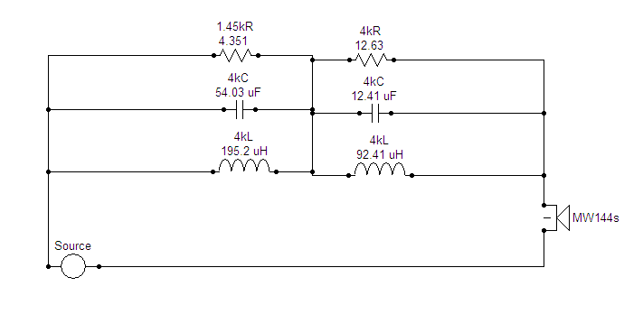

Hi I'm a bit late to the party but here is a post that I wrote before on calculating notch filters.
Hi I don't know the speaker you are mentioning, but if you want to learn about notch filters I found this wikipedia page invaluable. It takes the guess work out of it!
RLC circuit - Wikipedia, the free encyclopedia
go to the parallel RLC section (but it helps to read the preceding stuff as well.
If you are like me and shy away from maths, it looks intimidating but you really only need the Q formula
and the Wo formula
to be able to work out a filter suitable for your desired frequency. Note that Wo is in radians, so you need to divide by 2pi to get Hz. (edit: the original formula I linked to was incorrect I've now fixed it, sorry for any confusion!)
Swapping the values for C and L will change the q (without changing the centre frequency) and the resistor determines the amount of cut.
Choose a value for C or L and the frequency and then work out what the value for the unknown component (L if you chose C) is. adjust until you get usable values and the desired Q. The higher the Q value the narrower the notch will be.
I found this to be a much better starting point for simulation (very close to the desired frequency) than the methods I'd found in my speaker books.

A notch is a notch is a notch. It does not know what kind of box you have. All of these filters, be they they series or shunt are effected by both input and output impedance. As you are trying to deal with a hump, you will be doing a "parallel filter" which is in series with the driver. Parallel refers to the components of the network in parallel, not the position of the network in the circuit. To understand how it works, you might want to simulate it in LTSpice. ( D'Apolitto will even give you a model for a speaker) No matter the simulation, you still need to test. Simulation gets you close. It tells you that you are on the right track.

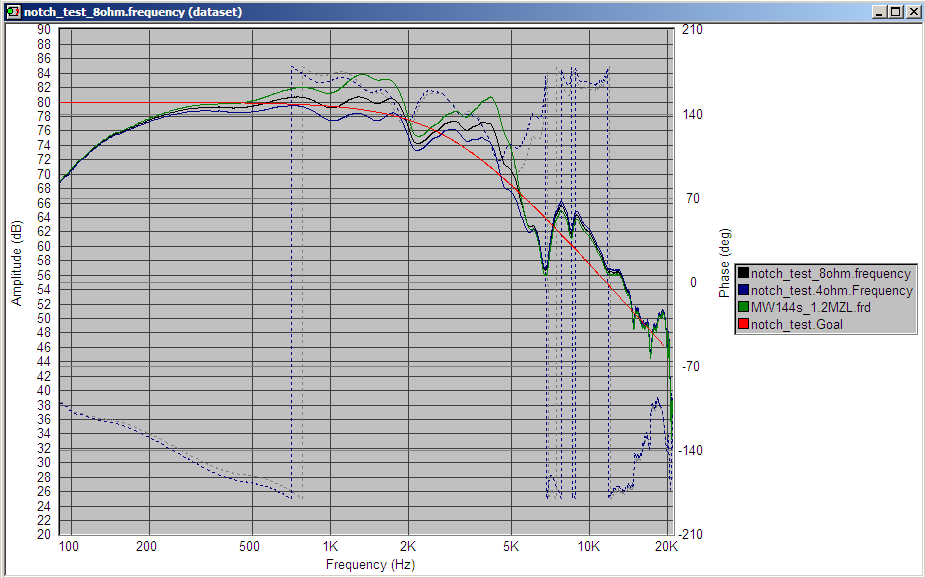

The graphs above show all the symptoms of baffle step hump at about 650. A notch is not the best way to deal with it. Lower the first pole. It also shows pretty bad breakup at about 2200. You may need to put a notch on that puppy if you are not using a very steep crossover.

Tony,
If you are doing a shunt notch filter, you're right, the speaker impedance shouldn't matter for the RC part. How deep it is will matter with the R part.
I was thinking it didn't matter for the parallel series connected but I was wrong! perhaps it doesn't matter so much for the centre frequency but it certainly matters for the Q or the amount of cut....
I just did a check in speaker workshop by doubling the impedance of my MTM measurement and then comparing with the same notch filters.
results shown below.
green is the non filtered response (on the baffle)
blue is with the actual impedance of the speakers
black is with the impedance doubled.
red I just added in, it is a second order bessel target at 2.8Khz (my crossover frequency, the final crossover is actually 4th order bessel at 2.8khz with some added components.
Tony.

More than agree with that.
I had one project, where was about same picture ~600Hz. I've put notch there, got almost flat response, but after listening I removed it.
I have to run the edge again. But based on that graph I also agree with you. It needs BSC not a notch. However, when I ran a quick sweep test and from what I remember the real world measurements and graph (edge) are different. I will redo the actual measuremenmts.
