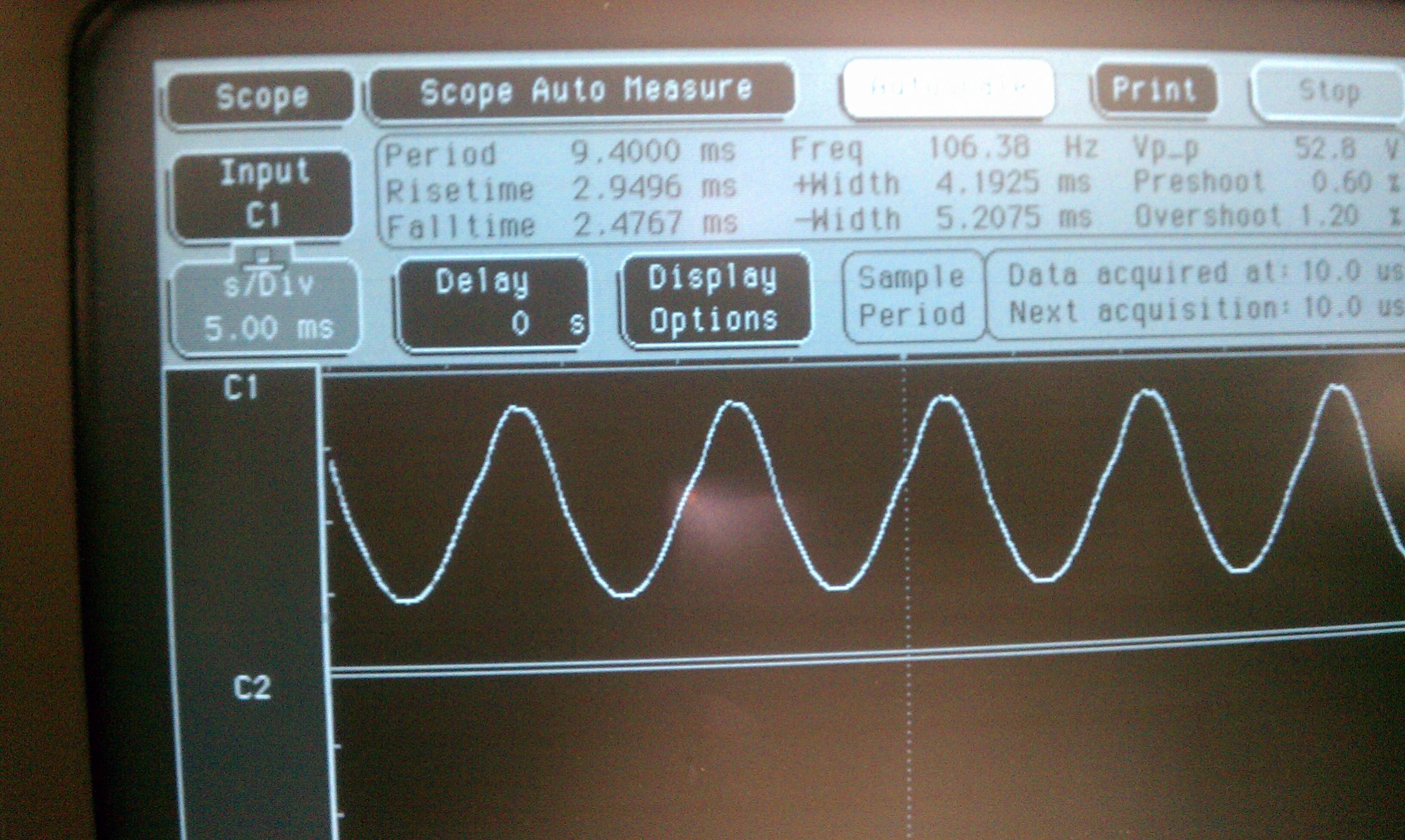

Ok, tried a 200pf cap across C15, did nothing.
Tried the 9.4Meg resistor across C15 (Pin 7 to ground). Signal is pretty clean. So something clear that is odd with the input stage.
I wonder if R20 at 1Meg is too high a value, but I really don't know the theory on how this circuit works.
Kevin - The leads and other parts are pretty close on the circuit board, but could be something like that. And for your test was that to place the 1K resistor before Pin 7 and the 1M and 0.47uf cap?
LinuksGuru - Don't think it's an output transformer as the signal is clean when I play a bit with the input circuit as mentioned. The output transformer is new, and I think I would see some odd intermittent signals (and hear it for sure).

No, I think he means on the first stage. I was going to suggest this, but kevinkr beat me to it. It could well be that the original caps were sufficiently lossy at RF that they didn't need stoppers.
As a general rule, if a circuit is behaving strangely and touching it stops it or changes the behaviour then there is a good chance the stage you touched is oscillating at RF.
PS putting a resistor to ground will changes the bias of the top triode and probably reduce its gain, so killing the oscillation. It might also reduce the gain of the bottom half, so that could be the culprit too.

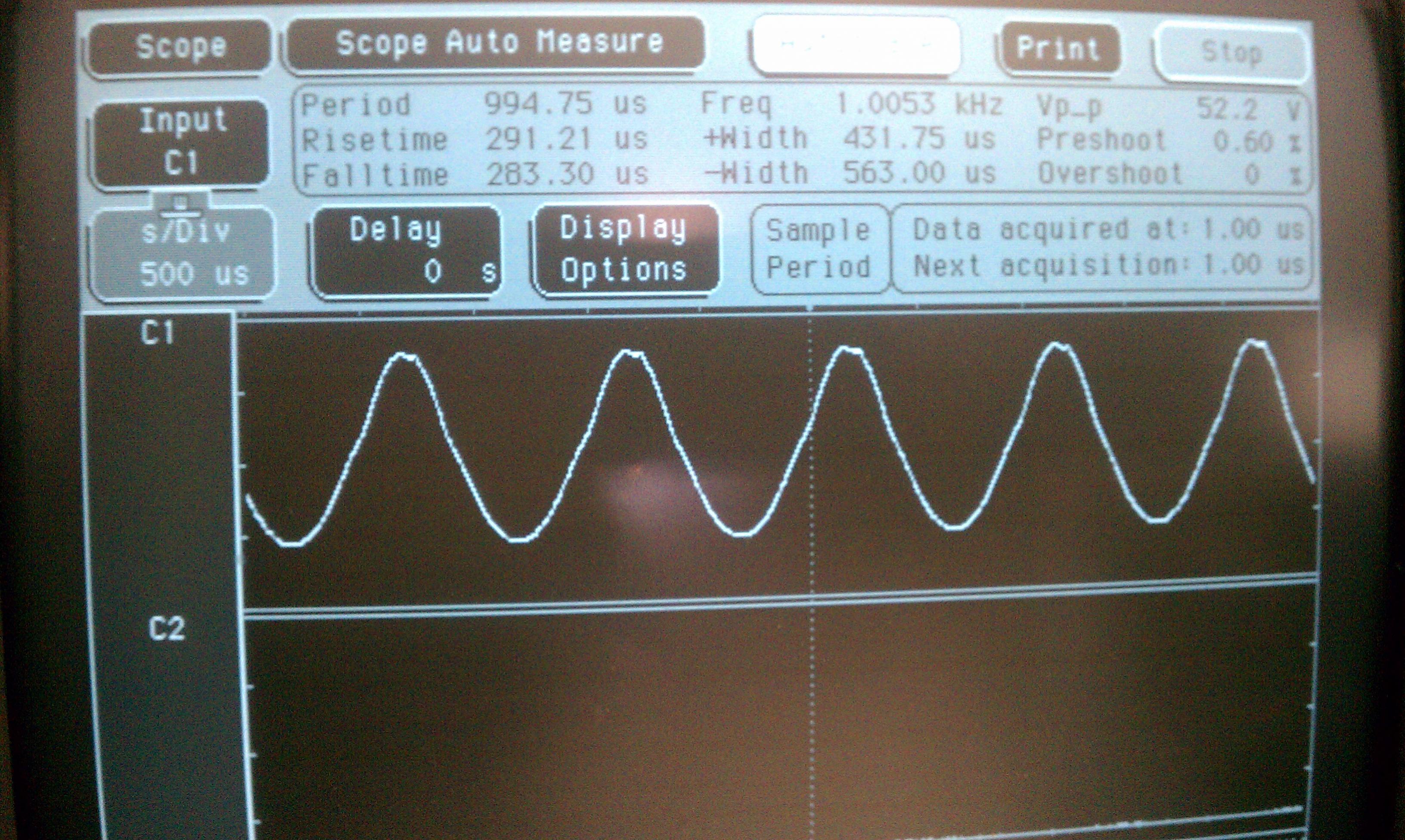

Back from the Lab ;)
Adding in the 1k resistor before Pin 7 of the 12AU7A had no effect that I can see. Signal was bad at 100Hz and 1kHz as in the original with the odd oscillations.
Sandy

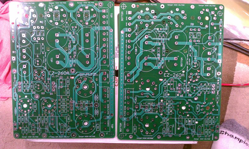

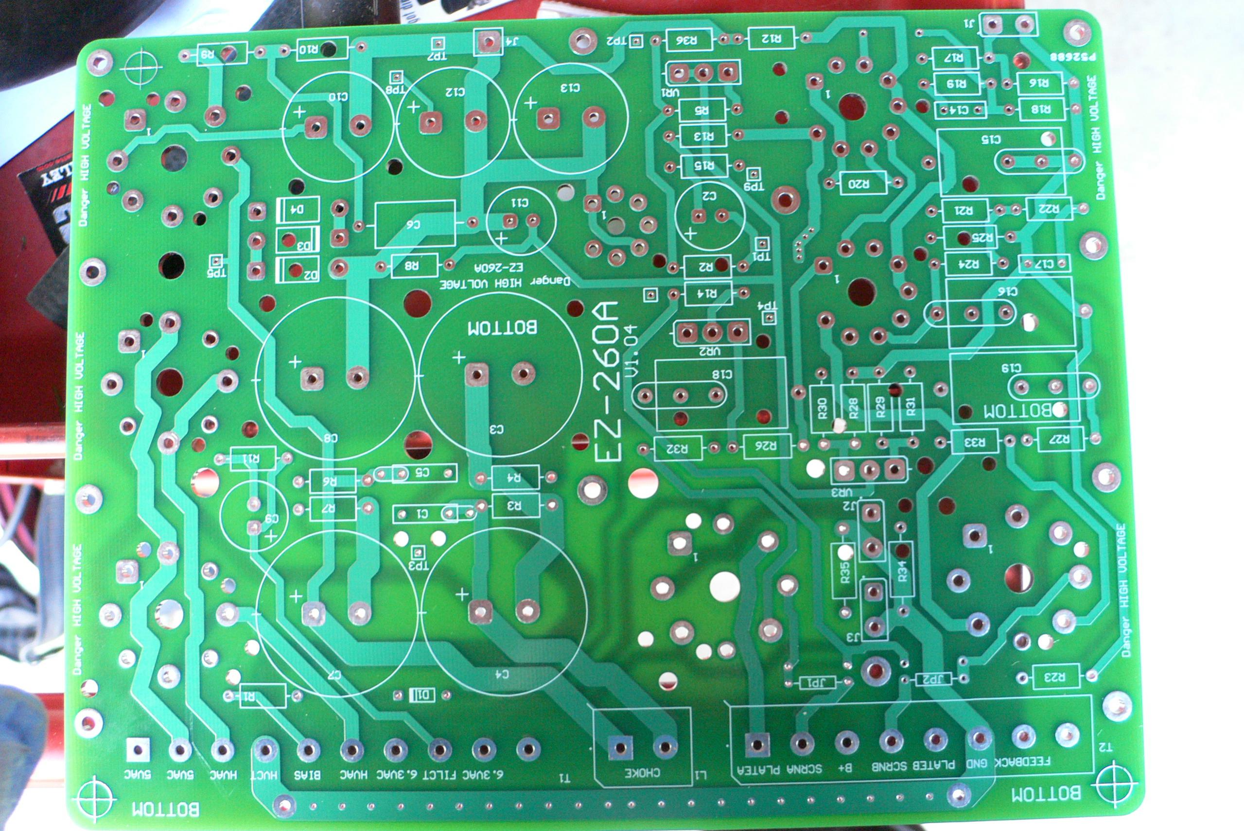

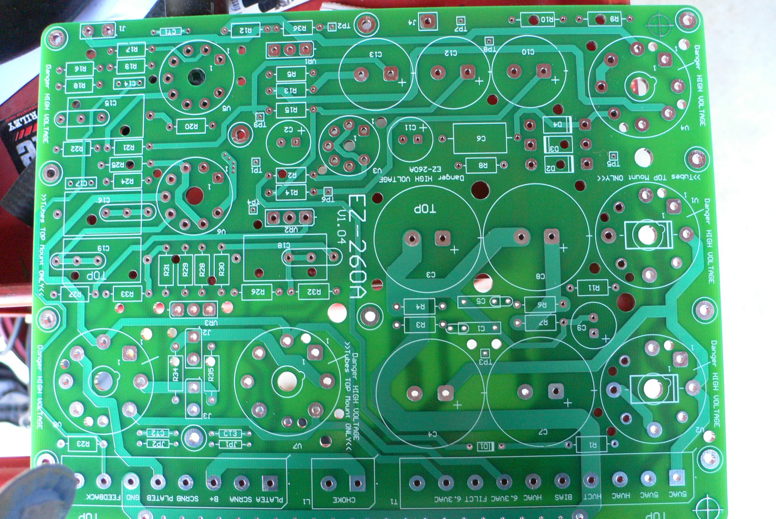

Time to post a picture of the board layout showing how things are placed, and your grounding scheme.. (How long and how heavy is the ground trace to the 0.47uF cap?)
Probably time to start thinking about a more conventional cascode design as well. Did the original design use a shield over the tube?
Also what about R7? Using the 100K specified or something less?
Kevin -
Did you mean R17 on the input of the 12AU7? That is left at 100K
I will have to get a better picture but here is a camera phone image.
The board is made with 2 Oz copper and has generally very wide traces for all connections.
The ground system is sort'a split into 2 regions with fairly heavy traces for all.
Here is a top and bottom view, but I'll have to find the digital camera for a higher res shot.
Also I don't think they had a shield on any tubes on the original 260A from what I saw.
Sandy
R17 may be too far away from the grid to act as a reliable stopper. Also the connection to this runs parallel to the cathode trace so there is scope for coupling at VHF/UHF frequencies. Your ground traces seem quite long and thin. Remember, the valve does not know you only intend it to amplify audio; it might think you are making an RF oscillator with resonant lines.
I am going to try to pull that and jump it from the pin of the tube. I might try to pull a wired ground lead right up to the input and see if that shoes anything different. I don't think it's a ground issue, but more a coupling issue. R17 makes sense and it does pass through the socket.
Thanks for taking a look, I'll give that a try, the one bad thing is that the trace from R17 is under the socket, will have to cut and pull to remove the trace.
Also remember that the thickness of the copper on this PCB is typically 2x as thick as what is normally used for production. Think of the traces as 2x as thick as they look ;)
Sandy
