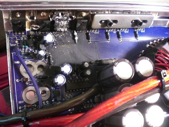

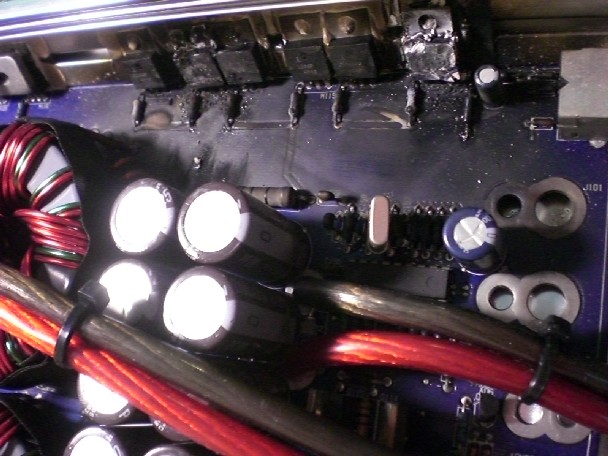

I have another question for you. I have a US amp USA 3000 that has burnt fairchild 75344p's on the front end of the amp. I am sending pic's. Anyway I am afraid to do this amp myself because it has a clear plexiglass cover and it needs to look halfway decent. Would you be able to repair it or know somebody you can recommend? that would be fairly resonable price wise?
