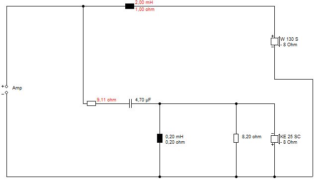

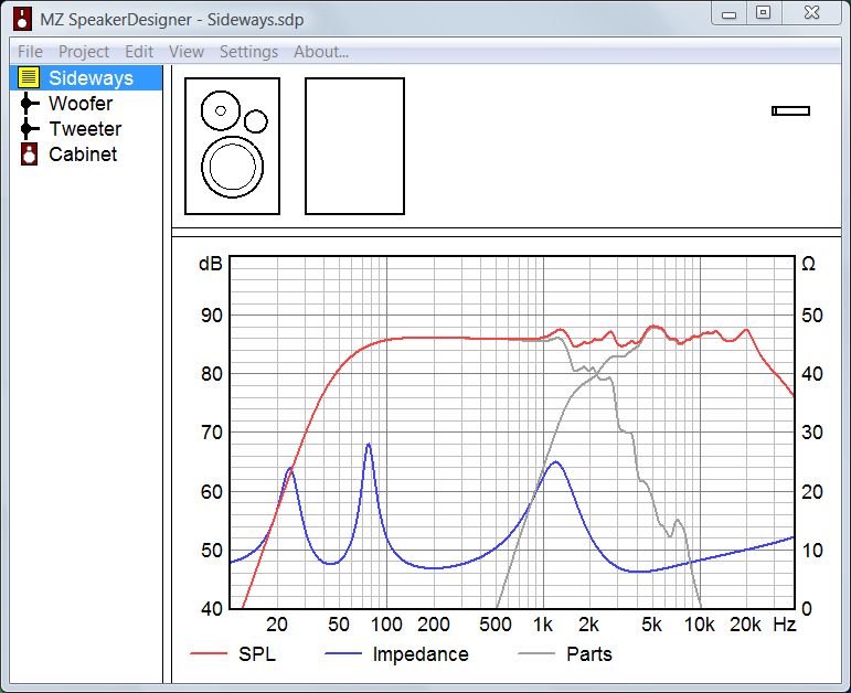

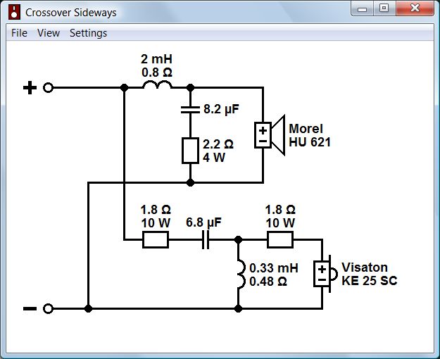

I was wondering if we can get that tweeter filter behaving more suitably and rolling off more steeply to avoid overlap with the bass. It can be done with a third order filter which I found in my archive. I enclose an example for future tweaking experiments. That scheme should match your Morel quite nicely, with some small tweeter diffraction effects not included here as it goes. Haven't modelled it for your particular tweeter, but that would be your starting point.

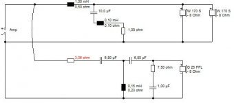

sideways, reference your query on good test values to try on the crossover, I include a sim.
you forgot a zobel for the inductor
Dissi have the zobel
but I would use bigger resistor
never less than driver dc
and the same goes for all my paralel inductors
on Dissi's xo, if you mount the 1R8 att resistors on either side of the inductor, after the series cap, maybe you could get away with slightly smaller cap, but only 'maybe'
it can be quite effective to fine adjust with those resistors
