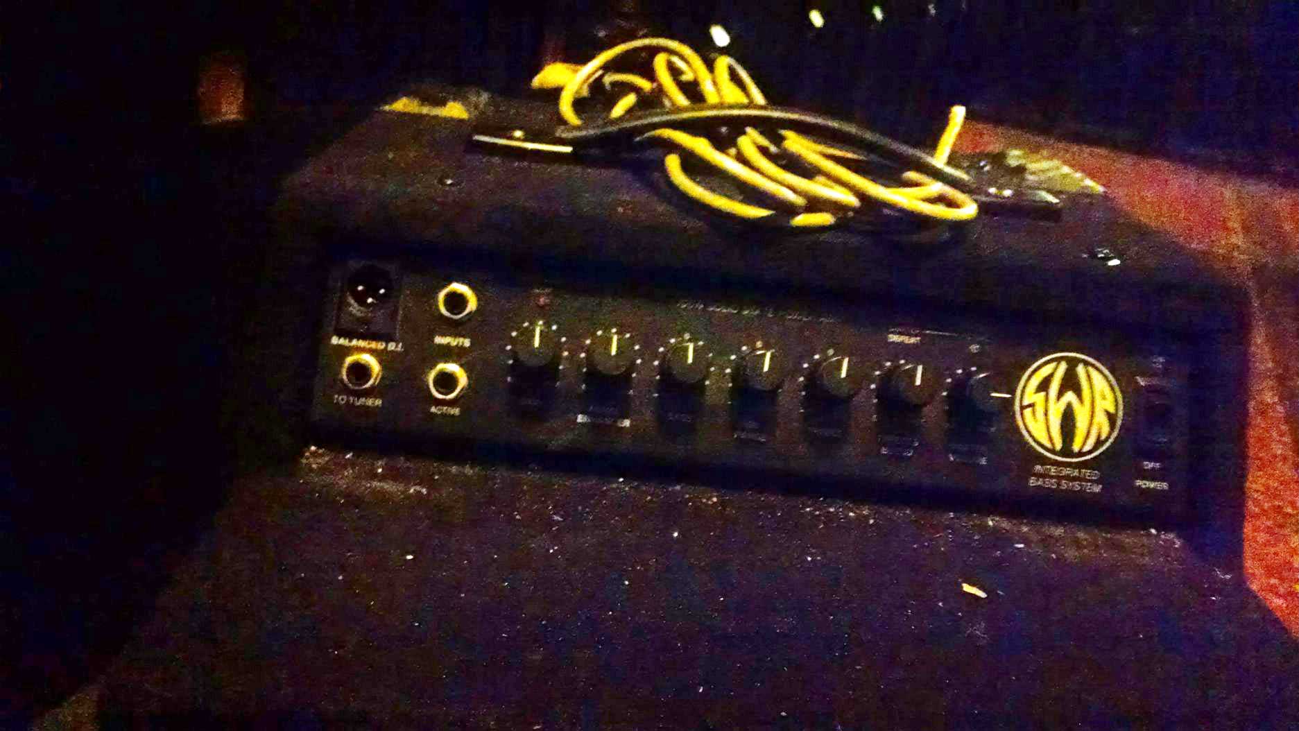

I'm repairing an SWR Workingman's 12 Combo for a friend. It has an annoying constant 60hz hum which is controlled by the level control - pot on the left side. If the pot is turned full CCW the hum goes away. The hum can be produced if nothing is plugged in, but level is at 12:00 O'clock.
Photo of the amp is attached.
All the other pots are at 12:00 O'clock but they don't affect the hum level much.
To me it looks like Preamp noise, since I can turn it off with the Level control. Power amp and PSU must be OK.

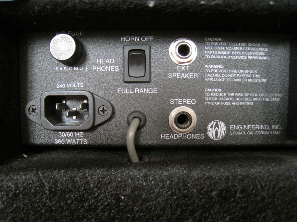

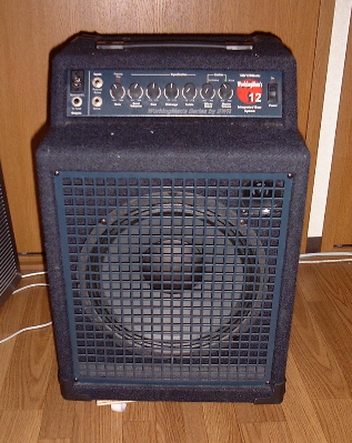

Here is what he is dealing with. This is why the only way I can see to remove the chassis is to disconnect the speaker leads. And the only way to do that is to access the speaker which is covered with carpet. How else is he to access the speaker? The enclosure is sealed on top so he cannot look down into the enclosure by sliding the chassis partway out without disconnecting the speaker.The chassis is mounted above a sealed enclosure, but there is a 1/4" gap between the chassis and the top of the enclosure, so it will slide out OK. I'm wondering why you are telling him not to do something he has established that will work in post #7. He needs help with the hum. swr-workingman-s-12-375685.jpg

Imagine the attached photo to not have the metal grill but carpet stretched over the speaker. I wanted to know if he could cut the carpet in the same shape of the opening, but to leave extra so it would wrap around the front to extend back on the sides to meet the speaker baffle as it is recessed from the front. Then he would glue it on and attach metal grill to fit the opening to cover the speaker. I sent him a link to a speaker place to see the grill style and told him there are others as well. He'll probably have to paint the wood and figure out spacers for the grill but I see no other way to do it. If you do, by all means it would be great to hear an alternative! Not sure why the OP won't post a pic, but maybe because we solved this part and he's waiting for advice on the hum issue? Maybe it was covered for some reason by a previous owner, who knows?
All of this because there is no jack to unhook the speaker as pictured two posts ago and because the entire speaker cab swr.jpg is enclosed except for the hole in the top for the speaker leads and of course for the speaker and horn. Easy to see speaker is front mounted.

You guys are making this WAY too difficult. To get at the circuitry, remove the four phillips head screws on the top of cabinet. After doing so, the amp section easily slides out forward. The cable going into the speaker cabinet that you are so worried about has a LOT of slack in it.. just gently pull out what you need as you slide the amp forward. If you need to remove the electronics completely, you can either unsolder the wire from the circuitry or remove the drivers from the front after removing the grill. You won't have to, though.
As far as the hum problem being described, you just have a bad ground strap wire across your input jacks. I'm going to take a wild guess that one or both of your input jacks is/are loose and that, when you attempted to tighten the narrow nut that holds them in place, the jacks spun a bit. When that happened, the bare ground wire that connects to the two input jacks, the tuner jack, and the ground on the board was stressed and either came unsoldered at one or more points or just broke. It's very easy to spot, and an easy repair. Just resolder the bad connection or run a new ground wire if necessary. Takes a couple minutes.
To prevent this from happening again, you could replace the input jacks if the plastic threads have become stripped, or, if they're still in good shape (doubtful), carefully snug them down again and just make sure you don't rotate those jacks in the future.
