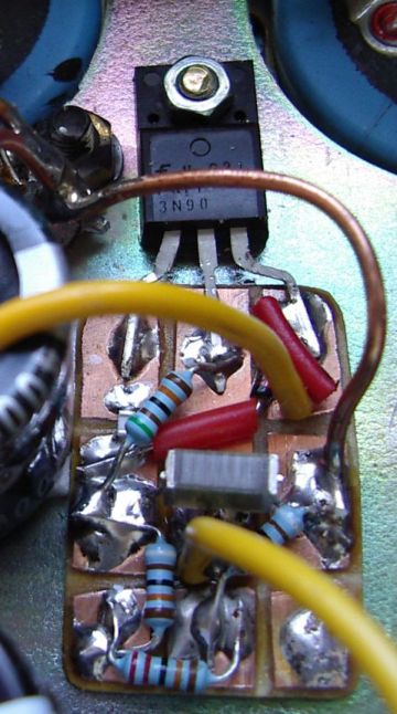

I don't like putting 500V on modern 6L6GCs, and even less on EL34s.
I explain this weakness to my customers, and many like to have a mod installed to drop the screen voltage - since the screen is the problem (even the modern ones can take it on the anode/plate).
Use a 900V TO-220 ISO packaged PowerMOS device bolted to the chassis and a potential divider (use high voltage resistors: 220..560K to gate, about 2M to ground). 47nF or so at the gate is enough in many guitar amps to do without a choke, if the incoming supply is not too rough. Feed the FET drain through a 5W+ 100ohm resistor and 1uF or more of adequately rated capacitor (MKP best here). At the source, 22uF to 68uF depending on the amp's power. A 10V gate protection zener (don't ever omit this) and 390ohms or so of gate resistor (noninductive, pref. chip resistor, right up at the gate pin) rounds off the design.
The pic shows such a gyrator nestling into a JCM800. The "PCB" is just blank copper FR4 with hacksawed tiles.
Set the voltage at 450V or less for good 6L6GCs, 400V or less for other 6L6/5881, and 390V for EL34s.
Even with 390V Vg2 on EL34PP (fixed bias) and 450V anode (plate) volts, you still get over 50W if the trafo is OK.
Dropping the screen volts hugely improves the durability of old high volt guitar amps, and if you use the protection components listed, the reliability of the dropper/gyrator is perfect. And, players are very happy with the sound, most importantly!
