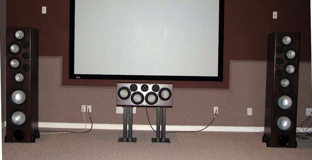

So if you used the Peerless as a woofer, I was thinking of WMTMW for the FR, FL and CC and MTM as your surrounds. Plus 2 subs.

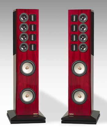

If you used the Seas as both mid and woofer, I was thinking WWMTMWW for FR, FL and CC with something smaller at the back like MTM, TMWW or WMTMW depending on space (actually, these surrounds would work in the above scenario too). Possibly MTTM or some variant if the surrounds are wall mounted and don't require much baffle step compensation if at all. Plus subs.

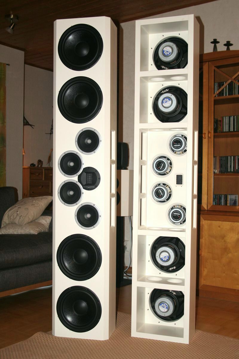

Now if you really wanted to go over the top, you could use 4 each of the mids and tweeters which would be like a small line array which would mean even less being asked from each driver and therefore a little cleaner output from each. And when SPL's are way up there, you won't be running into any sort of compression or lack of dynamic range when the speakers are asked to play just a little louder. But to be clear again, I'm not 100% sure if this kind of design requires some extra trickery in the xo so input more knowledgeable than mine would be required.
Now in terms of the tweeter, think of it as perhaps having the easiest job. You simply don't need a large diaphragm or lots of excursion for the highest frequencies. So if the tweeter is also at 90dB sensitivity then 64W will also result in 105dB so it will have no problem keeping up with all those mids as long as it's the kind of tweeter that can handle that kind of power. Looking at your specific tweeter it's rated for 90W of continuous power and peaks of 220W. So a single tweeter should work well. But if you wanted to use more than 1, well that's just icing on the cake.
Make sense?

With a construction like this, the mids and the woofers share a common enclosure that is vented? I have done a bit of reading of MJK's work on TL, and have his sheets, I haven't really looked much at basic ported enclosures.
You've been a lot of help thank you, things are slowly clearing up in my mind
That makes a lot of sense, will have to suss out how many of the Peerless I have. And the size I can fit in the surrounds.
No, woofers and mids always need their own enclosure. Whether sealed or ported depends on the drivers and what frequencies each driver is trying to reproduce.
In general, a sealed enclosure will sound better than a ported one, quality-wise but a ported one will dig deeper. For the mids since you don't need them to dig deep, go sealed. If the Peerless are the woofers, also go sealed since they should go low enough for at least a 80Hz xo that way. If the woofers are the Seas, go ported as they will need that to get that low although that may depend on which set of TS parameters you go with. Measured ones are best but you have to make sure they are accurate and the drivers are well broken in.
I even think subdividing the Seas woofer enclosures into 2 x 2 woofers is a good idea. This way it gives you some tuning flexibility by being able to plug just one port if the bass sounds a little overdone.

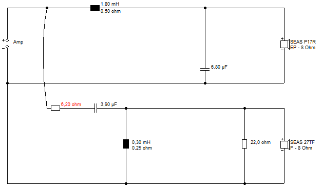

Andrew, I think you lack a plan here. 6.5" SEAS polycone and SEAS 27TFF ought not to be too hard.
You've already seen a couple of likely crossovers.
Your own Joe Rasmussen is quite experienced at the bassy 2.5 way variations, and MTM is just a simple maths conversion on the MT filter values.
Does something along Elsinore lines appeal?

This looks like it's probably pretty close to the model I have, I can't find the manufacturers specs on the model, I know it was made prior to 2004, but other than that... Looking at the provided frequency response, It starts to roll off below 80hz, and has a hump just above 400hz, so I can probably work with that as a woofer in the main speakers. I don't have anything to measure frequency atm, but to my ear it sounds reasonable in the range I'm interested in. Will investigate subwoofer options.
Yes, there is a lot of good information in the Elsinore write up. Same type of 2.5-way design as the Uluwatu but with 2 less drivers. You can indeed choose to go with 2.5-way design. The advantage of the 3-way means that the mids will be cleaner - they won't have to also be producing the LF at the same time. I expect one would notice the difference if it is just a TMM whereas it will probably just be a small improvement if the LF are distributed over multiple drivers like a TMMMM like the Elsinore or a TMMMMMM like the Uluwatu.
This older Peerless XLS, View attachment 527498 , might be closer to what you have but you are definitely going to have to measure the FR too. The specs look better on the Seas this time but you should perhaps work in more than a few of each driver, measure them and then take the averages. Consistency is going to be important when using multiple drivers.
