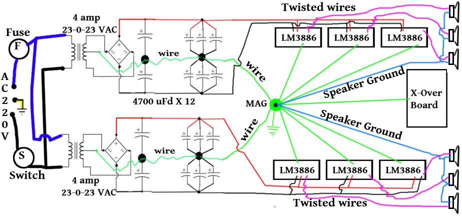

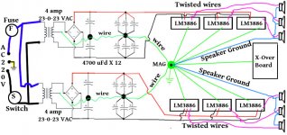

The Incoming PE (green/yellow) goes directly and permanently to Chassis. This is the Safety Earth.
You also need a Main Audio Ground to Chassis connection just in case some mains voltage gets on to your audio circuits. All exposed conductive parts must be connected to PE.
This can be a direct connection from any part of the Power Ground to the any part of the Chassis. But this route MUST be capable of passing Fault Current until the Mains Fuse has ruptured and the arc extinguished. This route can pass kA of current. A resistor cannot pass this current !!!!!!!!
Dear Sir,
This will be the final wiring layout. Please correct my mistakes.
Thank you.

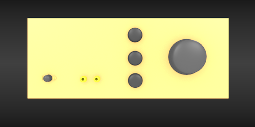

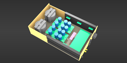

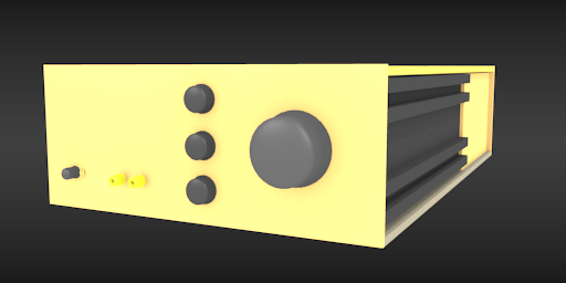

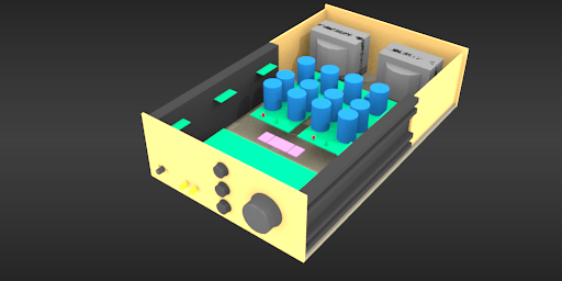

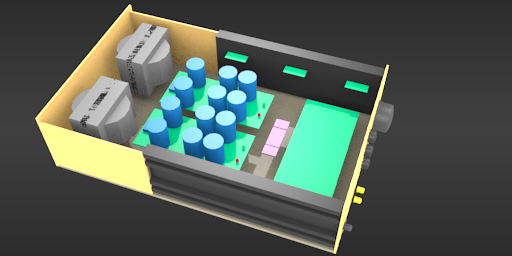

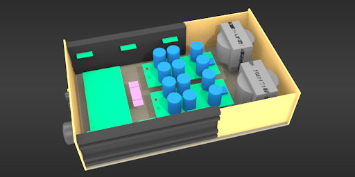

I am trying to make a 3d model with an approximate ratio of the final thing to be built. And the result is not so optimistic yet.
Here are some snaps.
And best wishes for your build too. Kindly post some photos of your build at your convenience. :)

post62 looks good.
One final comment about twisted wire pairs.
Some of the pairs are actually triplets.
The three wires from transformer to rectifier, the three wires from rectifier to first stage smoothing, the three wires from first stage smoothing to second stage smoothing, the three wires from second stage smoothing to amplifier.
Note also the three speaker Returns should all be twisted with their respective Flow, NOT commoned.

Oh thank you very much Sir for this much awaited reply.
I was unsure of the Speaker Returns from Mr Mile's circuit. Now its very clear.

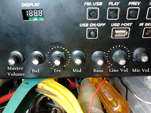

Meanwhile, the preamp section with microphone input is finished and housed in a separate metal cabinet.
Working very nicely.

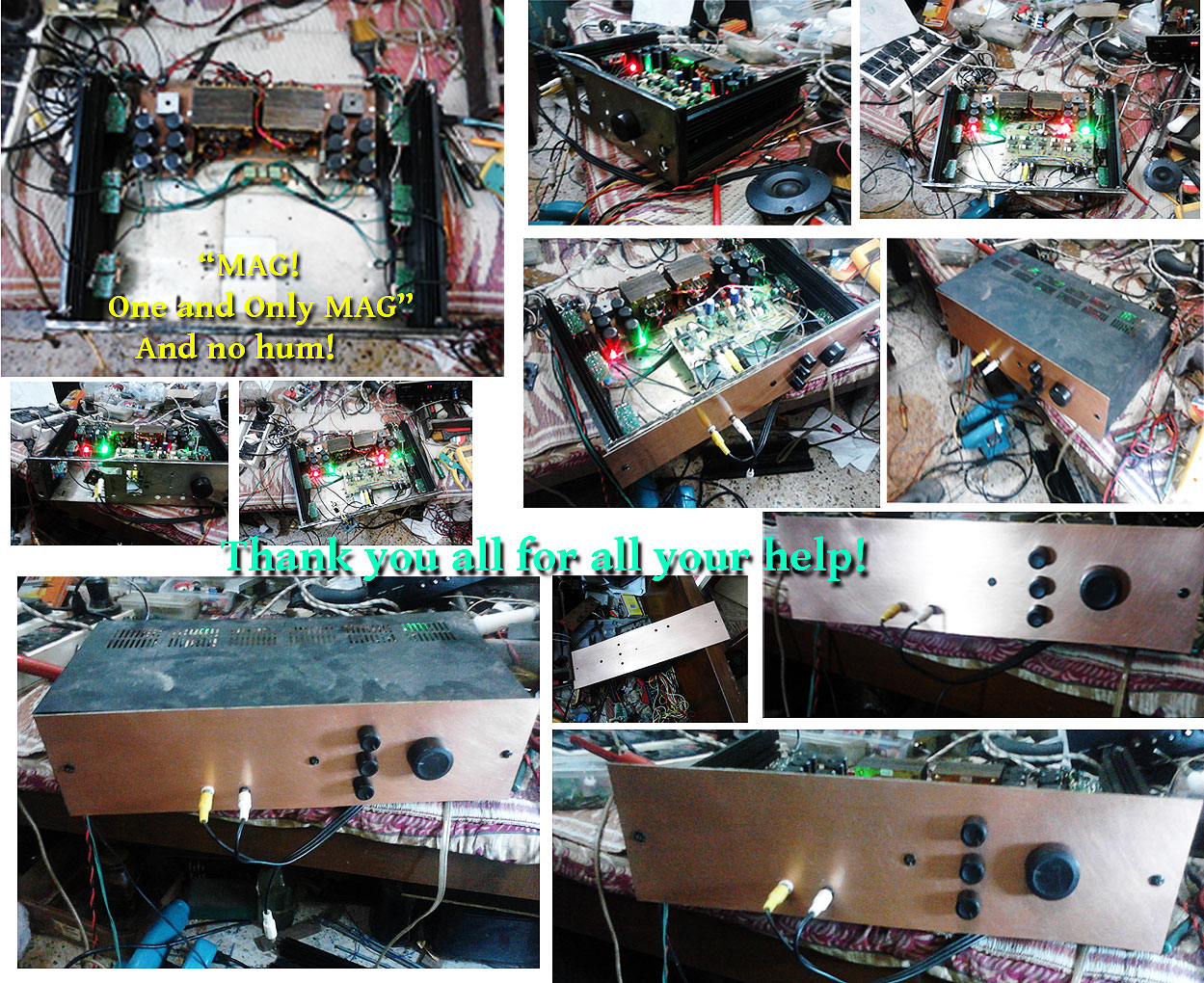

Final Wiring done. Now using two Transformers.
One 4 amp transformer for each channel.
But no perceivable difference in sound.
The sound is still mind blowing as usual.
Thank God, Sir AndrewT was there to kindly correct my grounding plan of the amp.
Can you believe there is no hum or any kind of distortion or clipping even at the maximum volume? !!!
The preamp is behaving very nicely after it was fixed by the advice of our respected Moderator Sir Mooly.
I have no "great" tweeters. And they are low wattage. But with Active X-over they perform very nicely.
I blew two of them as I mistakenly connected them to the woofer output and did a "hum" check by touching the signal input. Silly me.
LM3886 with its monstrous power is ruthless hence. :)

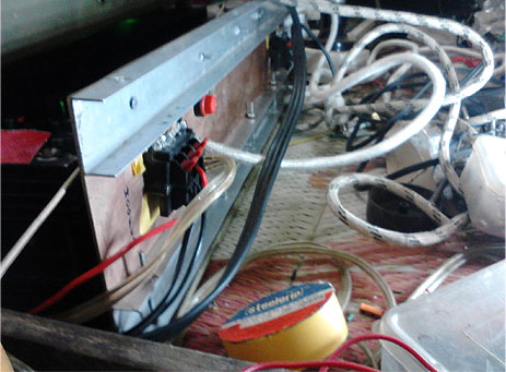

Thank you Sir.
The problem is I can find only what is locally available here and most of them are unreliable cheap craps. And as you've rightly guessed,I am tight on cash after making this beast. :)
I have not shared ground wire rather twisted them as per the advice of Sir Andrew. So six wires per channel.
I found a 6 pin connector ( not too bad ) and using it for the time being.
