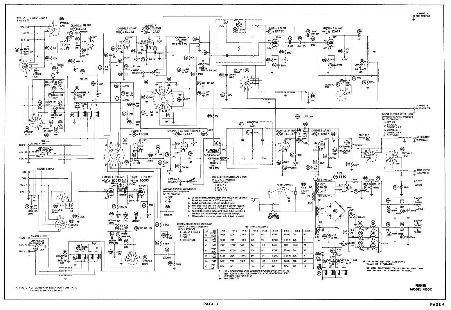

That Fisher buffer is using a ax7 the right way, low gain, fab smooth tone....

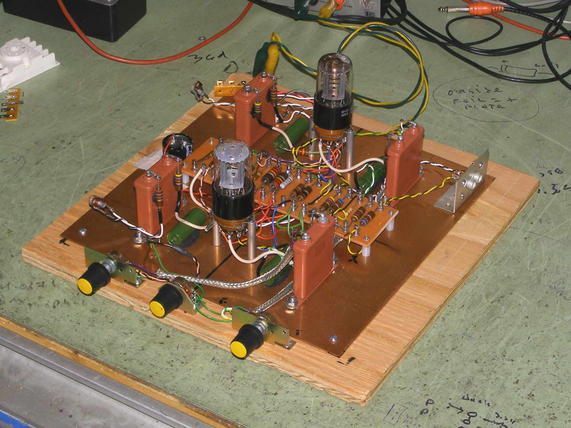

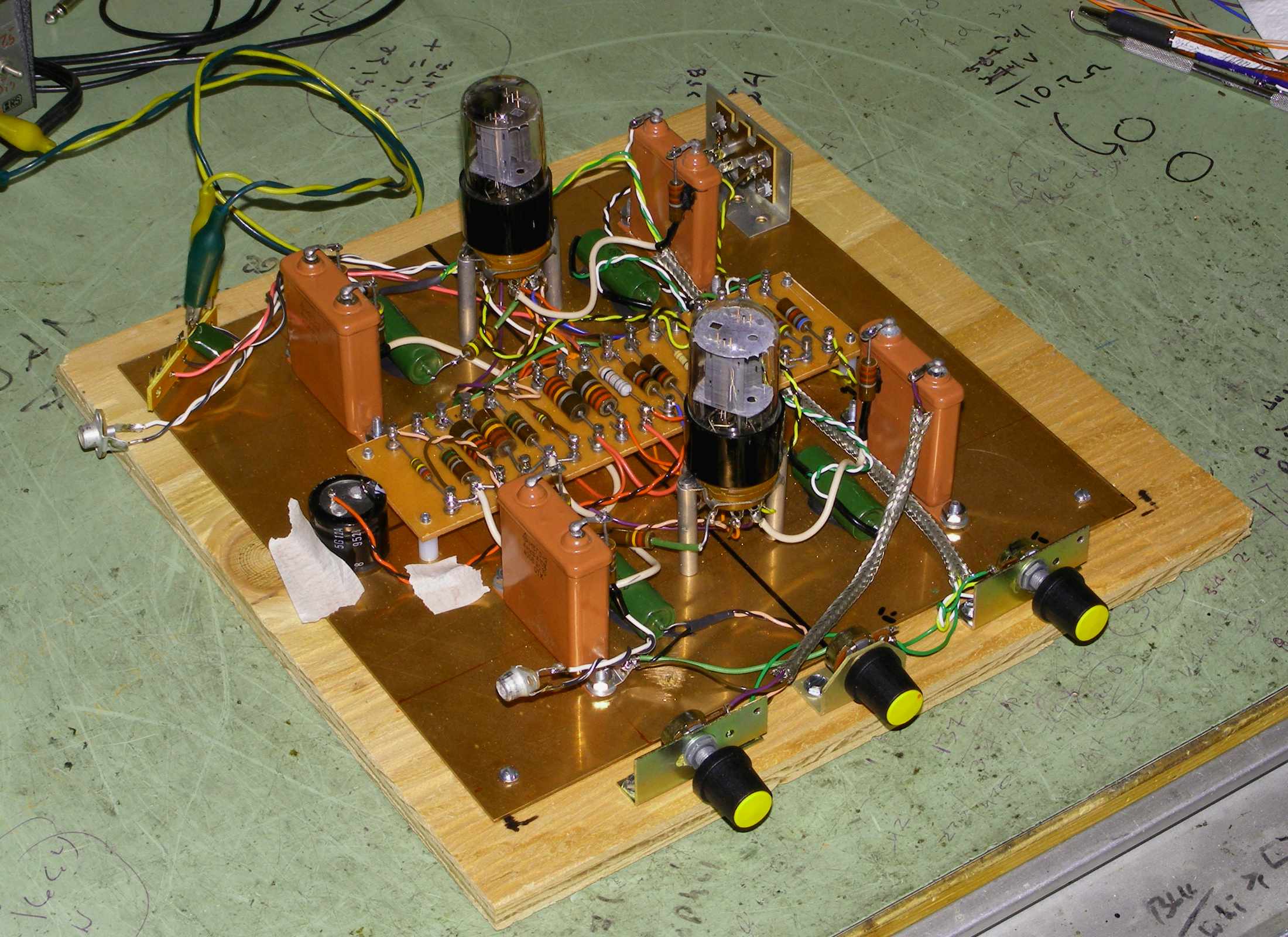

Here are two pics of a typical "Brute Force" 6sn7 line stage chassis being tested, my "woody" test bed.
Russian paper-oil caps, big carbon resistors, high idle current, big big sound.
Best is to be able to switch different tubes in/out, and even various coupling caps as then you can get the kind of response character for that special Jazz Sax solo etc. as one tube or coupling cap or circuit design is not best for everything, hopefully it will have a good sound that is enjoyable

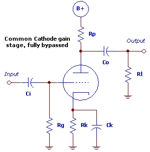

The "Puddle Effect" is when you have a pool of electrons, like water in a lake, and for various reasons, the puddle of electrons and the surface of the lake is not steady.
Electron flow through a triode/tube can vary due to unsteady B+, filament, the filament in the tube, conductivity of the cathode and plate, unsteady grid support and more.
Then if you have a basic tube gain stage and add a cap across the cathode, a pool of electrons is at the ground end, and they flow from negative, ground to positive, the plate, or B+.
Since everything is tied to ground, including the AC, ground itself can be unsteady, and that transfers to the negative side of any cap tied to ground, then to the other end to the cathode, making the circuit unsteady.
Capacitors themselves can be unsteady depending on dialectrics, quality, age etc., or just the fact that a pile of electrons is not steady also.
I use Mr. scope, and Mr. oscillator, and also two old tube signal tracers to "Listen" to circuits, and also that big meter on my trusty Simpson 260.
Some time ago, I was re-building a Fender amp, can't remember what model after doing so many, and I was tuning up the two 6l6 output stage. I was measuring the voltage at the plates, with my trusty Simpson 260, with it's large meter, and I noticed that the voltage drop across the output transformer winding was wiggling. This showed me that the output stage, typical in guitar amps, was unstable.
I inserted a 33 Ohm resistor in series with the cathode of each 6l6, and the small bit of negative feedback at the cathodes made the tubes rock stable. The amp also sounded warmer, as the dynamic response of the tubes was slowed down a bit.
I have used the trick of inserting from 12 to 75 ohms in between cathod and ground in many guitar amp modding jobs, to get a much warmer sound, and quieter.
If you look at the diagram, take Ck off, and the electron flow from ground to B+ is fairly linear, steady, and the response character to differing waveforms, the transient response is pretty linear, or similar over a broad frequency range.
When you attach Ck, then you are introducing the response character of the cap to the circuit, and since varying voltage to the cathode, then the cap is controlling the tube, making it follow it's response character.
If you have say three stages in a row, the response character of each cap is not equal, and since the voltage varyance is not equal across each cap, then from in to out, you will add in the varying responses to signal change, and waveform of the caps.
Adding a small amount, 47 ohm to 330 ohm, in between the cathode, and Rk/Ck, that small amount of resistance acts like a shock absorber and smooths transient response out, allows the tube to push back also.

A 100Mfd cap is 100Mfd because it can store enough electrons to flow out from negative to positive in a given time. A 10Mfd can store about 1/10th that, a 1mfd, 1/100th that.
So, when you connect a 100mfd cap to the cathode, you are connecting a two plates, foil device, one side with a pile of electrons hooked to ground, the other side, with no electrons to the cathode. The ground is this pool of electrons, that gets bigger with everything else connected to it.
So, then driving AC through that cap, is like having a speaker above a pond,
nice flat water, and driving audio down towards bottom, or actually maybe up.
If the water is such, maybe dense enough, then the audio will flow through the water without too much change and come out clear at the other side.
If the water is not dense, or very active, then many responding vibrations will
add distortions to the audio waves.
So the response character to electron flow of a cap will modulate the cathode and drive the tube, making the tube respond to the characer of the cap, adding it's artifacts to the signal.
If you look at older "Vintage" audio circuits, they used smaller coupling caps
and higher impedance loads, .022mfd into 500k to 1 meg, maybe .22mfd into
220 to 330K, for economy, and sometimes the need for smaller caps in tight
spaces, but also, smaller caps have faster response character, than bigger values like 2.2Mfd into a 50K load.
I build line stages with1 to 2 mfd Paper Oil in caps, and 4 to 8Mfd PIO out caps, as you do get a much bigger low end dynamic running low impedance, but these are PIO or metal poly caps, not electroylitic caps.
I use two different valies on either side of the in/out caps, because the grid of
the tube is much higher impedance. The plate is lower impedance than the load on the other side, so current response character on either side of the cap is different, then different value resistors.
I do not do more than sketching out a design first, untill I am pretty sure of what it should be, and then I build it. I use the customer's ears, and actual live performance as my guide, no CAD stuff.

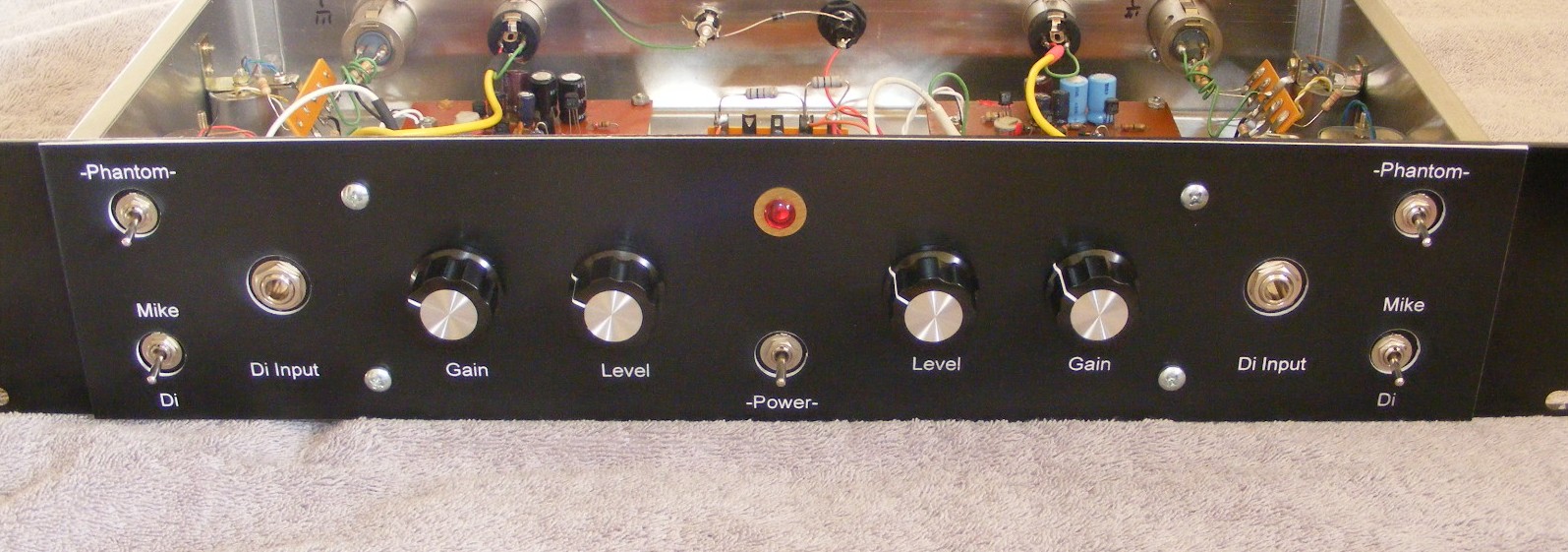

I built about 22 of these transistor stereo mike preamps, DI's, EQ's and more all without any software, just what I learned by build and test, and I have zero returns, almost all is being used constantly.
I also built a small number of these vintage preamps, all used constantly, never and problems, five-pin tubes really great sound, no software, just build and test, and let the studios tell me what.
I worked on Marshall 200 watt, Plush 300 Watt, Hiwatt, Sound City, Fender et. all in the 1970's so around HV and big tubes from early on.
I go by the old tube manuals I have and vintage circuit design also.

As I said, 'water in pipes' analogies are used for teaching complete newbies. Continuing with that analogy has led you astray. Electrons don't behave like water.
