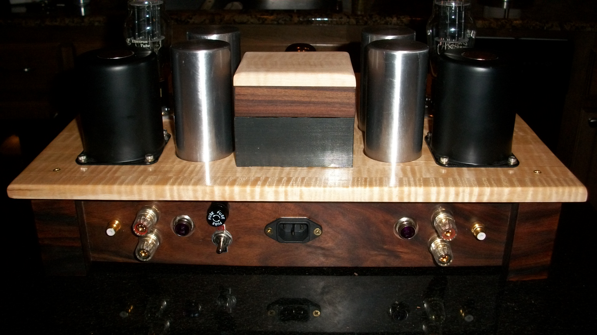

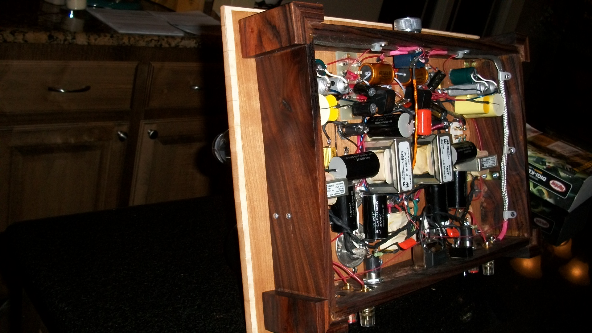

I noticed from your photographs that you have used shielded cables from the plate circuit of the input tube to the grid of your 2A3. I have found in the past that the capacitance of this cable can cause the 2A3 to oscillate, i.e. it goes unstable. To overcome this problem, you need to position R9 in you schematic so that it is physically connected directly on the pin of the 2A3 socket, so the grid of the 2A3 see’s R9 before it sees the capacitance of the shielded cable.
Another point I noticed is that the input tube grid is DC coupled to the input connector, which can produce problems if your pre-amp has any DC voltage on its output that will effectively change the bias of the input tube. I suggest that you add a capacitor of say 0.1uF (a film type) in series with the input connector just to make sure that this does not happen. Hope this help.
