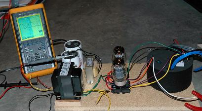

Here's a snapshot of some KT88s in push-pull CFB using Plitron "specialist range" transformers. They are being driven with an LL1660S interstage transformer.
A future project is to finish my "dream amplifier" using these components. Right now, the majority of the work is packaging (chassis) and layout. I have all the parts - power transformer, capacitors, chokes, tubes, sockets, interstage transformer, and output transformer. I'll probably drive the interstage transformer with a Broskie Akikdo linestage.

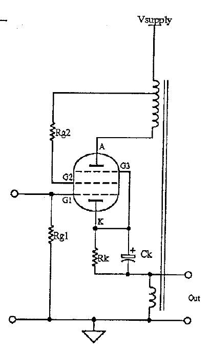

FYI, here's another great article on CFB, courtesy of the Lundahl folks. Attached schematic of EL34 in CFB single-ended configuration.

Kashmire, I use a very similar circuit in the Simple SE. The DC current drawn by the tube through the secondary of the OPT will drop a small voltage across the secondary due to its DC resistance. There are a few people who claim that this small DC voltage can cause a problem with some high efficiency speakers. I don't notice any problem, but my speakers are not high efficiency.
There is however a simple solution. Connect the cathode resistor to ground, but leave the bypass capacitor connected to the OPT secondary. This gets the DC out of the OPT secondary, but now the cathode resistor is effectively in parallel with the output. This will lower the output power by a few milliwatts.
Oh! That's really nice! Separate DC and AC pathways. That's an elegant solution. May be possible using push-pull also, if you have a reason to eliminate the bias currents from the secondary (although I can't think of a good reason).
