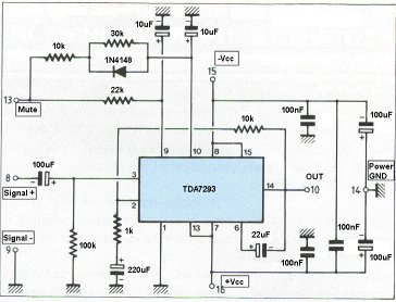

Need help on this TDA7293 schematic
I've edited this schematic taken from a magazine which has taken it from the TDA7294 datasheet and tried to adapt it to TDA7293.
I would simply like to have your feedback about it. I'm not very sure about the bootstrap / bootloader stuff and an some expert's comments about the schematic in general would be more than welcome.
Thank you !
Thank you !

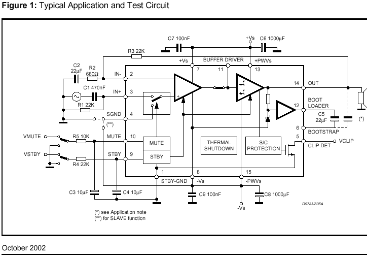

First.
Here is download of TDA7293 datasheet TDA7293 PDF Datasheet
TDA7293 is almost the same IC as TDA7294 or TDA7294S
So I guess the circuits are about the same too.
Here is RECOMMENDED application
You always get less problems when staying with recommended circuit.
It is when you start tweak and think you can
make it 10 times better, than the professional people
you can get into some little troubles.
Like burning a couple of ICs and stuff!
Do not underestimate those who write the Datasheet for these
BIG companies. They are certainly no dumb-heads!
I would not say it is impossible to improve
with some few % percent or promille.
Or something like that :D :D :D :D
I recommend you to download TDA7293 datasheet - It is already hard to find on the Webb -
Read all of it. How you can modify component values ...
Do not take the SHORTCUT:
staying WITHOUT KNOWLEDGE about the Component you are going to use.
Here is recommended normal application for TDA7293:

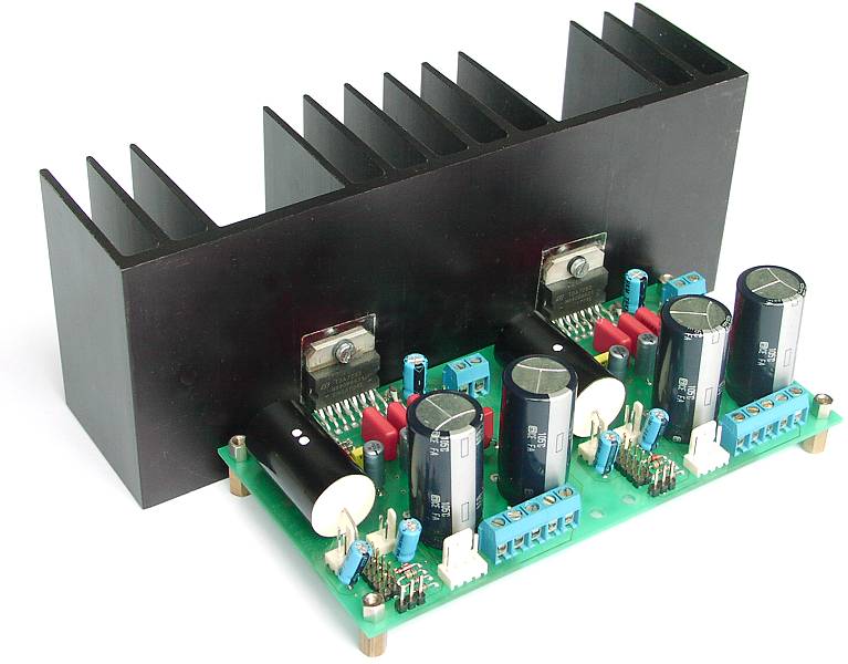

Endstufen - UB Elektronik
Ultich Böhmke Elektronik
Endstufe 100
Datenblatt für Rev. 1.10 (789KB) Platine wird nicht mehr ausgeliefert!
Datenblatt für Rev. 1.11 (1,5MB) neueste Auflage
DMOS-Endstufe 100 W (bis 300 W durch Brücke/Parallelschaltung) mit TDA 7293. Gute Meßwerte und Super-Klang. Sehr kompakter Aufbau für vielseitige Anwendung, insbesondere BiAmping und Aktivlautsprecher.
Output Endstage 100
100W (300W bridged/parallel) with TDA7293
for you who doesn't know Deutsch (halojoy does!)
He also have some "VorVerstärker" PreAmplifiers.
Hier ist das Bild von "Endstufe 100"
Here is the image of "EndStage 100"
