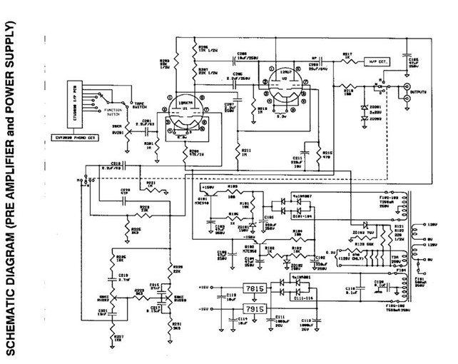

AMC CVT-1030 schematic headphone amplifier
milen007 said:
need help on suggested improvement on capacitor or diode.
schematic are attached.

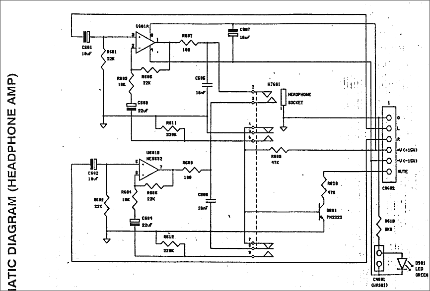

Depending how old this amplifier is, it can be a good idea
to replace all electrolytic capacitors.
Such Caps have liquid inside and so Dry Out year by year.
Other, solid and plastic capacitors do not age.
But if your amplifier is very old, a change to modern types might be an idea.
The improvement, in this case,
might be anything from no improvment to some little improvement.
See my AMC CVT 1030 headphone amp shematic attachment.
CVT 1030 has got a NE5532 Op-Amp based headphone amp.
For a cheap and easy upgrade of this headphone amplifier
I recommend this:
1. Replace Op-Amp with OPA2134.
In this case are no problems without any circuit modifications.
2. Replace those polarized 5 capacitors.
They have values 10uF and 22uF
Regards :)

My experience is that fast rectifiers in the power supply generally produce better sound. I never tried Hexfreds, just Schottkys. But rectifiers are not the only factor determining the sound. Other passive components like electrolytic capacitors are also important.

changing op-amp dont change the overall sound right? only for headphone?
do you mod your 1030? mind sharing? thx
regards,
milen

Heh, I just bought 1030 A because I guess I'm an anti-purist & like bass & treble controls:) Oh, and I'm frugal, so $250 USD seemed nice. I feel its not a bad sounding preamp, but I've little experience.
Those caps look like the coupling & feedback 2.2µF polys & as above, don't age like electrolytics. And for myself, I'd agree on the above bit - that you may notice improvement w/their replacement depending on your ear & upstream/downstream components...
A nice upgrade could be some Sonicaps from:
http://www.soniccraft.com/sonicaps.htm
They are highly-regarded for the price & I've used them in a couple builds, but not really sure I could tell them apart in dbl-blind A/B comparisons... At least I know they aren't holding the sound back;)
AND, I'd 2nd the bit about possibly going after the electrolytics/cans... Esp. if they are in the signal path AND we know they are getting old.
