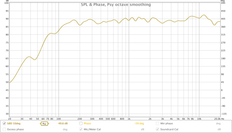

Especially some that measure so well... There is no EQ whatsoever here, the only thing I did was to measure 10 degrees off. Straight on has a slight rise after 10kHz, but a 10 degrees tilt makes it almost flat. That is a well-behaved driver. No shout, no need for a notch anywhere.
After taking a look at WinISD, I think those B80 would like to be in a 6 litres vented box instead... they feel a little cramped in the original Nola clone version.
I also checked them in a MLTL, but T/S values were a bit off... online it says Qts of 0.63, but the drivers I got have a Qts of 0.81.

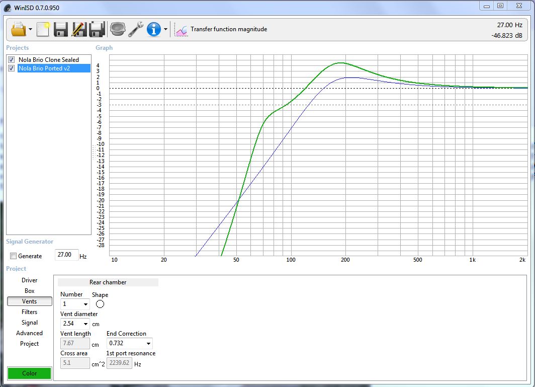

Hey guys... can anyone help me understand why these are ported? I'm building these and decided to model the lower box in WinISD. Looking at the graphs (assuming I'm modeling these right--my first time) it appears that sealed is the way to go (I'm crossing over with a sub-- 8" Dayton audio). Am I missing something? I don't think it helps with baffle-step comp as a width of ~5.5" isn't close to the "hump" caused by the port as far as I can figure...
What does the port gain you in this speaker vs sealed besides a steeper slope and what appears to me as uneven response?

I'd still like to know the why behind Nola's decision to port these as well as why my model shows a "hump" in the frequency response?
The attached image shows my sealed vs ported (green line) model.

Sealed, you are looking at 150Hz then the TC9 starts falling down. At 150Hz, I start to hear where the bass is coming from. So, if you have a single sub on the right or left side only, I would feel the unbalanced sound.
Going vented, that "hump" will be picked up. by the room and enhanced, giving you a reach closer to 100Hz, which is easier to cross to a single sub.
Also, are you sure the Nola clones are a good match to put in a corner of a room? The OB design will probably not fare well in a corner...

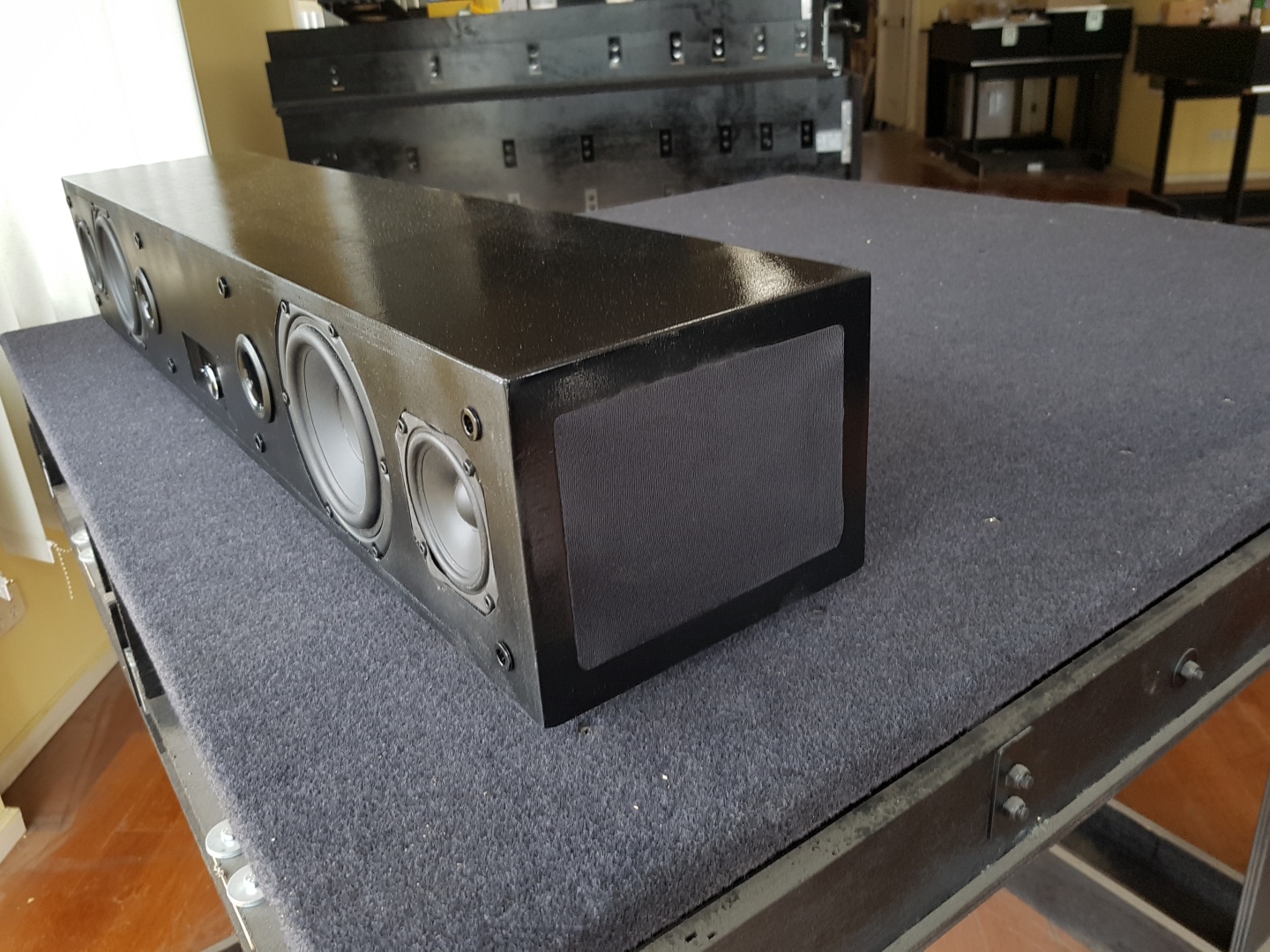

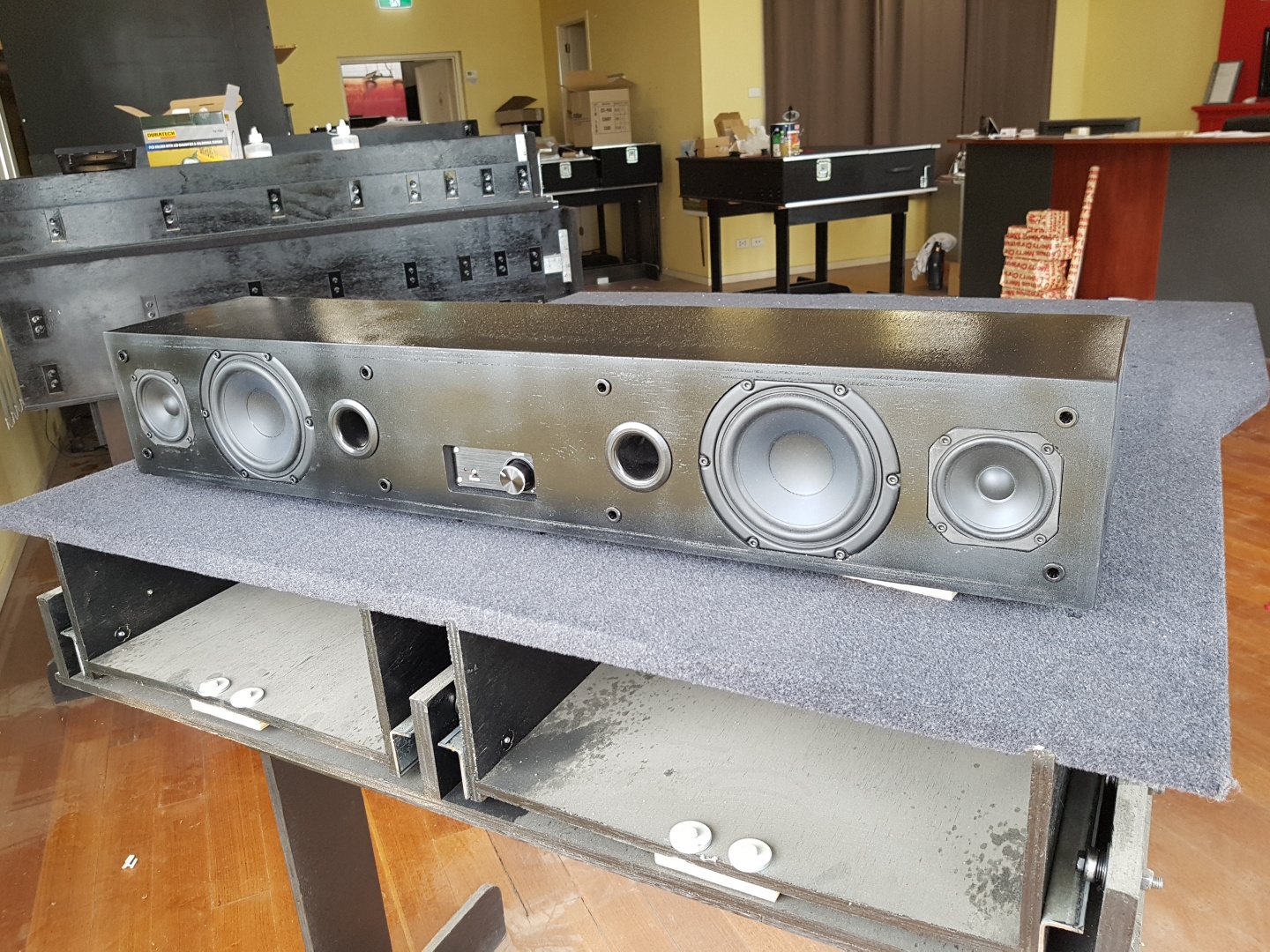

I used a variation on this idea to knock up a soundbar. Waiting on some caps and inductors to cross it over at 900 HZ. But even running some off the shelf crossovers that I had kicking around, which cross at 2.5 KHZ it sounds pretty good. The little 3116 cuts out at moderate volume which may improve once I fix the crossovers but I also have a better amp and power supply on order.
