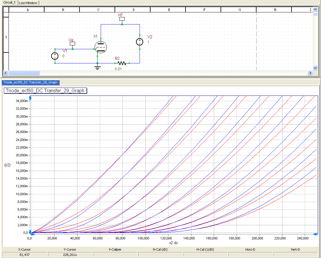

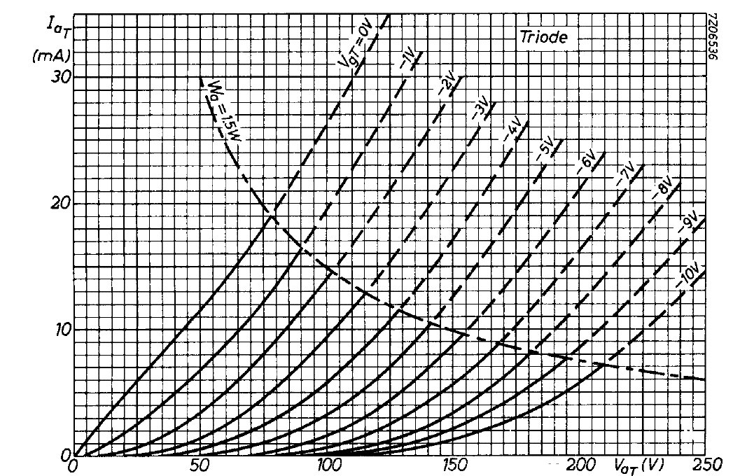

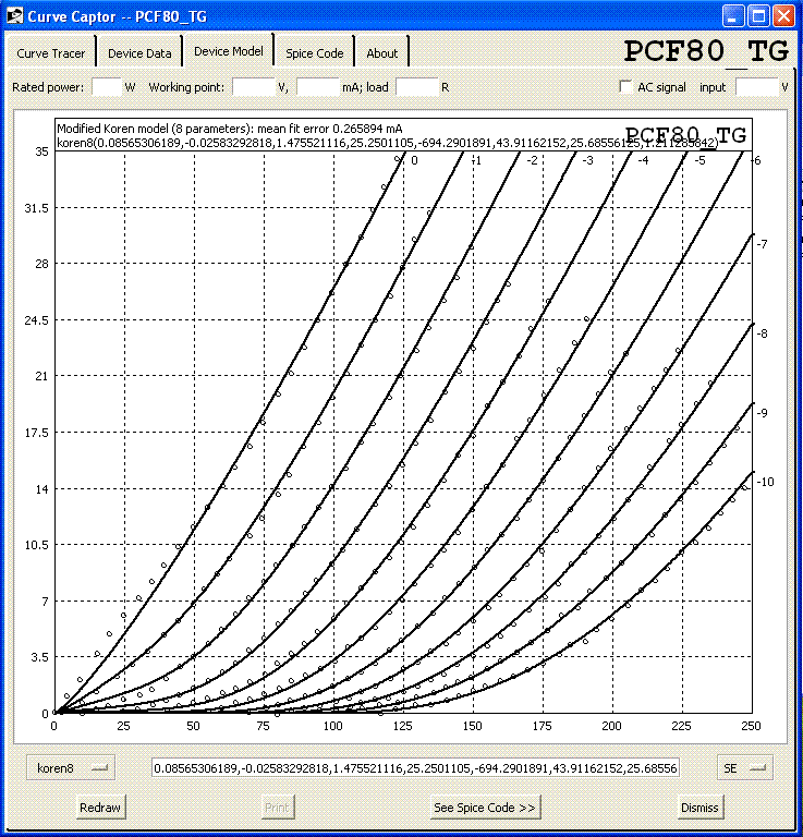

PS: I forgot ... here is my ECF80 triode model (home made - curve captor)
* ecf80t macro model
.subckt ecf80t P G K
koren8(0.08514807115,0.02125688214,2.432606355,18.12988992,-515.1539346,47.41376622,32.41199296,1.230822006)
.ends ecf80t
* ecf80t CircuitMaker model
Bp P K I=(0.08514807115/1.0e3)*uramp(V(P,K)*ln(1.0+(0.02125688214)+exp((2.432606355)+(2.432606355)*((18.12988992)+(-515.1539346/1.0e3)*V(G,K))*V(G,K)/sqrt((47.41376622)^2+(V(P,K)-(32.41199296))^2)))/(2.432606355))^(1.230822006)
.ends ecf80t

I make the models myself using excel spreadsheets I have developed over the years.
When I extract data from spec sheets I use curve captor. Obviously it does not do the pentode models for me, but it is still very useful for digitizing the data.
To convert the models to 3f4 I deleted the PARAMS line, and substituted the actual numerical value for each parameter in the spice code.
I have tried bothe models it LTspice and in MicroCap 6, and they work OK there, but they are not 3f4.
I dont know why 6BL8 gives more trouble than ECF80.
I will have to dig out my old notes, and come up with a proper translation.
curvecaptor's circuitmaker output works just fine. Maybe it can help you to translate.

Works! But unexpected results...
Dear Robert,
Thanks a lot! The last model run now without any error. I checked also the dummy models ( very good idea! ) to ensure I created the part correctly.
I downloaded the "Curve Capture" and create an own ECF_80 triode model. For that I used the PCF80 datasheed; It´s a amazing programm but without any dokumentation. So It took me a while to understand how to load a image ( In fact I read the source to find it.. :) )
The model works for DC-sweep as expected. I draw the plate cure with b2spice program using the model. The compare between datasheed, "Curve captor" and b2spice simulation is very good. So I should assume, that the AC or static DC "in circuit" simulation will work.
Well, try to evaluate a Cathode follower using the triode and datasheed to define working point the simulation return an unexpected value.
The grid is 129V ( from a plate of a pentode DC coupled ), HT 250V. I chouse a 18K value for the Rk to get an center based WP at Ug=129V.
Using your and my model URk and IRk are 0! Using a 12au7a model with same values it works; URk = 131V and IRk=7,295mA.
I assume that there is something wrong with b2spice; May be I exceed some values... Now it´s time to build the hardware, see if theory and reality match.
So again: Thank you verry much for your help, your patience with an spice newcomer and.. with my bad english
Best regards
Karsten
