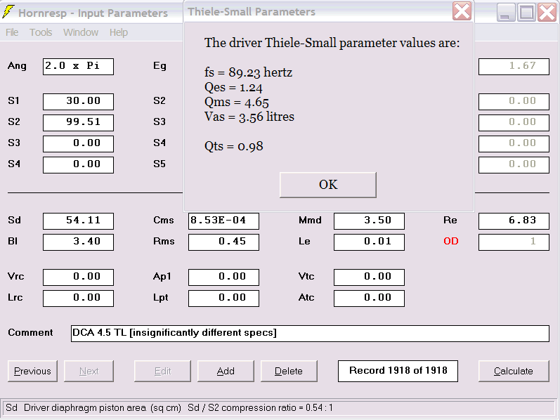

The math I've posted should be what's in my Excel SS and recall Svante approving all of it one of the times I've posted it plus it lines up with HR and others when the same po and SoS is used.
Anyway, now that I know which column is Vas, BL, it all lines up when inputting them, not that it makes any difference WRT cab design, just now Qms is off a fraction and the calc'd Cms values are way off:
