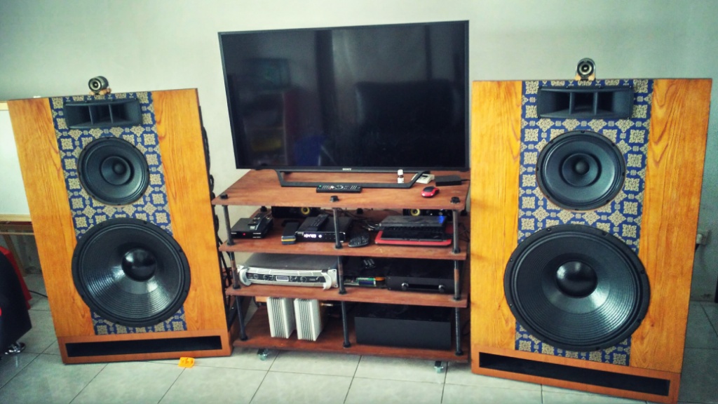

I'm trying to reach my upper limit on speaker league, not that my current speaker is not good, i just want to get my conclusion that it's enough (my conclusion after building several class a amplifier).
my current speaker (posted on another thread too): 32" x 48" plain open baffle:
- 21" subwoofer driven by inuke nu3000dsp
- 12" Fane 12-200LT 1st order LP (inductor value option 1.2mH, 1.5mH, 1.8mH).
- Fostex FD600 & H550 horn with 1st order HP (caps value option 6.8uF, 8.2uF, 10uF)
- Fostex T90A with 1uf filter
I change LP and HP value based on my mood, no fixed value yet. they are driven by class a amplifier
Lowther is planned to replace 12" & horn tweeter, T90A will be kept and should be a good company. It is expected to bring me to a new nirvana.
Why Lowther? because i can buy it locally.
I'm sure that there are so many Lowther owner who previously used a driver that might be considered in lower class (which is usually cheaper), whether smaller size 4"-5" or bigger size 10"-12".
Can you share your experience? Are you satisfied or disappointed? Would you suggest me to get a Lowther?
btw my first thought on Lowther for OB is PM6A or might increased the budget into DX4.

If nothing else, Lowthers are definitely an acquired taste, and I think you'd want to hear a properly designed system using them before deciding to join that club.
I'd dare say that to replace the 12" woofer and compression driver horn mid/tweeter in pictured system would be a very heavy lift for any Lowther, AER or equivalent full-range driver, and would certainly require major reworking of XO and tailoring of system gain settings.

at this moment, no one from my audio friend who owns lowther yet. I'm trying to reach out on my colleague who might have known someone who allow me to listen to his lowther. my thought that lowther will has no xo at all, only a helper by t90a+1uf.
