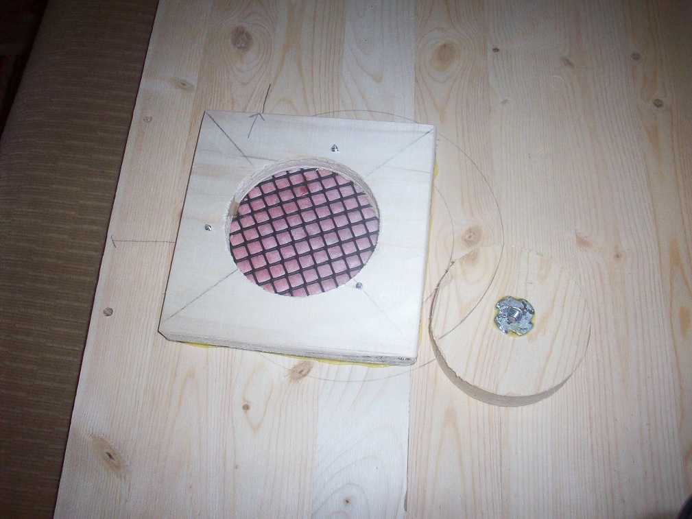

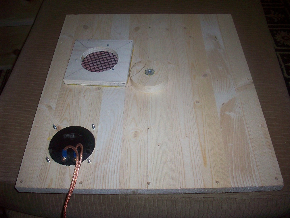

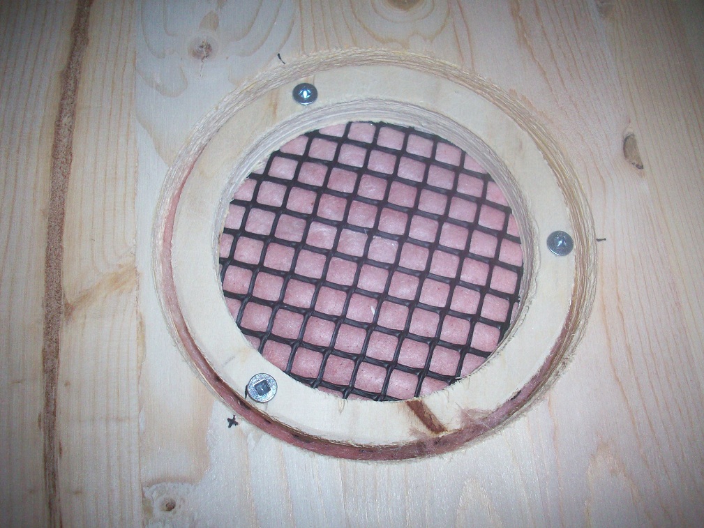

The Qtc cannot go lower than the driver's Qts for certain. The way I did it, I did not look to maximize the impedance curve's flatness, but stopped when I had the desired Qtc, 0.65-0.7 was my aim. I guess at some point, if you try to go too far and remove too much resistive material, you will start to see a bass-reflex behavior, that would be my guess.

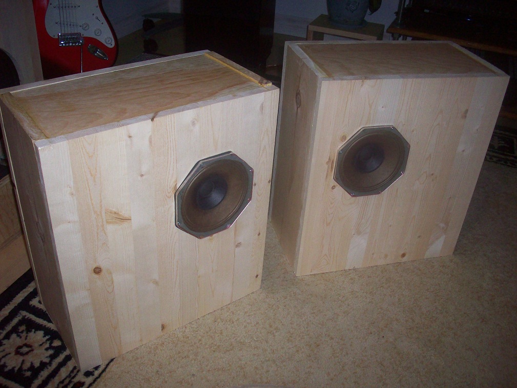

I placed the speakers better in my room and listened to some well-recorded/mastered stuff, Patricia Barber, and it sounded really good, even with no EQ (used to simulate BSC). Tried some dance music as well, David Guetta, and they did well enough; but I did hold back on the SPL to give them a chance. Looking forward to try other stuff I have on them!
